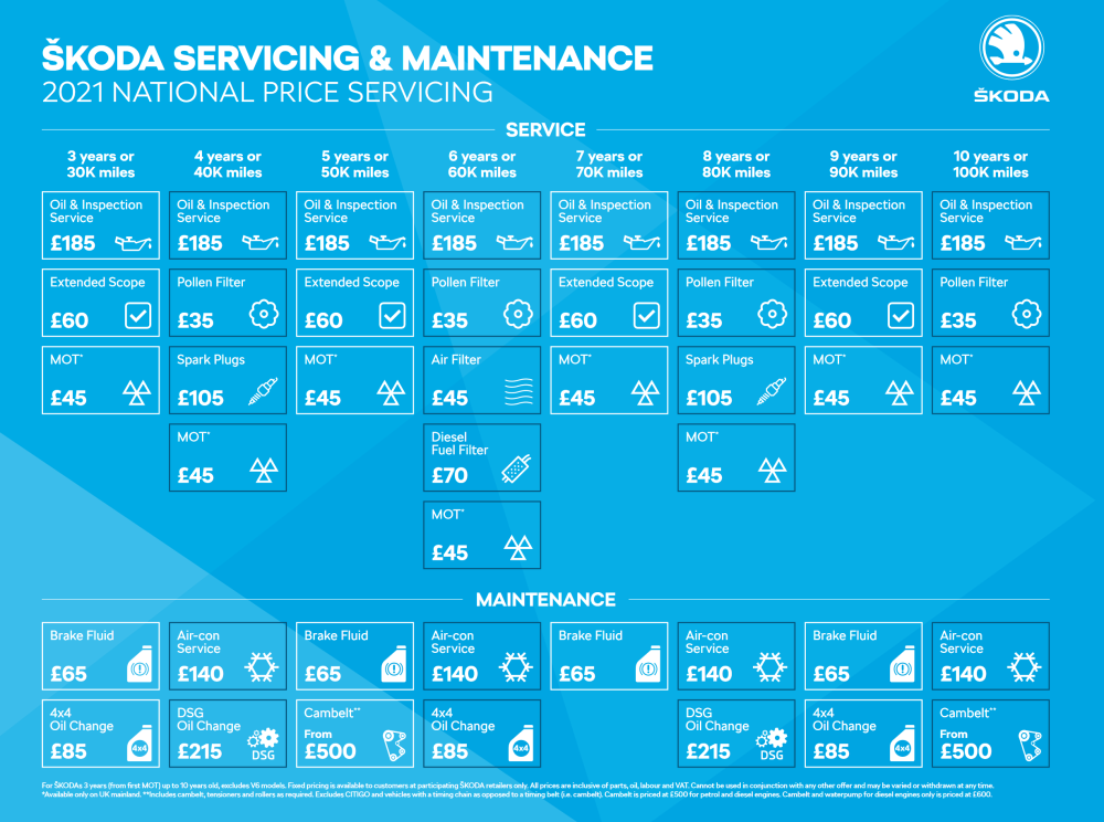

I know nowt about this issue, but given the age of your vehicle, I'd be inclined to give it a gearbox service (see chart at 40K miles) as a starting point, and while it's in for the service, get the fault codes checked out. Some DSGs (DQ381 for example) say they don't need a service until 80K, but I won't be leaving it that long on my car.
I'd also be inclined to go to a VAG independent rather than a main dealer, but that's a personal preference.
Great chart, thanks so much!
