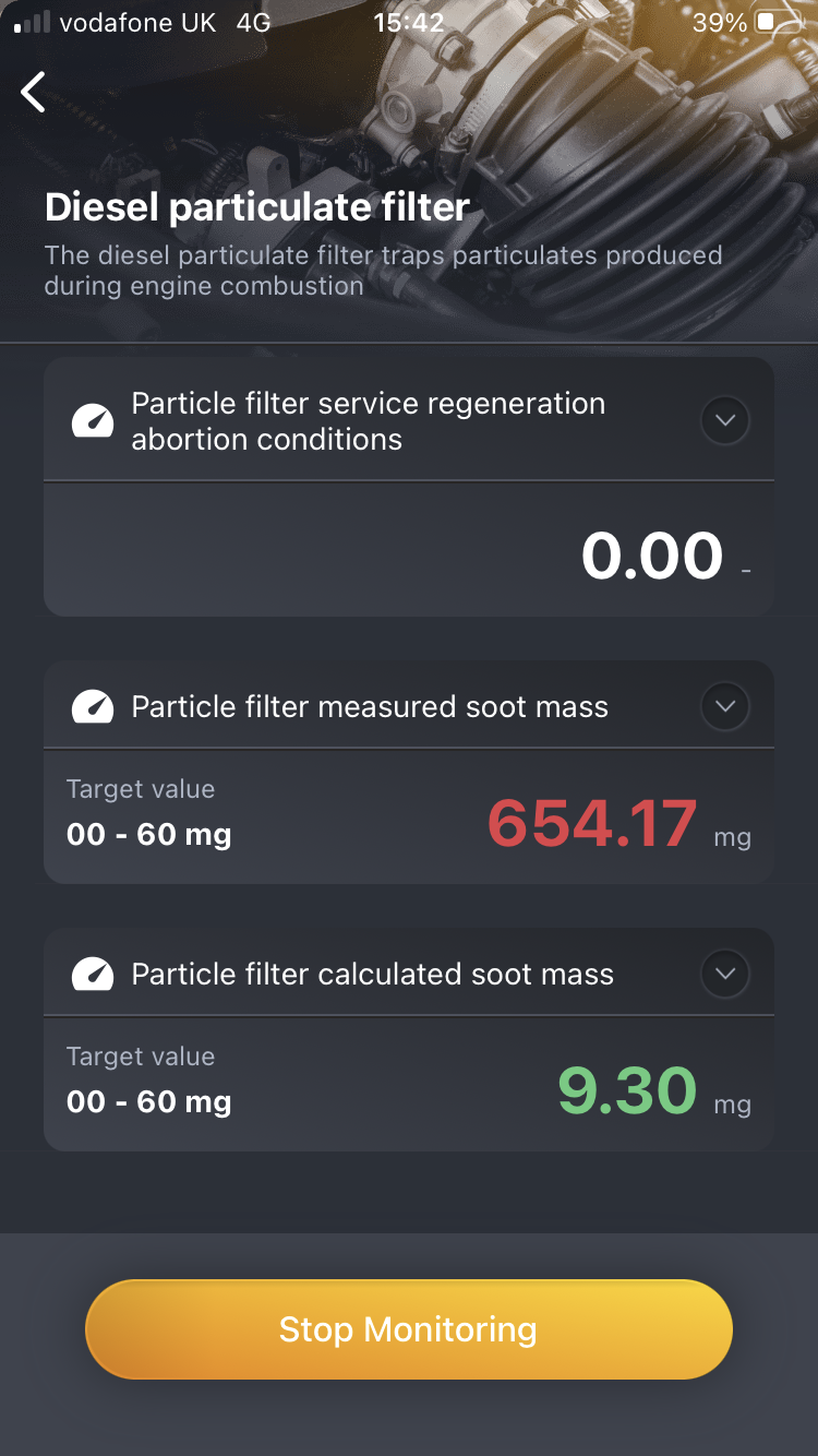

Out of curiosity, realising the 'Carly' OBD dongle i have would give me live data on the DPF i tried it out and saw a calculated soot value of around 10mg and a measured value of about 650mg. I checked again at the next regen, and the calculated changed from 20 something i think, down to about 5mg by the end of the regen. The measured had a similar drop rate and ended up at about 640mg.
Why is that measured soot value so implausibly high? I think the regen frequency i have is ok, and the car has no issues, but i'd like to have an answer! Is this an issue with the exhaust pressure sensors?

Take the measurement of the Soot with engine off, if the value is high like it is now, then sensor will most likely be goosed.

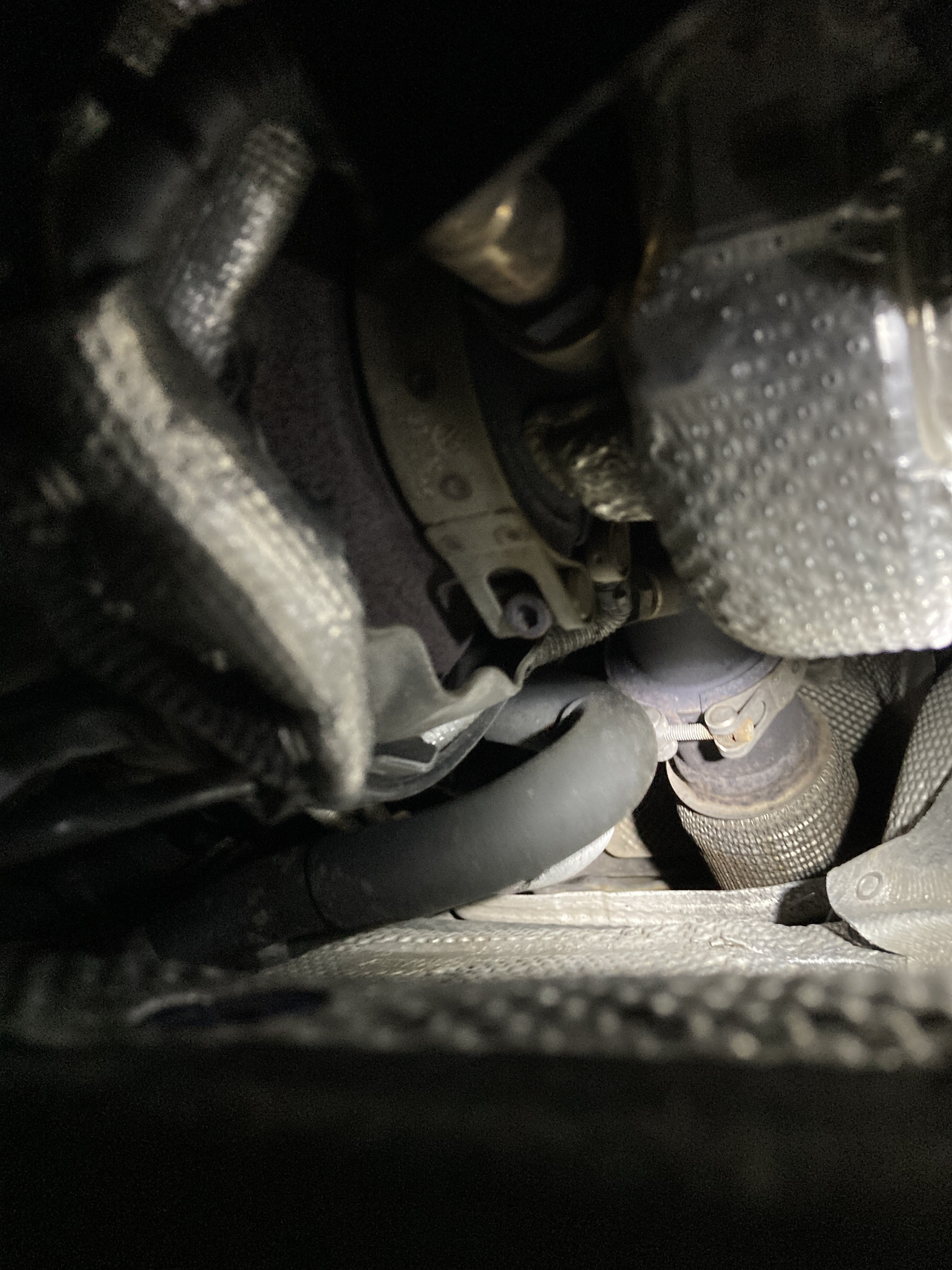

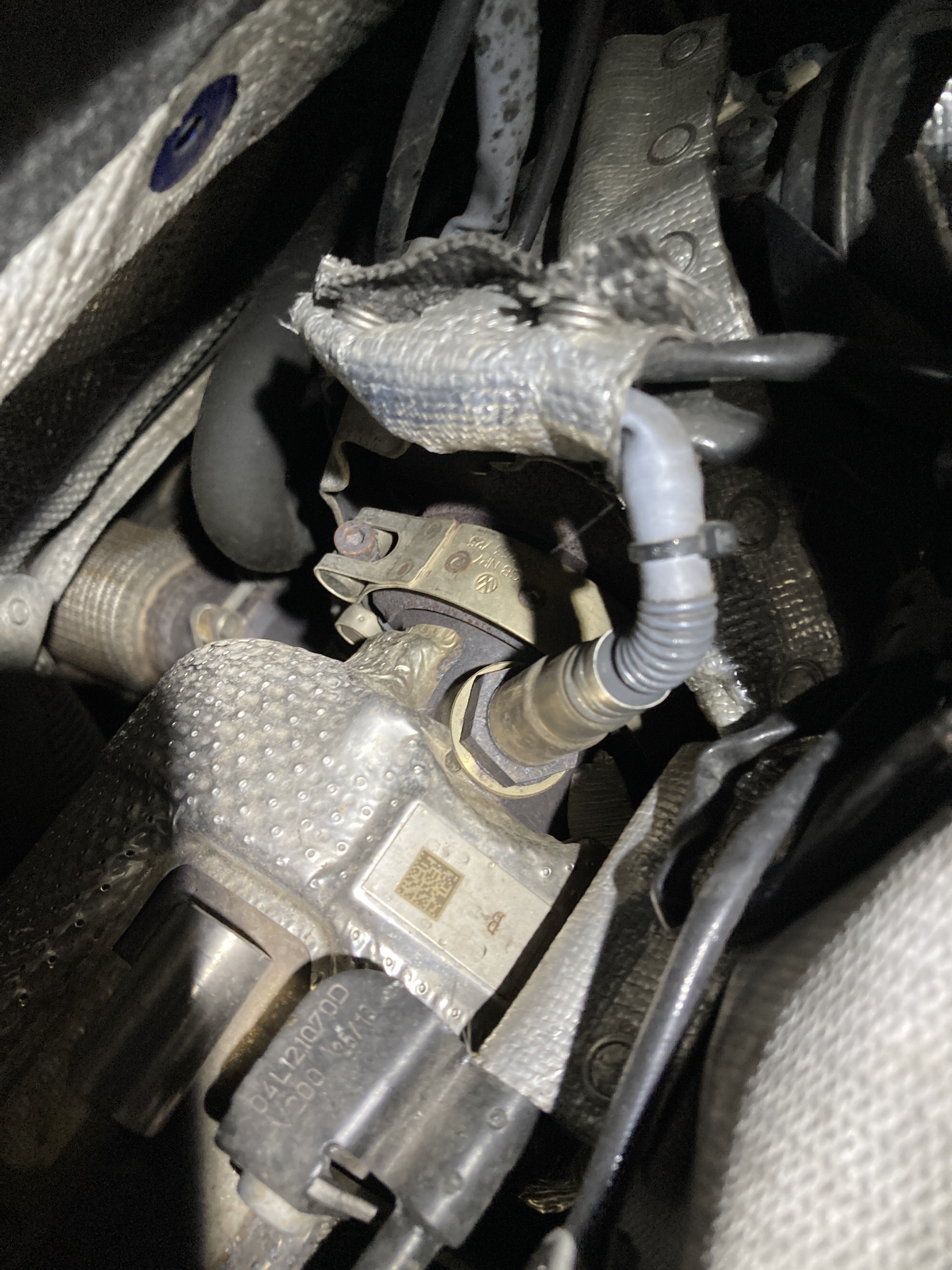

Thank you. Checked today and it’s still the same high value with the engine off. So I may try a sensor. I think I see it once I unwrapped the heat shield, it has two hose barbs with only one hose attached. I presume that’s the way it’s mean to be as there are no other hoses.

Unless you have a wiring fault, that amount it reads is off the charts, so this would likely be what I would change.
Older generation sensor's used a pipe on both ports of the sensor, either side of the DPF
New gen sensor's only measure pressure one side and it vents the other to atmosphere, so perfectly normal
I am sure the new gen's don't need adopting, mine does not have to be done.
When you get new sensor, measure soot with engine off then with engine on.
You then should probably do a DPF regen, checking the soot afterwards to verify that all the functions are correct with the car.

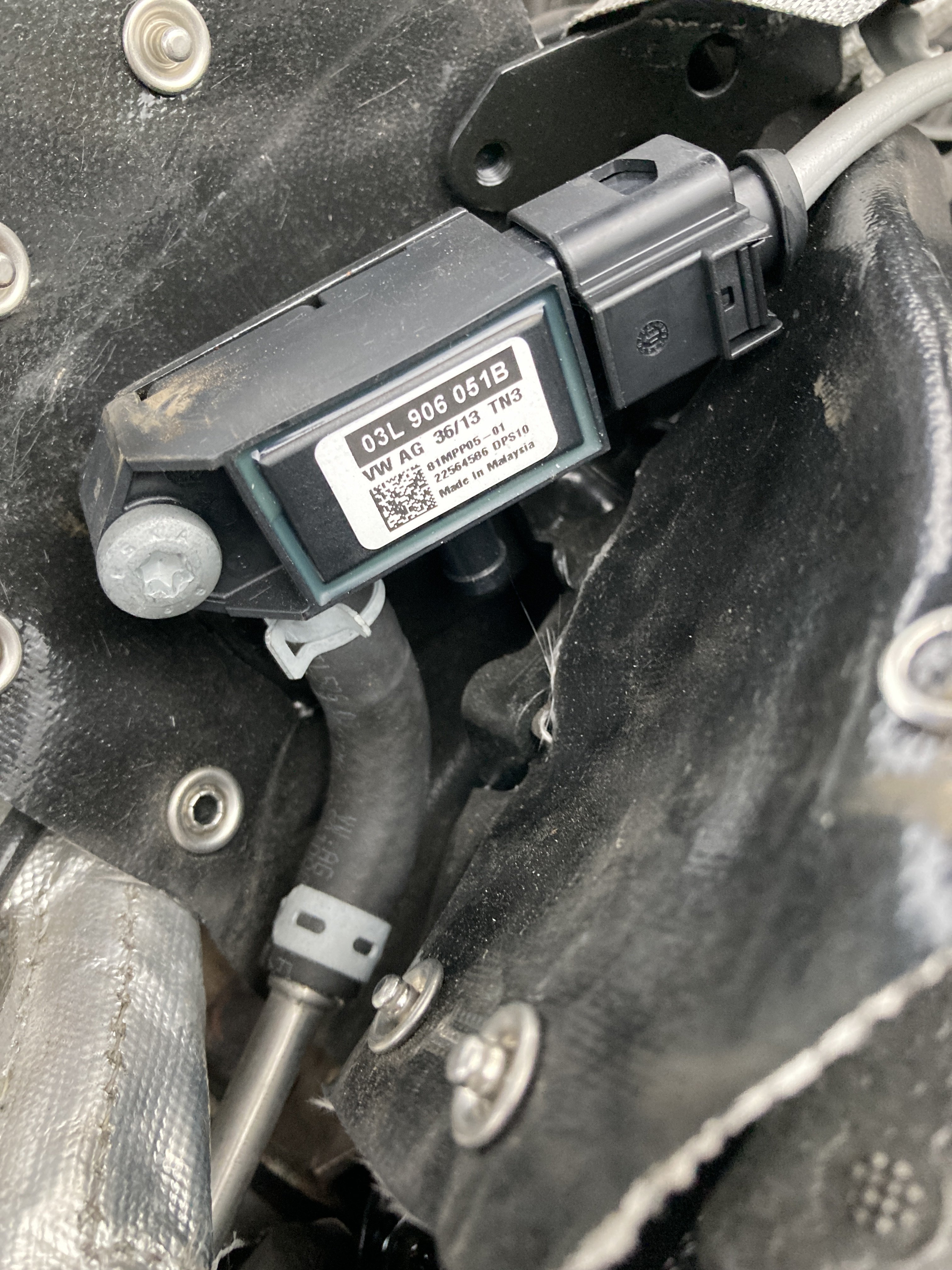

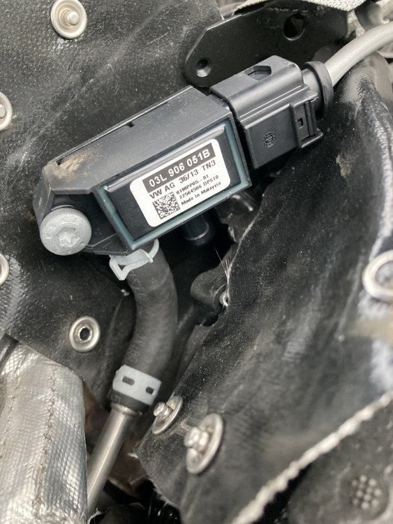

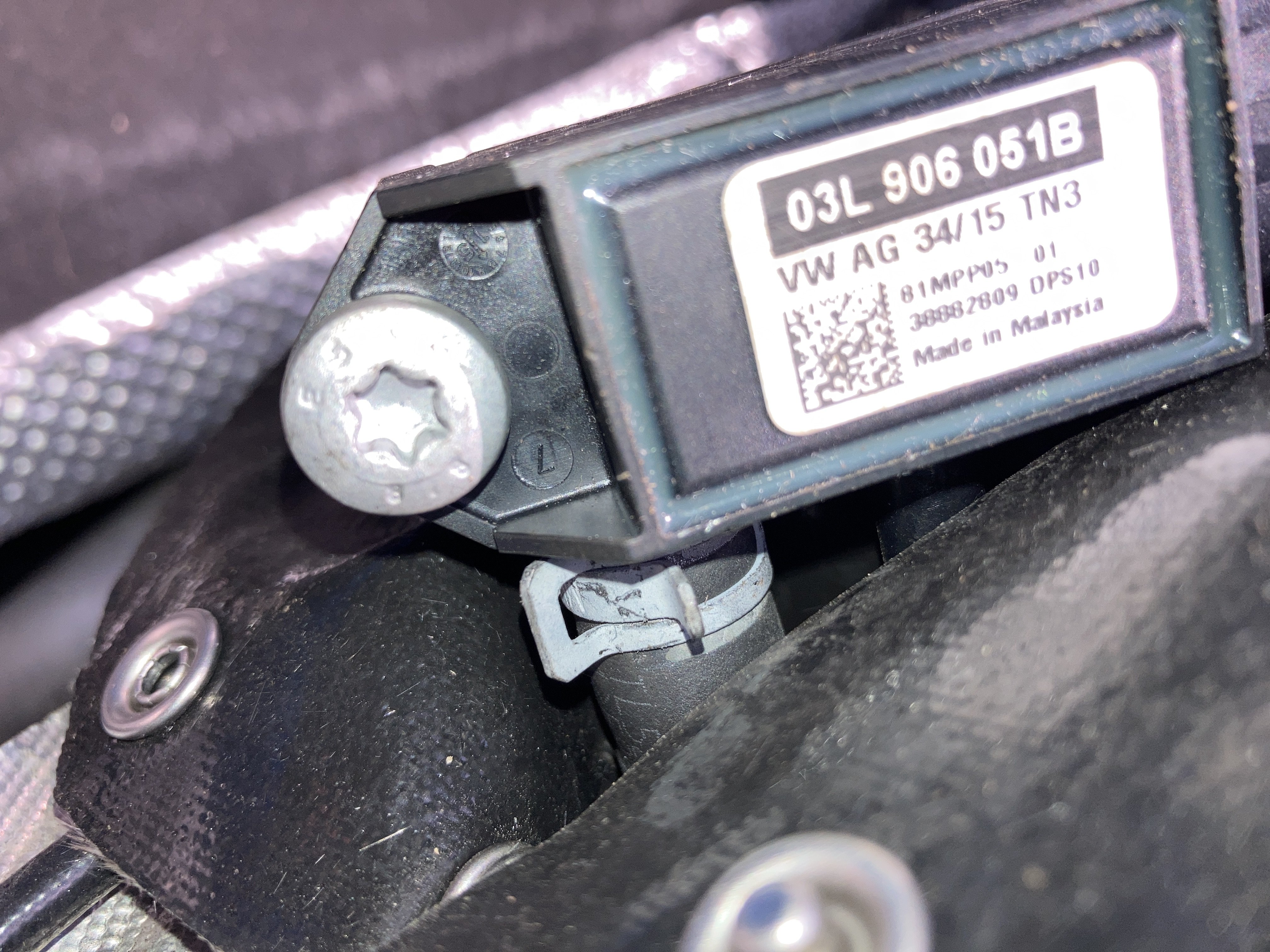

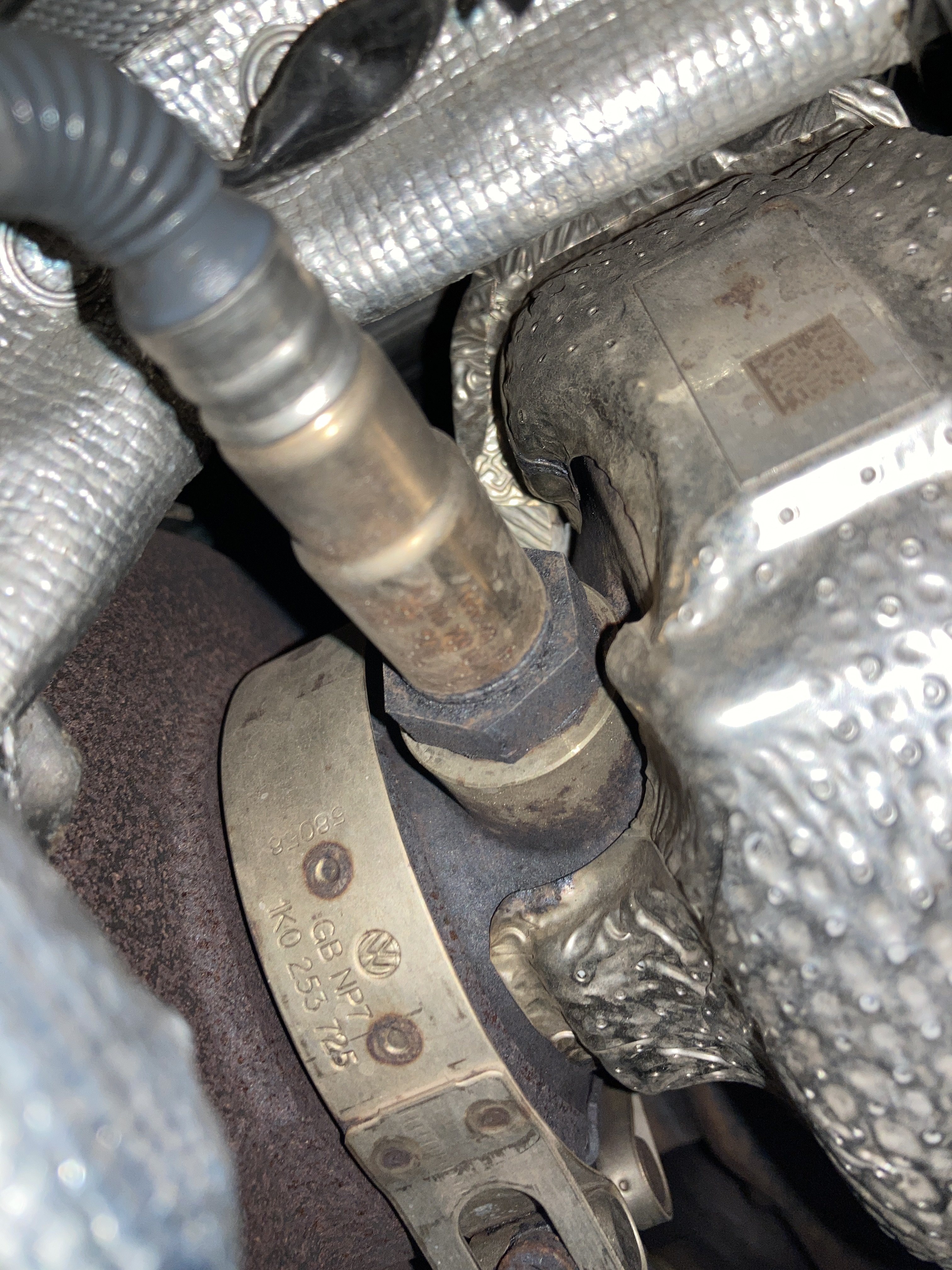

Do you have a part number for the new sensor (picture is ideal) so date on part can be seen.
Good idea. Please see picture. This is the same older B revision part that’s superseded? I did notice the newer revisions mentioned on the listing so expected a newer part but this seems to be dated August 2015.
Perhaps I should try my local Skoda dealer for a revised part?
Yes the part picture is week 34 of 2015 as you read, not sure if you want to pay main dealer prices for that part.  I did track down a part on eBay that is actually listed correctly https://www.ebay.co.uk/itm/275531758223
