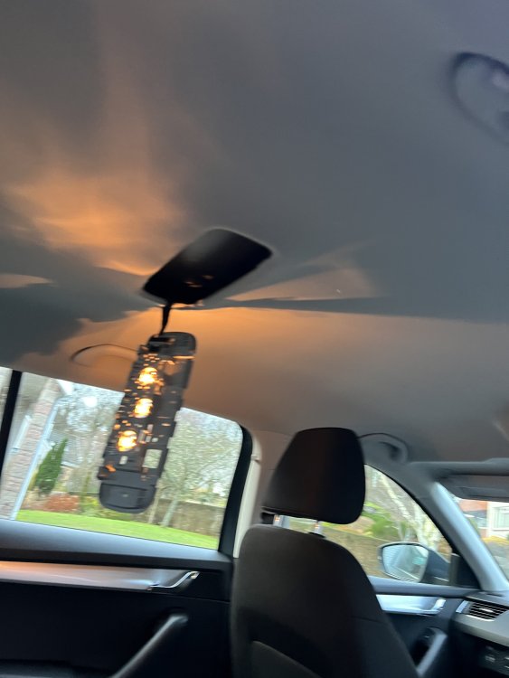

There is a buzzing noise coming from rear interior lights. I have removed the light holder and disconnected them. The buzzing is still on. There is a small black box that connects to the light cluster. it would seem as if this is the cause of the buzzing. this only starts when the engine is running. Has anybody encountered a similar issue ?

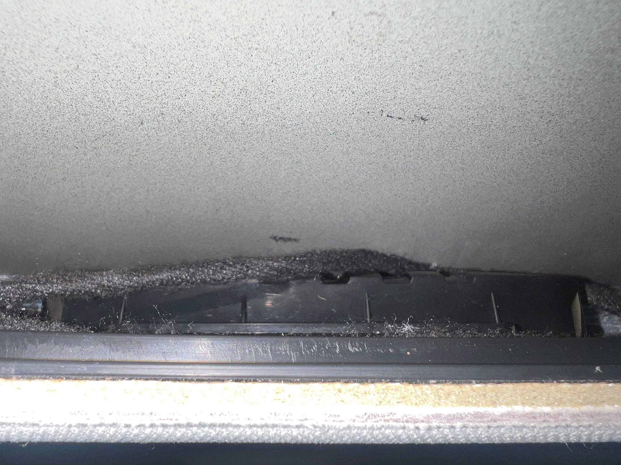

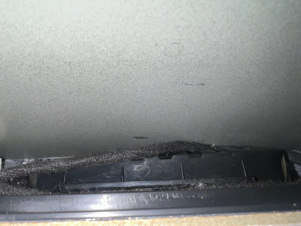

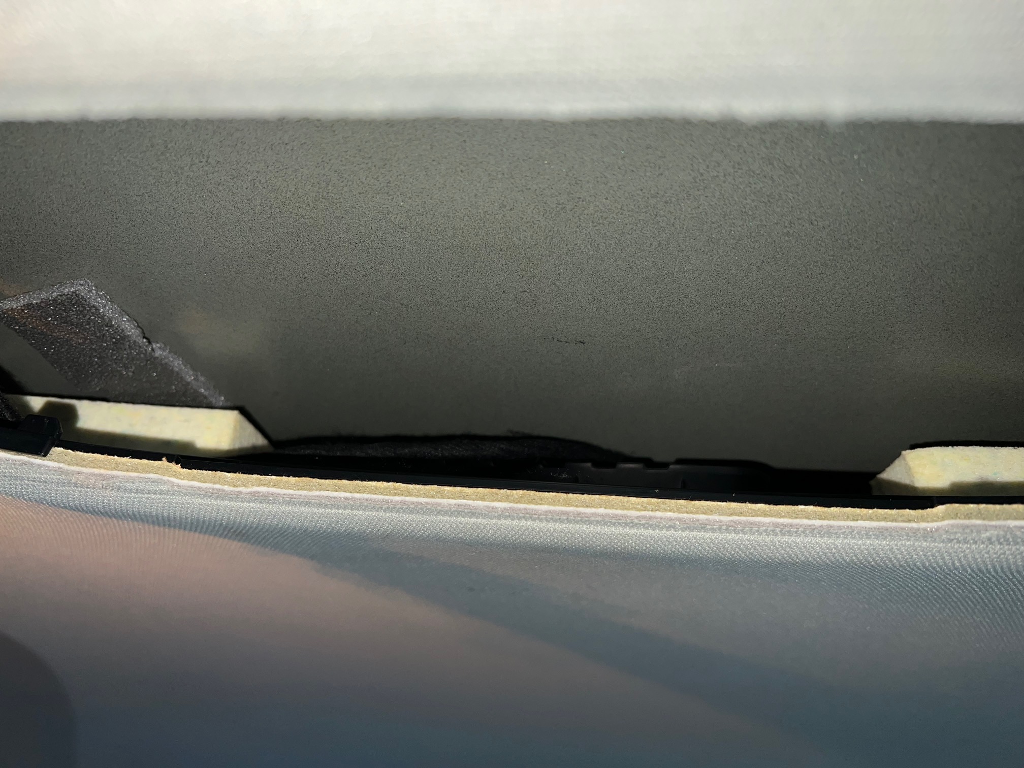

Thanks, the pictures show the box (Although Not the easiest place to get a decent picture)
It is about 2 inches in from the Void where the Lights sit. (towards the front of the car)
It definitely appears to come from this box

The one thing I was thinking it could be was an ultrasonic sensor for break-ins.
Have you got a zoomed out view of where it sits in the car, trying to get a mental picture of where it is roughly (words only help so much!)
The box is sitting within the void here
