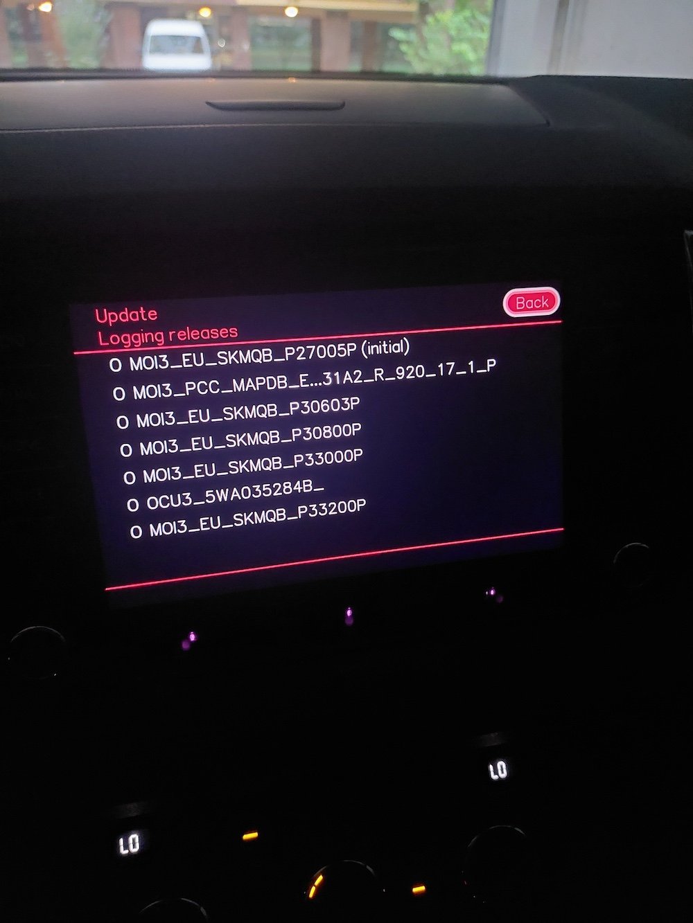

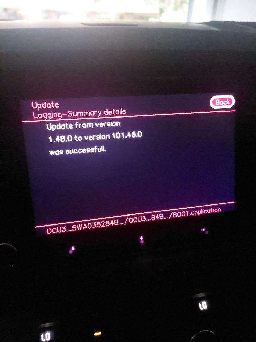

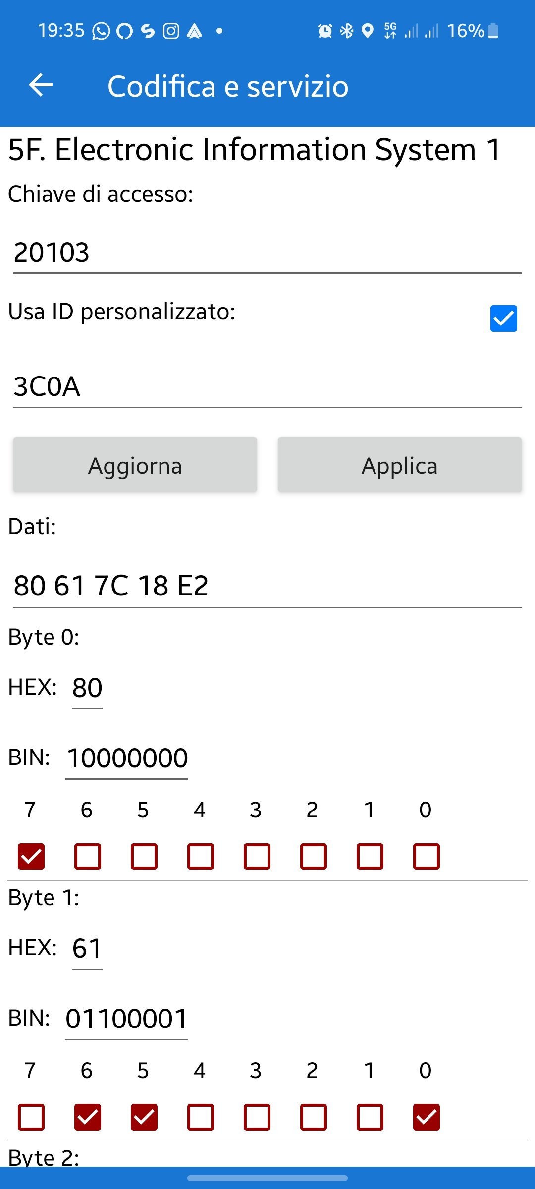

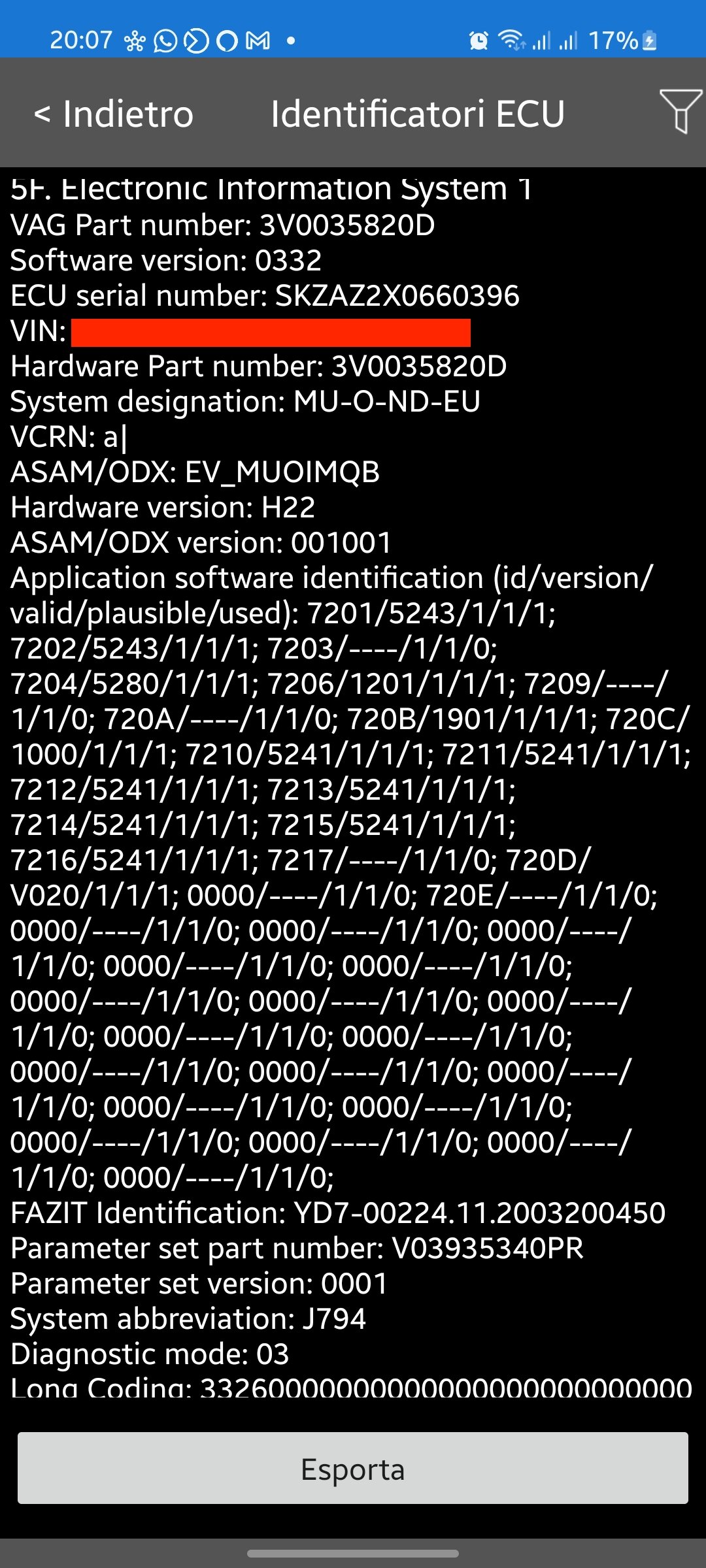

  3. Following this guide, which is the same one found on the Russian site, I can confirm that with the 3C0A code it actually displayed a hex code, which should be my VCRN, after giving me an error ("impossible to apply the command"). The Russian site also says that after setting 3C0A, the VCRN also appears in the ECU Information section of module 5F, but I always see only "a|." The only thing I didn't do was set ATST to "16," but I don't know if that changes anything; from what I understand, it's something you need to do if the first attempt fails. If everything is correct and that's my code, I'd say I can replace it in full.bin and flash. Question: Can I see the OCU version with Carscanner? Because following a problem with the SOS control unit, they updated my OCU in September 2024, but what I see from the engineering menu is only that OCU3_5WA035284B_ was installed but it doesn't say the version. If I click on the various items for that update it says successfully update from 1.48.0 to 101.48.0 or 101.49.0 but I don't think that's the version I'm reading here.
  4. Did you mean this Mega? Unfortunately, I don't have Odis or OBD11, but I do have Carscanner with ELM. I can try resetting the infotainment system (I'm not sure if I can do it from the screen or by removing the fuse, which should be #12). On drive.ru, I found some topics about a patch that seems to fix the issue and that would work with Carscanner without Odis. I'm sharing it for anyone who might need it, since an ELM dongle is available for a small price: https://www.drive2.ru/b/695890531019930453/ This is exactly my case: FEC/SWaP present but with wrond VCRN number. Basically, you just need to find your VCRN number, replace it with a hex code, and flash it with USB. I'm not sure whether to risk trying the patch; maybe it's better to reset the radio first. Because, again, it's strange. I have the navigation system as standard, and if I look at the FEC/SWaP codes, I see the navigation code, but if I open the details, it shows up as VCRN 1234, which is obviously wrong. And if I go to the dealership, they'll definitely charge me for a realignment.
