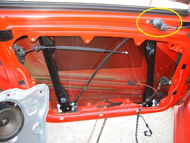

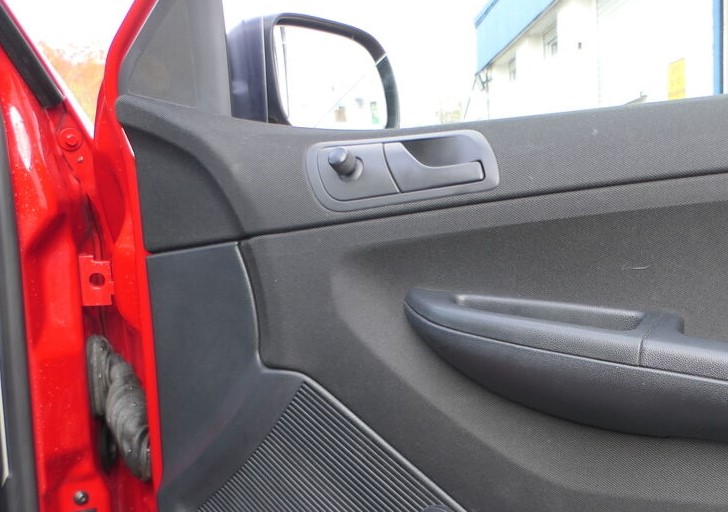

trouble i have is i need to see a picture of where the manual adjusters are in a car with them im not sure if they are on those small covers in the corner of windows or on doors.
Edited by TMB
Ahhhh that helps cheers tmb I reckon I can adapt those to fit then hmmmm project lol 😂
