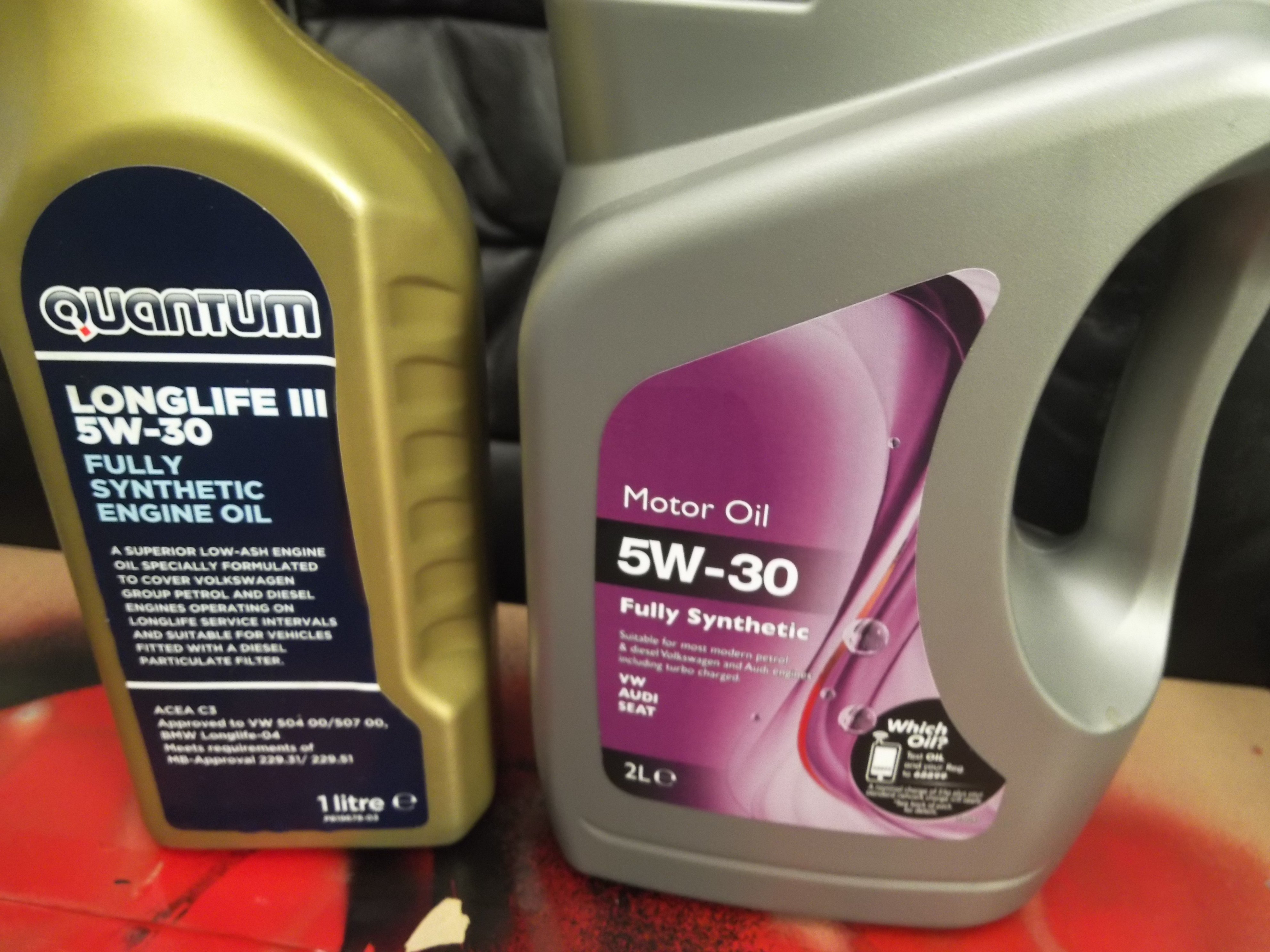

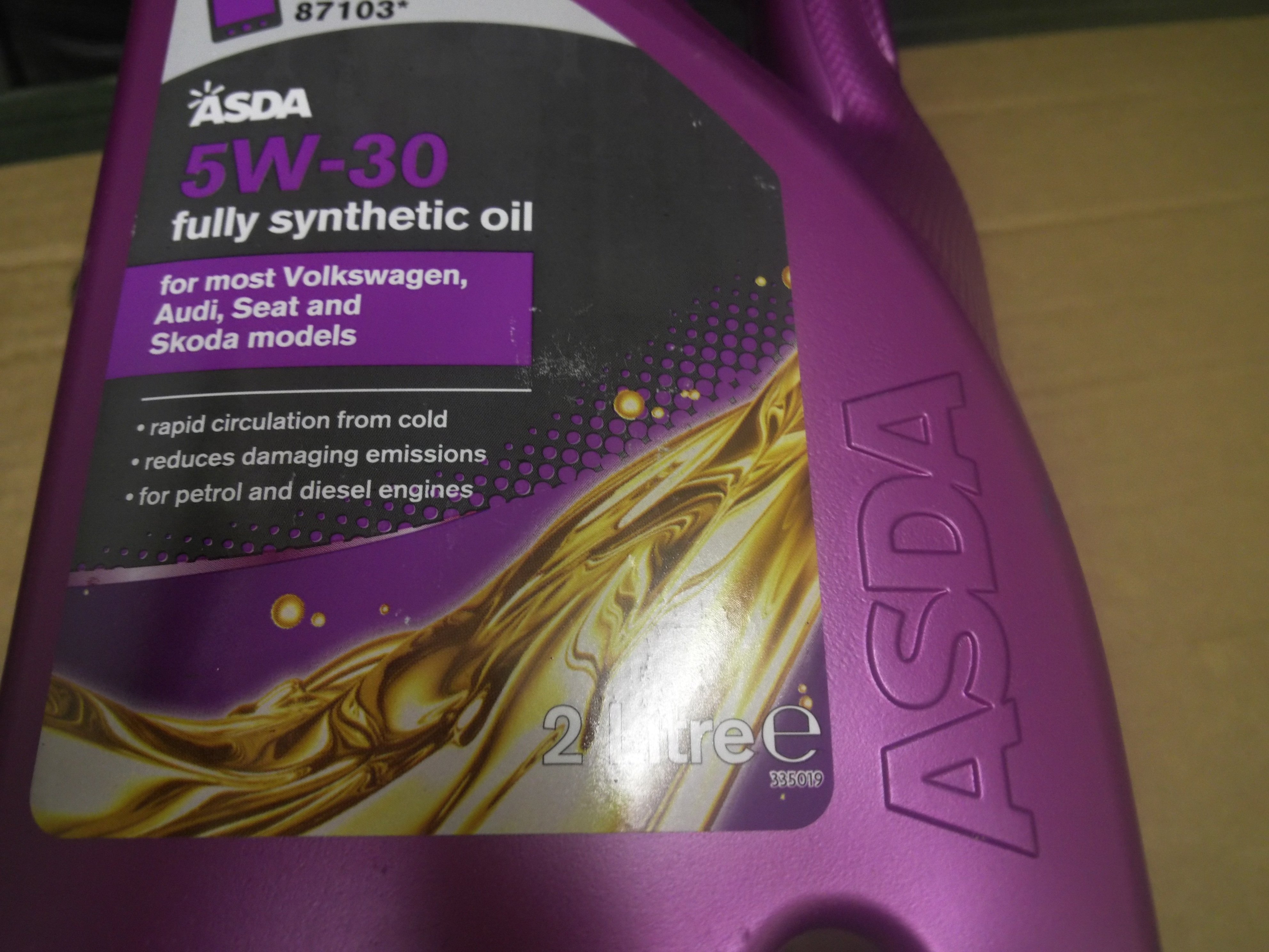

It will keep going fine with the Engine Oil sold in a ASDA Container or a TESCO, 5w 30 FS III to VW 504 00 / 507 00.  Even if not on any VW Approved list.
Proper oil from a proper oil producer. There will be those that say not the correct SAP. Not low. not Mid.
They use the oil in the Price Wars to stuff up the competition and some hours, or days it is 'much cheapness' in some stores.
The car will run fine on the Derv / Diesel sold at super market filling stations.
 Millions of vehicles in the UK use the stuff, the stuff that comes out of the same depots as special standard diesel with additive packages that are for special people with special needs.
