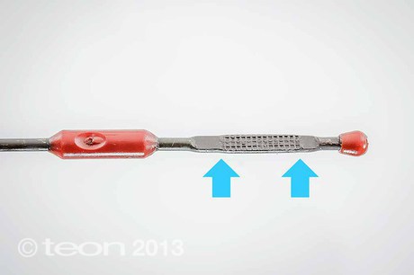

Best get that new oil and filter and get the oil hot / warm in the engine and do the oil and filter change.
Was the oil that is in at a high enough place on the dipstick when checked cold or when hot?
Where is it now on the dipstick?

Thanks for the diagram above, the oil level was half way up the crossed area of the dipstick if that makes sense.
