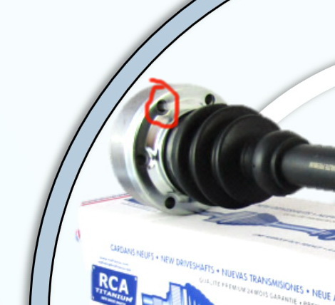

i am making a trip the next weekend to a remote area of this country, where i will be taking very step hills with 5 people onboar and full of equipment, and the roof area too, so, lot of weight, AND there is a missing screw in the CV joint, in the part that goes to the differential (probably i am not calling it by its proper name)
and i would like to know what are the measures before going under the car to remove it in order to save some time and to see if i can purchase it in advance.
check this picture

First of the item 13s here I think Kharl, M8x48 long. drive shaft; for manual gearbox Fabia (FAB) 2002 year Skoda EUROPA 407020 (7zap.com)
According to this listing they are quite a high strength rating, 12.9 Bolt, propshaft flange N91108201 TOPRAN, FEBI BILSTEIN, MAPCO OE part number in original quality (onlinecarparts.co.uk). Not sure if genuine ones are same.
XZN head fitting.

yes, mine ismanual transmission
Thank you a lot Pete, tomorrow i will go to a store around here that seems to have some nice quality crews
