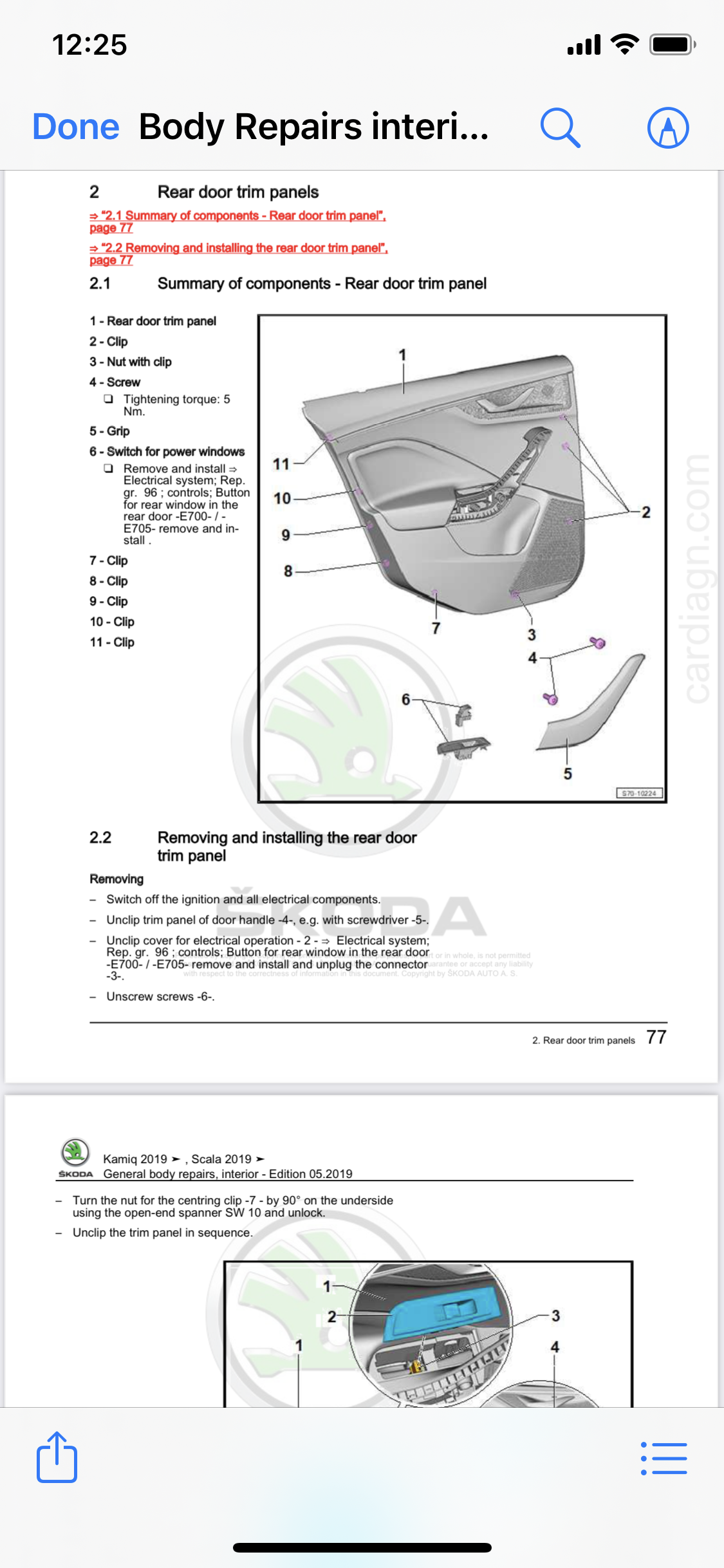

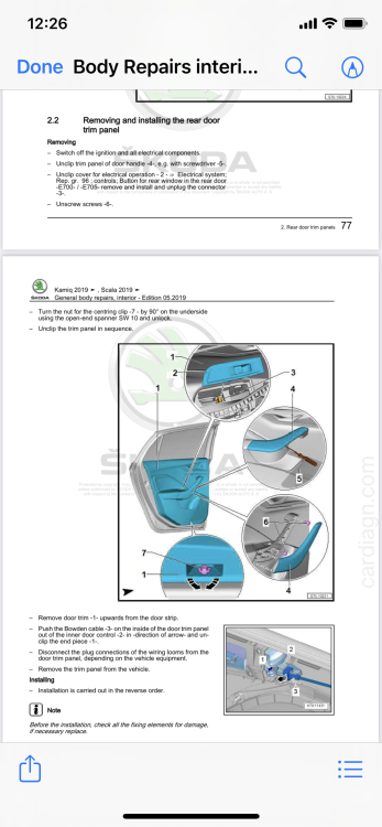

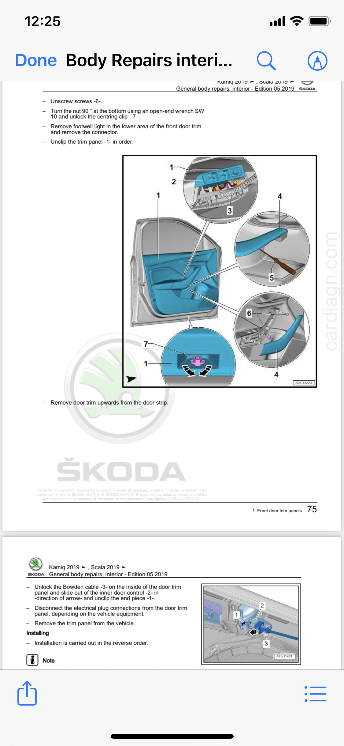

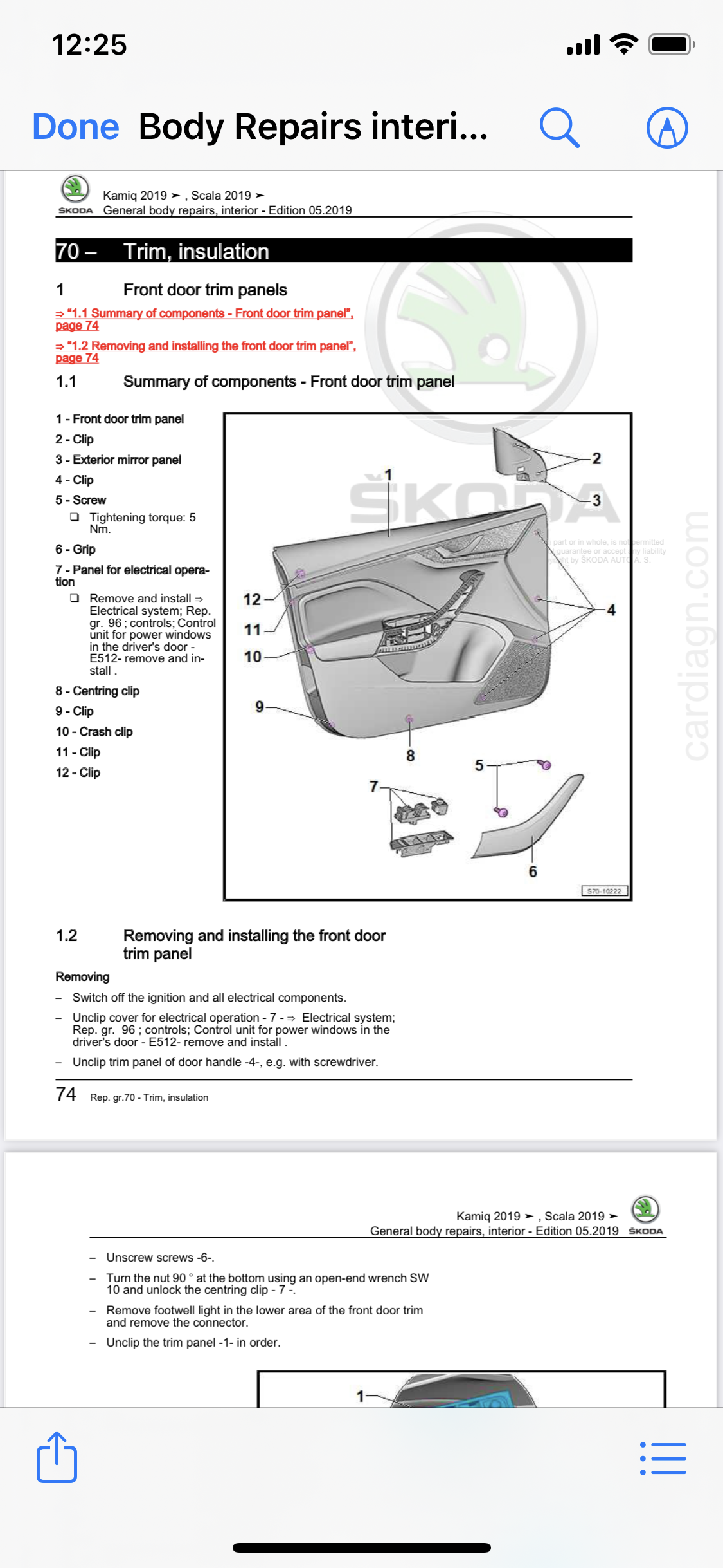

Thinking of changing the speakers in my kamiq 2022.
The question is we're the bolts are located in the doors, have searched and can't find anything about the kamiq door panel removal.
Or is it similar to some other Skoda model.
Thanks
Hi there!
Maybe it helps
Thanks alot ,that solves everything.
