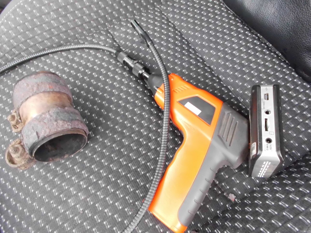

A Borescope is good to check where the sun don't shine.
That can be where a Dealership employees might not be that bright.
Yes, good idea.
