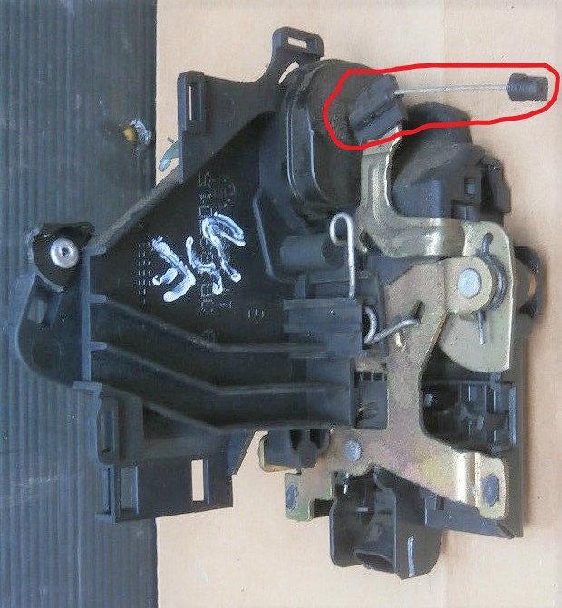

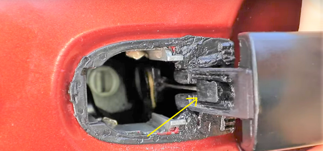

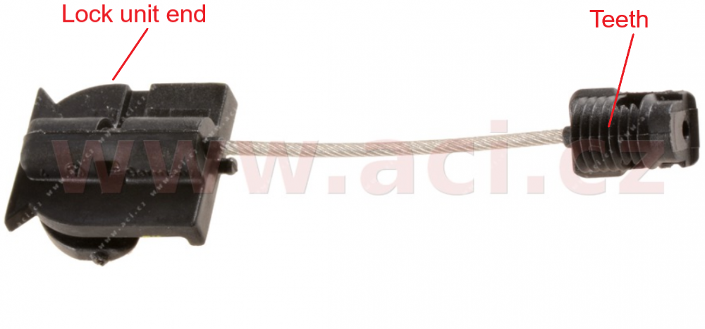

Obviously don't know what part he's saying he's lost & whether that is the cause, but aside from that, if he's had the little door lock bowden cable off, it's possible that he's overtensioned it when refitting. They have to be set with no tension on them with the handle at rest or the lock will malfunction. There are teeth on the door handle end of the cable to adjust it. If you pull the door handle open you will see the end of the cable which engages in corresponding teeth in the handle.

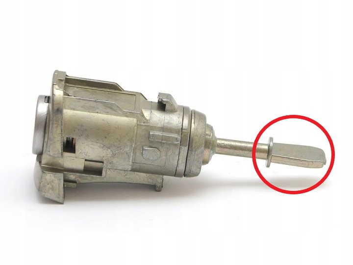

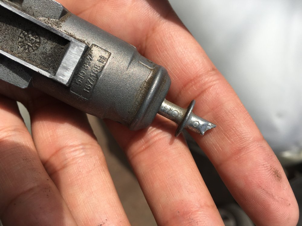

Another possibility is that the 'paddle' on the lock barrel is snapped off. Like this....
