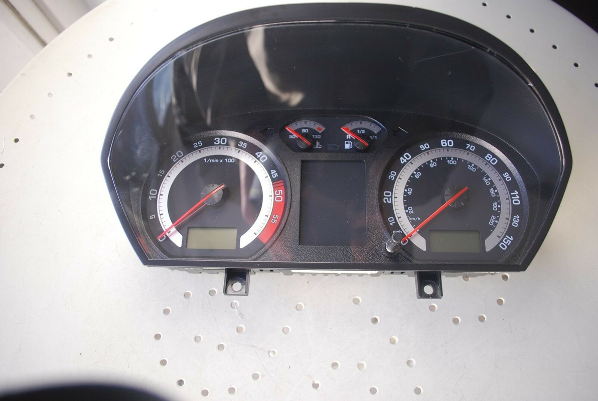

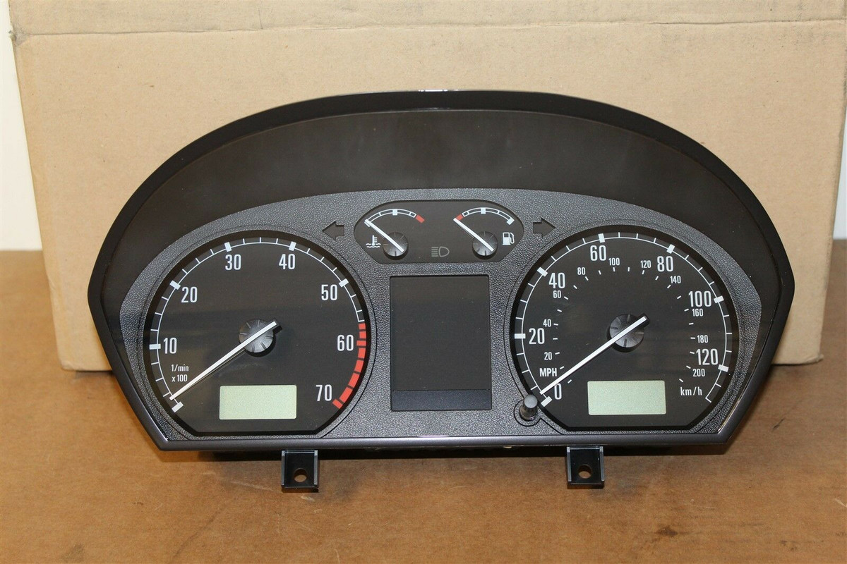

On 12/02/2023 at 01:13, TMB said:
The immobiliser is part of the cluster circuitry and you can't just swap a used cluster in without coding otherwise the car won't start. Also, the cluster from a diesel Fabia has different rev counter & speedo scales.
vRS...
/cdn-cgi/mirage/16db53f124b65c54dd52cc7f4ccd8d038314a2a90bef88bfacd2e4ed0d883388/1280/https://i.postimg.cc/XJH75bKz/s-l1600.jpg
Petrol...
/cdn-cgi/mirage/16db53f124b65c54dd52cc7f4ccd8d038314a2a90bef88bfacd2e4ed0d883388/1280/https://i.postimg.cc/C585p2Dr/45566.jpg
