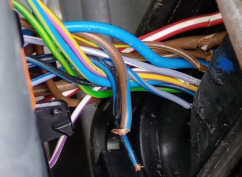

I've got 3 broken wires in my driver's door loom hinge.  In terms of symptoms the driver's door speaker doesn't work and the windows will not go up and down from the interior buttons (both front windows from the buttons in both doors) but the windows will go up and down from the key lock control.
I realise that it'll be fiddly work but would a small heat shrink (solder seal style) do the job.

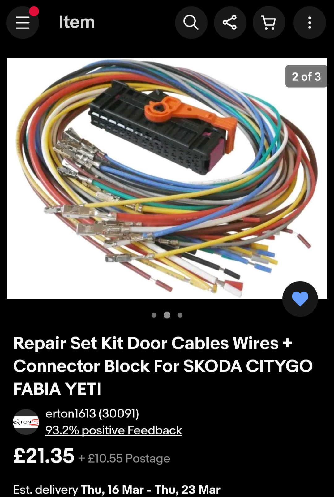

By far the best solution is to buy a Delpho kit which gives you the connector assembly with wire tails on each part to be joined into the existing loom.

Ok thanks.
Something like this? I get what you mean about adding extra length to allow for better flex. I'll see about getting the door trim off. Plenty of guides online. Screenshot_20230213-164959-508.thumb.png.ead42dac035ed77d56c1f355f2154391.png
I would say so with the bonus of it is much cheaper than the Febi ones that I have seen.

You have to allow slack but I would just splice in three pieces of wire rather than buying a kit. It doesn't matter the colour as long as it is of a similar thickness.

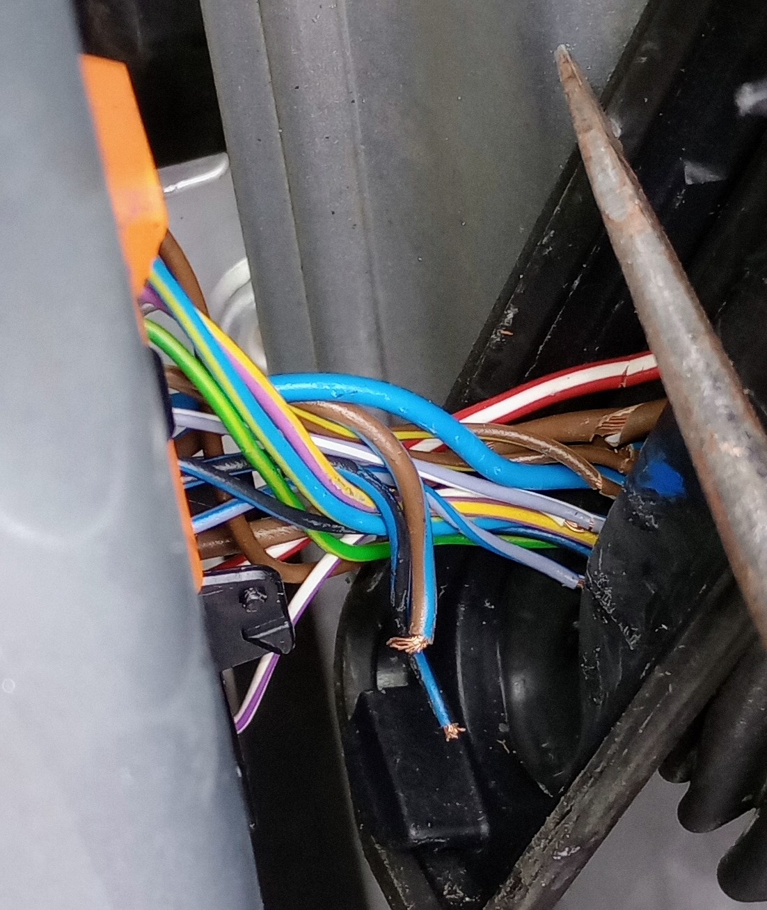

More than the 3 wires to sort out there.
And are the breaks not within 2cms of the connector? - I dont know not having disassembled one.
If that is the case then you do not have the room to splice in a section of wire without one of the brittle soldered joints being in the zone of maximum flexion.
Also there simply isn't room to make multiple butt joints in that knotted bundle. I can count 9 damaged or broken wires with my poor vision.

Yes I know what you mean. 3 definitely broken wires and many with cracked insulation. And as you say, there's not much wire that I can get access to on the right hand side as the wires go into the door. Wishful thinking on my part for a quick and simple fix.

Well I feel like I've let everyone down by not following advice, botching it a bit, and probably only doing a temporary fix, but I just don't have the time, space or equipment at the moment. I struggled with the solder seals given the tight space so I ended up using some very small connection blocks. The brown and blue wire was the door speaker and the slightly thinner blue and black wire fix now means that I can use the windows from the interior switches. I couldn't join the thin white and violent wire.  The loom is obviously a very bad design but it also doesn't help that the wires are all twisted around each other within the hinge and don't take the shortest path from A to B.  I will never fully open my door again. Thanks for the help.
That is deliberate, a correctly designed door loop will have the wires taking the longest possible path following a lazy curve, then the flexion from the door opening and closing is spread over a greater length reducing the strain.

It's a crap design because it uses relatively rigid cables with very thin brittle insulation.
