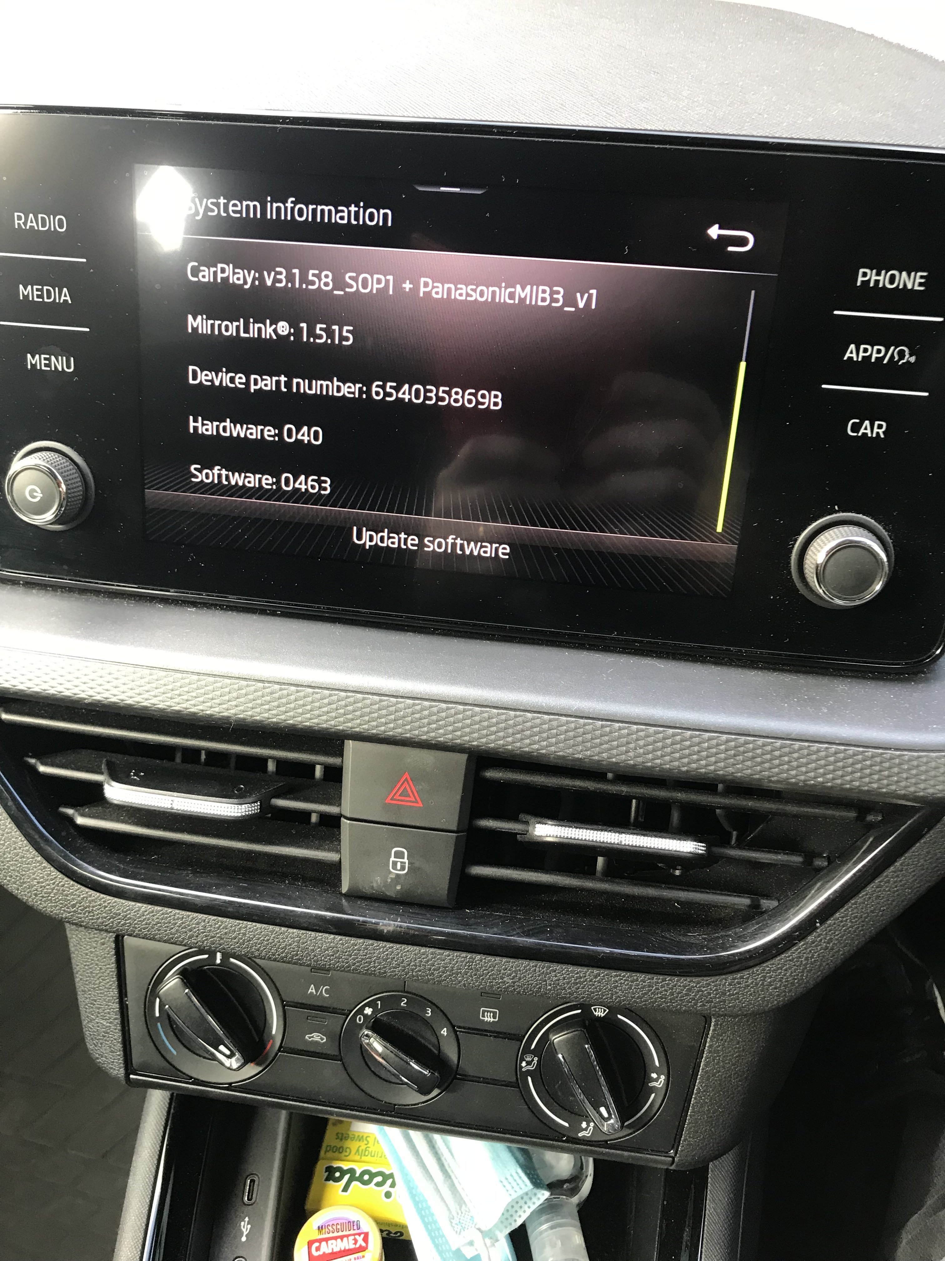

So this is what I get on the screen….how do I find out if this is updatable? And where do I find the update? Thanks everyone 85E28F94-B6FB-4026-A73F-1E00C51D5B10.thumb.jpeg.d0978fa01320e4eaf0db96613b57fa14.jpeg

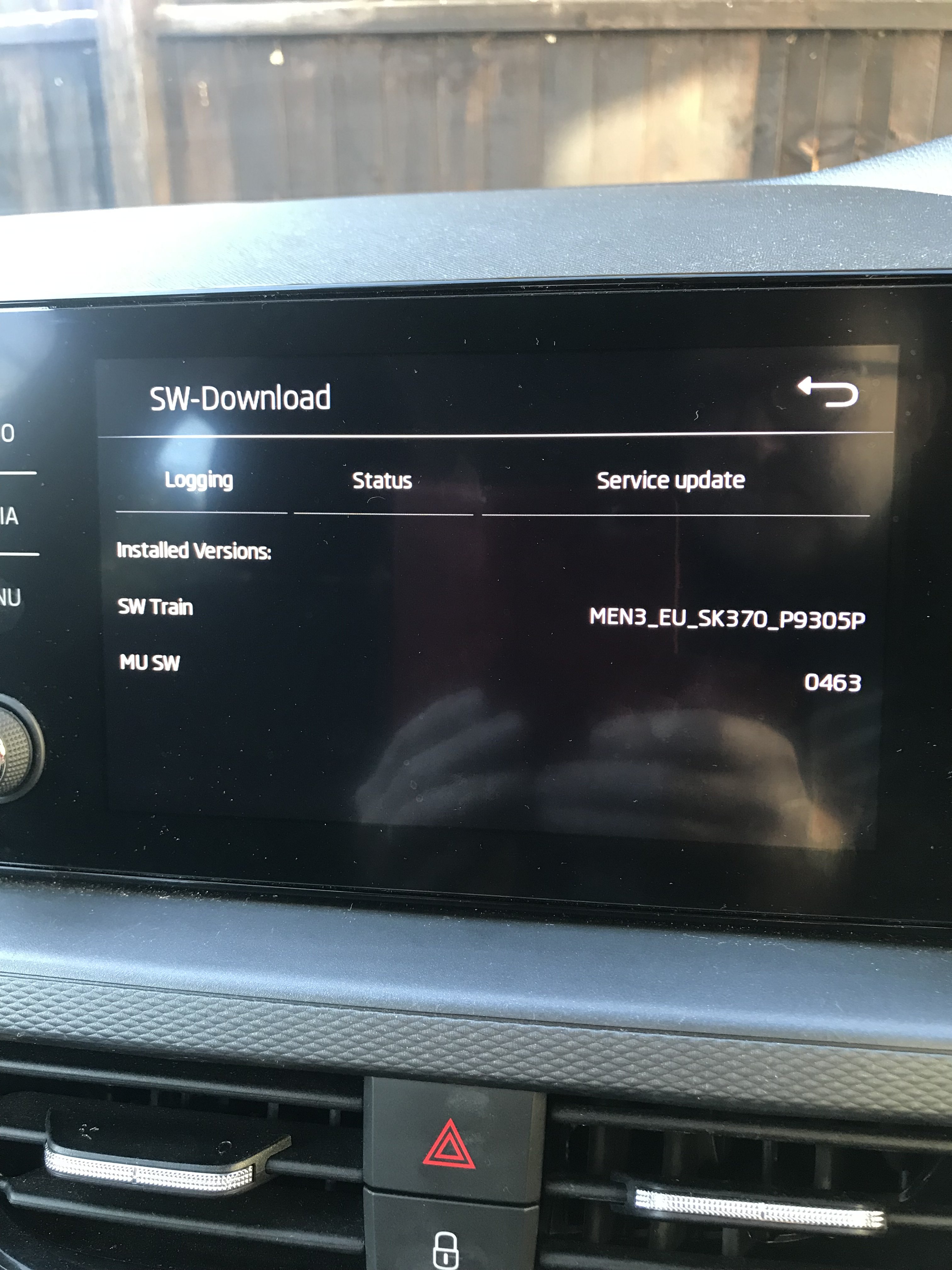

Try holding down your Menu button for 10 seconds and look around in the engineering menu.
I get this, same software number? If that’s what mu sw is?5BAD2C64-44E2-4957-BD50-91CF024DA5A8.thumb.jpeg.291d4bd8b8c95a09a7dde271f5857e9f.jpeg
I have MEN3_EU_SK370_P0113P, which is MU SW 0469
and loads of others that might update higher than what you have
So that one you quote is definitely an update but they may be later ones?
How can we tell? Is there any more data I can get off the system?

Some of the firmware updates have a list which states which software trains it updates (supported)
Sadly the MEN3_EU_SK370 series do the oppostite, they state only blocked trains, so it makes it hard to know if the update will apply or not.
I can only send you a file and you try it.
As for your problem, not sure that this will update your OCU/SOS fault, as this update I believe is not baked into this like MOI3_EU_SKMQB.
