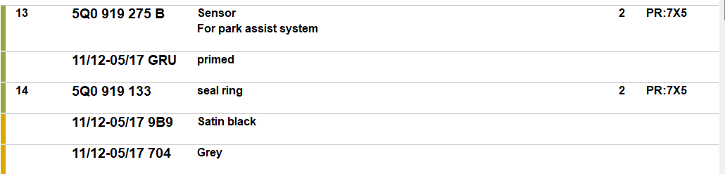

Regards to the question about colour codes, here you can see a basic idea of the choices
Here are some parts snippets, and you can buy some things without any colour preparation
1. 5Q0 919 275 B
So this is the sensor as it comes from the factory
2. 5Q0 919 275 B  GRU
This is the sensor with primer only ready to paint
3. 5Q0 919 133
A seal ring without any specified colour (no longer available)
4. 5Q0 919 133  9B9
A seal ring in Satin Black
5. 5Q0 919 133  704
A seal ring in Grey colour
