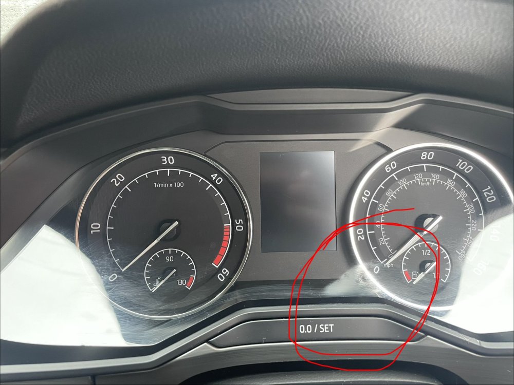

Gear selector switch - To fix intermittent "Return to workshop" error
www.aliexpress.com/item/1005009808126126.html

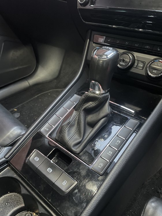

DSG lever top chrome - Original had chips in the chrome
https://www.aliexpress.com/item/1005008748111292.html

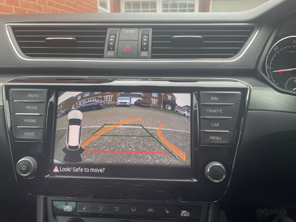

Reversing camera - Not something I particularly needed but for the price and ease of install felt like a nice addition
https://www.aliexpress.com/item/4000230897829.html

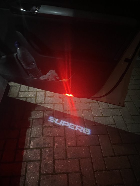

Superb puddle lights - Because why not!
https://www.aliexpress.com/item/1005009118825485.html

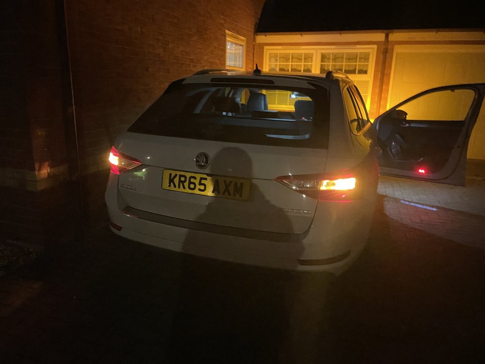

LED tailgate lights - It already had LED bulbs in the original holders but these are significantly brighter and really light up the whole boot area.
https://www.aliexpress.com/item/1005006419747360.html

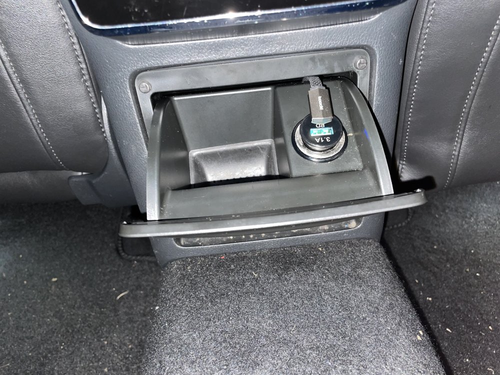

Route usb from rear charging port to armrest - as the front port is occupied with the wireless dongle, and to have the wire coming out in the armrest and allows the rear ashtray to be closed with it in situ - Based on the solution by @JR RS
Slimline 12v to USB adaptor - https://www.aliexpress.com/item/1005007463964127.html DO NOT USE THESE ONES - It interrupts the DAB, see lower down the thread for replacements.
90 degree USB C to Lightning flat cable - https://www.aliexpress.com/item/1005009346861759.html (I also bought the USB C version in anticipation of the next phone upgrade being USB C not lightning)

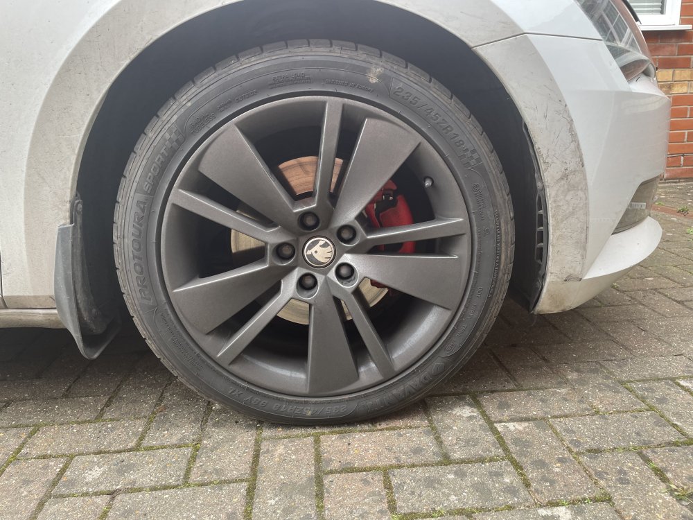

Mud flaps - UK countryside roads make for a very dirty car and I feel they save the sills from a lot of grime. These ones are significantly cheaper than OEM and not a perfect fit, but good enough.
https://www.aliexpress.com/item/1005001393849257.html

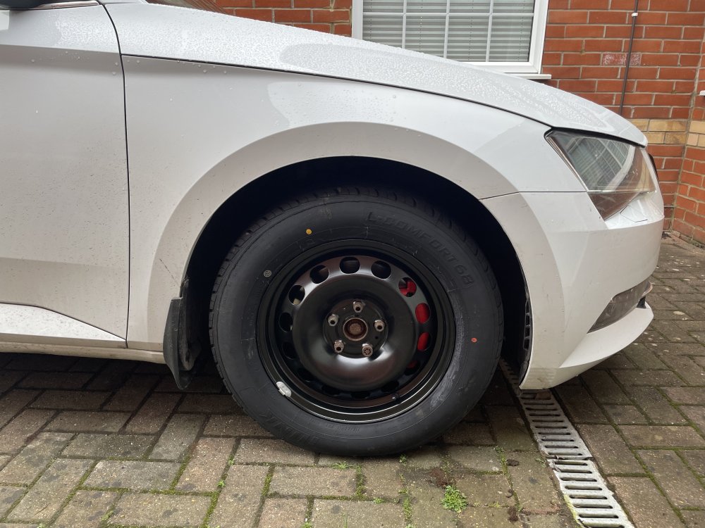

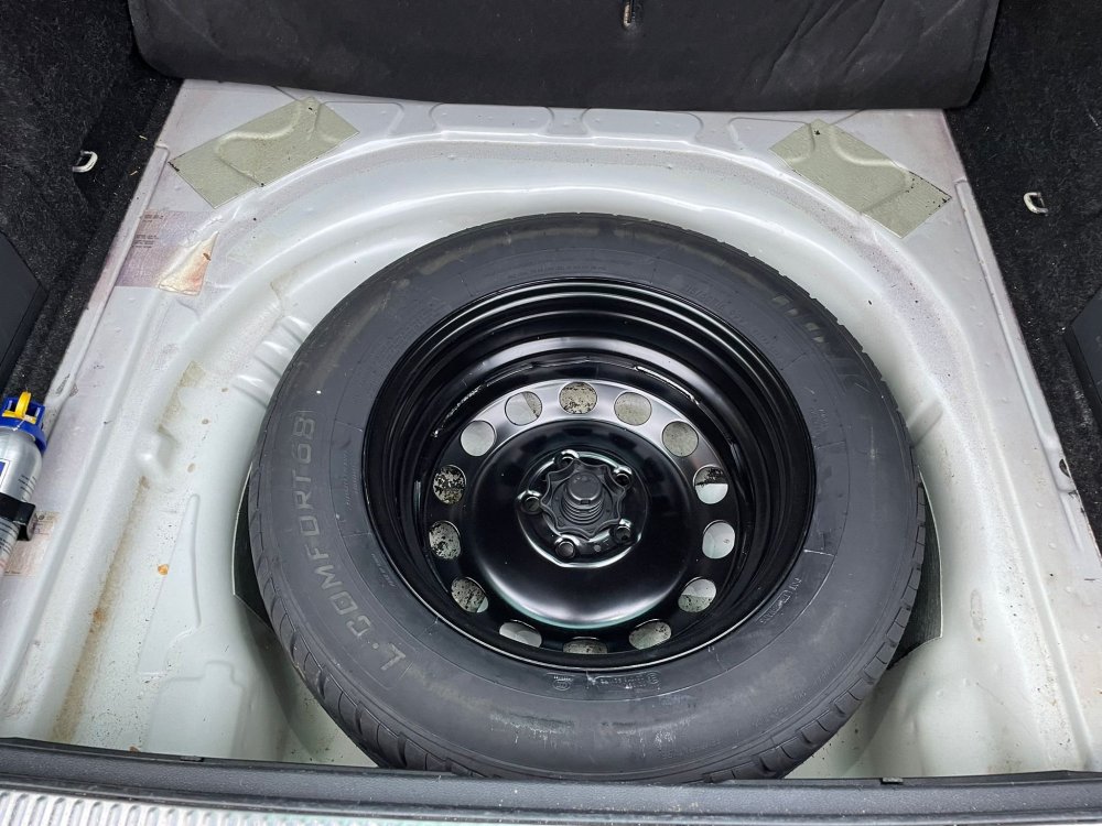

The car was originally supplied with a pump and goo repair kit. The goo was now out of date and I travel quite a bit for work so it makes me nervous not having a spare. I was keen on having a spare that was a close as possible to the rolling diameter of the existing wheels so it could be used without any speed or time restrictions, whilst also fitting under the boot floor. Following the advice shared from @Carlston on a few posts, I chose a 6Jx16 steel wheel with 215/60 R16 tyre which resulted in a less than 0.5% difference in rolling diameter. It fits in the wheel well really well, and fits perfectly on the car. Unfortunately the jack doesn't quite fit inside the wheel, but does fit in the side storage section.
Spare wheel - https://www.ebay.co.uk/itm/364188522719
Breaker bar and socket - https://www.ebay.co.uk/itm/403816977765
Jack - https://www.amazon.co.uk/dp/B08FTH8N1T
Spare wheel fixing screw - https://www.amazon.co.uk/dp/B0FP91RLPK

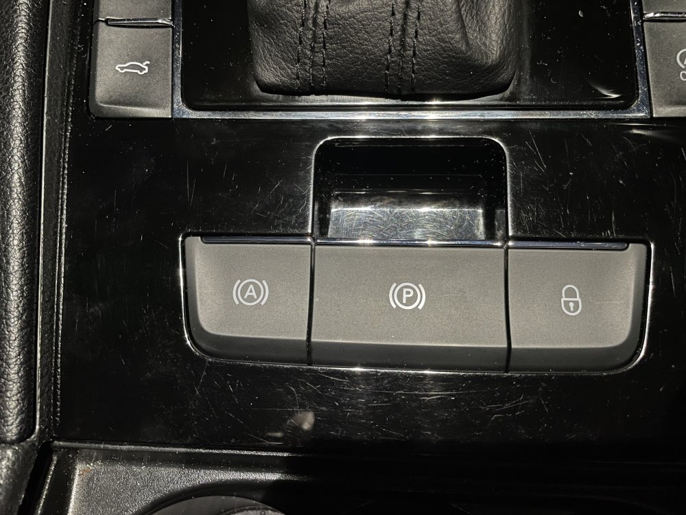

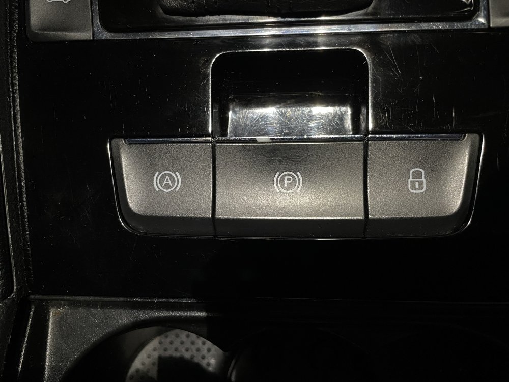

Parking brake switch - The OEM one the car came with had a chip in the chrome. 2nd hand spares were a similar price to AliExpress new, so I went with that. Perfect fit and a nice tidy up job.
https://www.aliexpress.com/item/1005006998838766.html

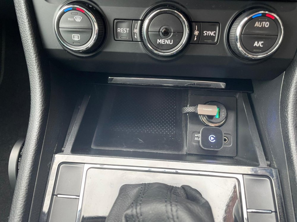

Wireless charging pad - Keen to try to add a magsafe wireless pad to the slot next to the USB port. Hopefully won't generate too much heat.
https://www.amazon.co.uk/dp/B0DL6ZBC3F Planning on supplying it using this https://www.amazon.co.uk/dp/B0FP5FBTB7 connected to the back of the front 12v socket via a fused line. Parts should be coming today and will look to install tomorrow/this weekend. Will add some photos once I do.

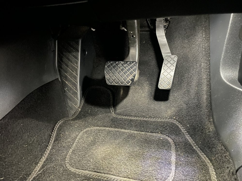

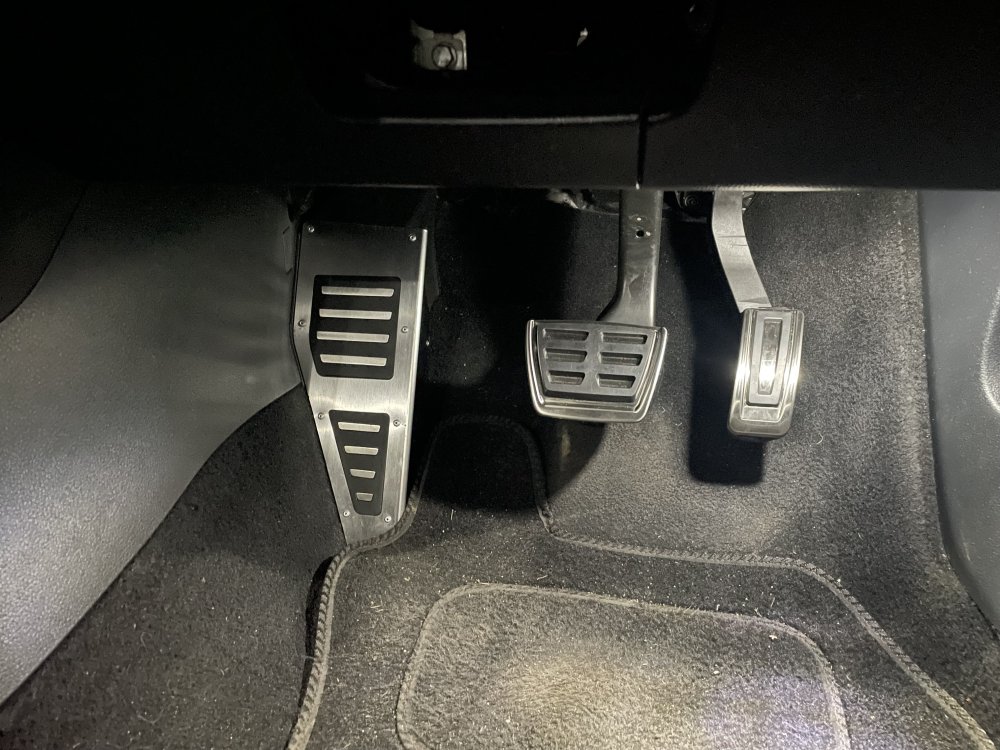

Stainless pedals and footrest - I had been searching AliExpress for some RHD pedals for some time. Thanks to @JR RS for pointing me in the right direction.
https://www.aliexpress.com/item/1005005130384423.html?spm=a2g0o.order_list.order_list_main.23.23f6180240IXhV

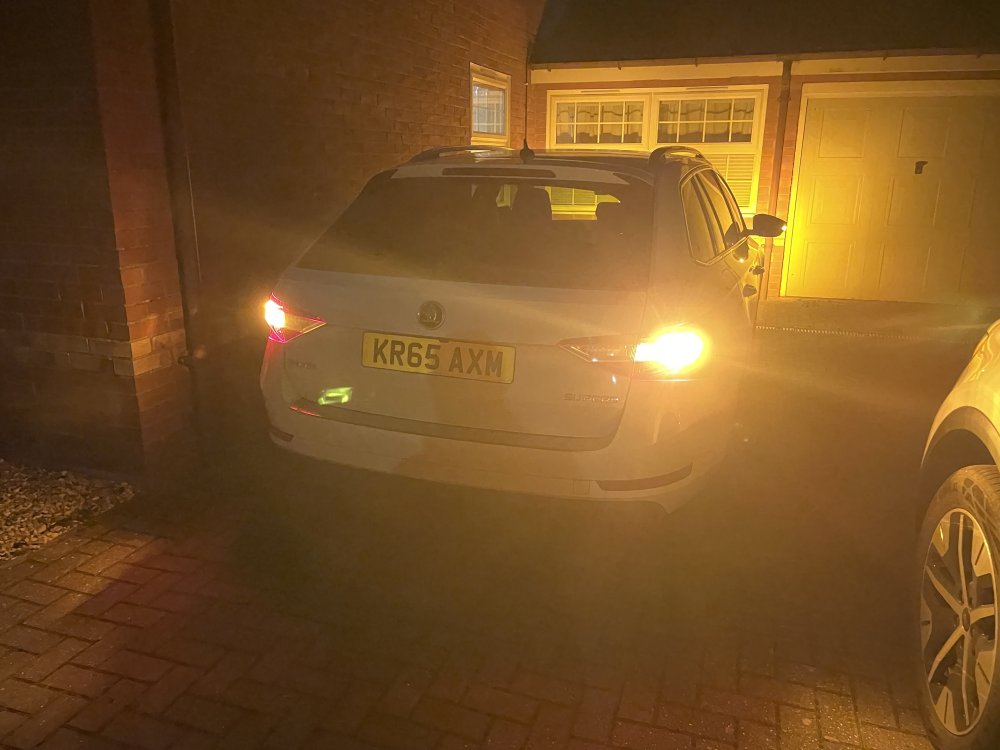

LED rear indicator bulbs
https://www.aliexpress.com/item/1005005102438682.html
LED reversing bulbs
https://www.aliexpress.com/item/1005006067983978.html

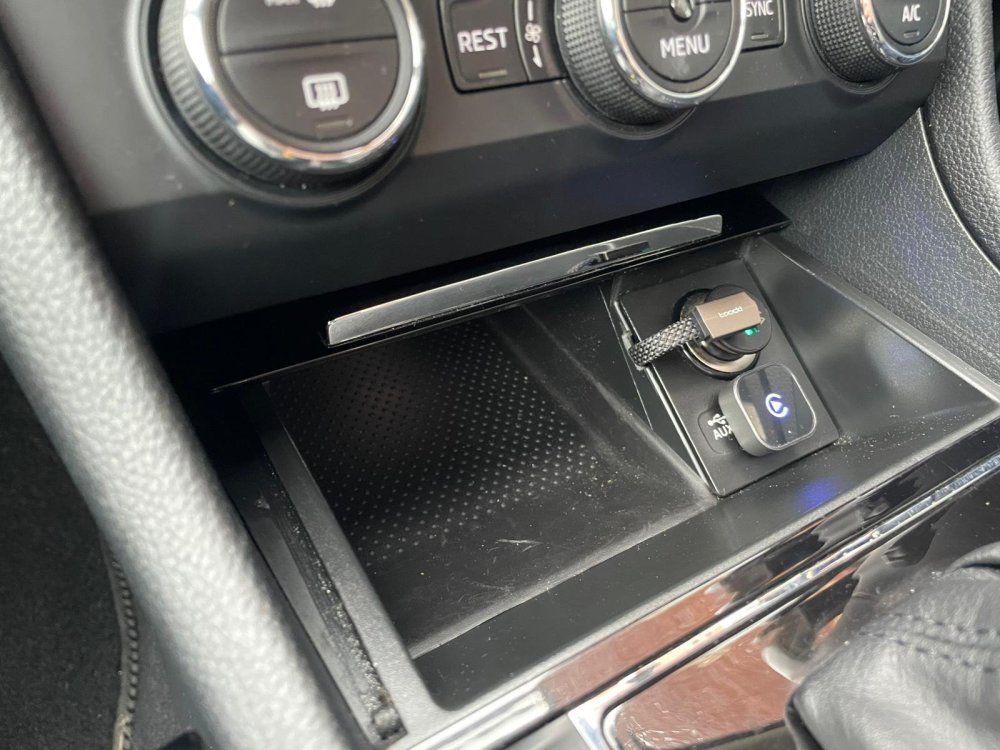

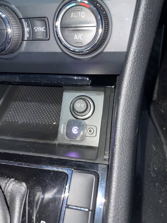

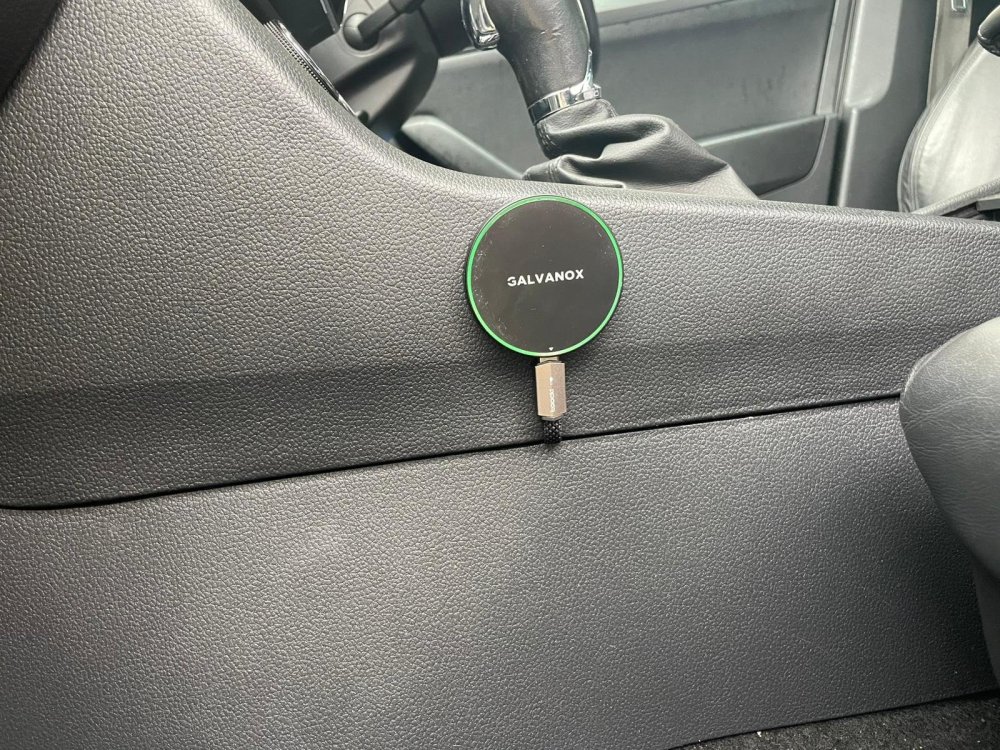

So today after much deliberation over how/where to install the wireless magsafe charger I have settled on a location and wiring solution. My phone was just a bit too big to fit in front of the gearstick in the cubby, and it wouldnt have sat flat on the bottom so I would have had to build up the underside of the wireless charger to make it fit. I did consider putting it inside the arm rest but it just felt a bit too awkward getting it in and out. In the end I settled on putting it on the left side of the centre console. 99% of the time I am in the car on my own, and even with a passenger in situ it isnt really in the way. Its nice and easy to put down and pick up from the driving position and you can move the passenger seat all the way forwards without it fouling the charger, although you wouldnt be able to have a phone on it at the time (and these cars are so huge why would you want to move the front seat all the way forwards anyway!
I wasn't overly keen on chopping in to the OEM wiring to connect it, so I opted for the same solution as I used to get the charging cable into the armrest. Slimline USB adaptor in the 12v socket and flat 90 degree USB C to USB C cable. It routed nicely to the side trim of the centre console and emerges just below the charger for a neat finish. I had to trim the edge of the cubby under the 12v socket ever so slightly but its well hidden by the USB/12v panel. and the cubby cover can still close over the top of it for a nice clean look.
All in all really pleased with the solution, and its easily removable/upgradeable, shouldn't generate any heat problems being out in the open, and I still have the wire in the centre console if I want to plug it in rather than charge wirelessly at all. I shall ask my wife nicely to borrow her phone later to take a picture of my phone in situ.
Wireless charger https://www.amazon.co.uk/dp/B0DL6ZBC3F
USB adaptor https://www.aliexpress.com/item/1005007174454597.html
USB Cable https://www.aliexpress.com/item/1005009553372728.html

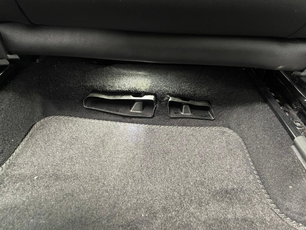

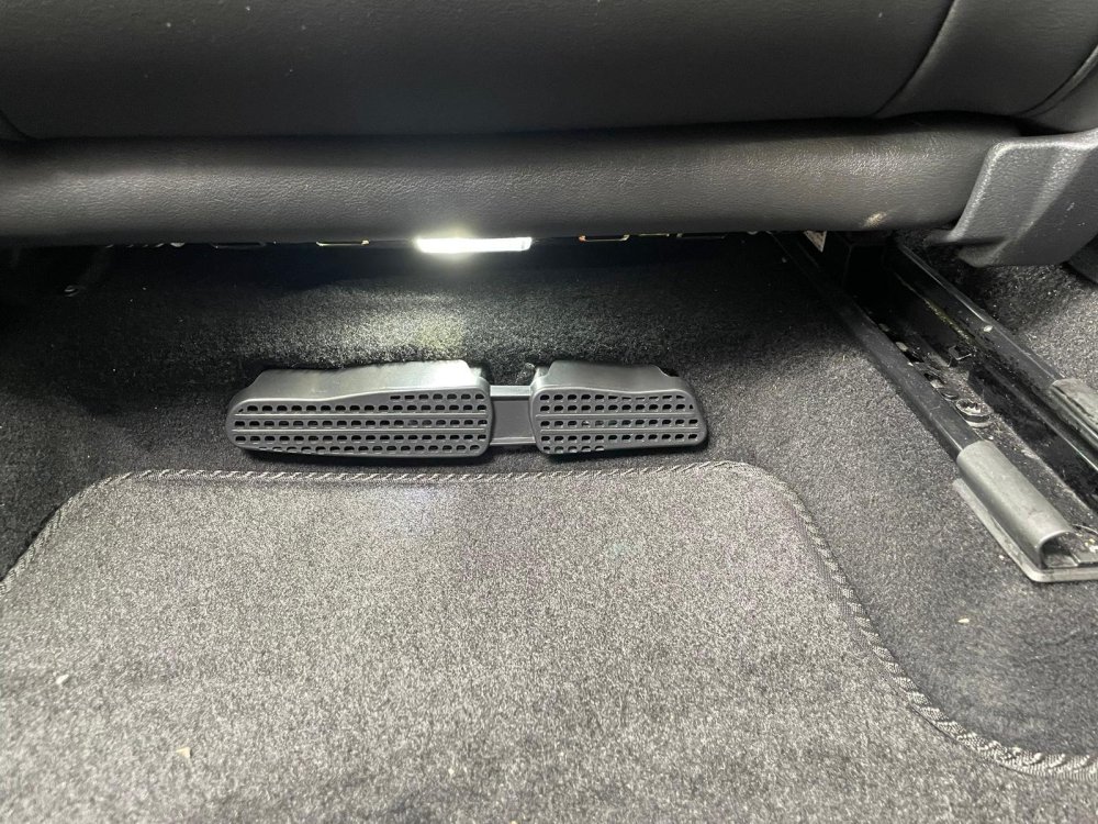

I also installed the underseat vent grills to prevent items getting lost into the ventilation. A nice easy fit and suits the job perfectly.
WhatsApp Image 2026-02-20 at 14.40.3.jpegWhatsApp Image 2026-02-20 at 14.40.37.jpeg
https://www.aliexpress.com/item/32904629443.html

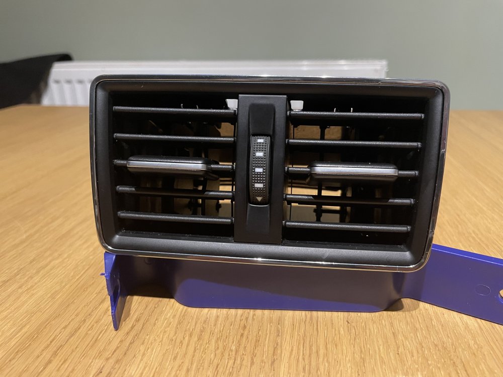

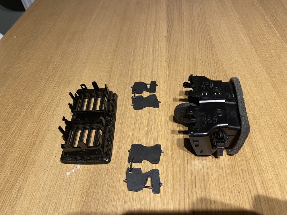

Whilst in the back fitting these I noticed the rear AC vents had lost the clip part from the adjusters. I will go fishing for the bits inside the ducting, if I can't find them I will order the Mercedes replacement parts as recommended by @zedman
https://www.aliexpress.com/item/1005005874666828.html

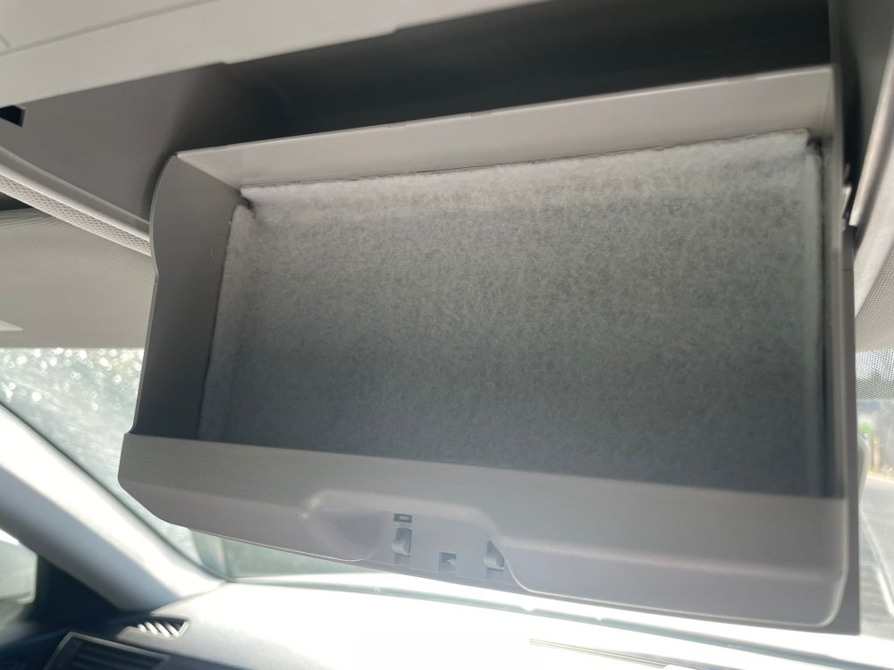

Inspired by a very very minor part of the epic @ApertureS thread, I have installed self adhesive felt inside the sunglasses holder. I was hoping for black or light grey but they only have Red, Pink or white on the shelf, so went with the white. Doesnt look too bad and is nice and smooth for my sunglasses!
Felt was from Hobbycraft: https://www.hobbycraft.co.uk/white-self-adhesive-felt-sheet-a4/5728371002.html

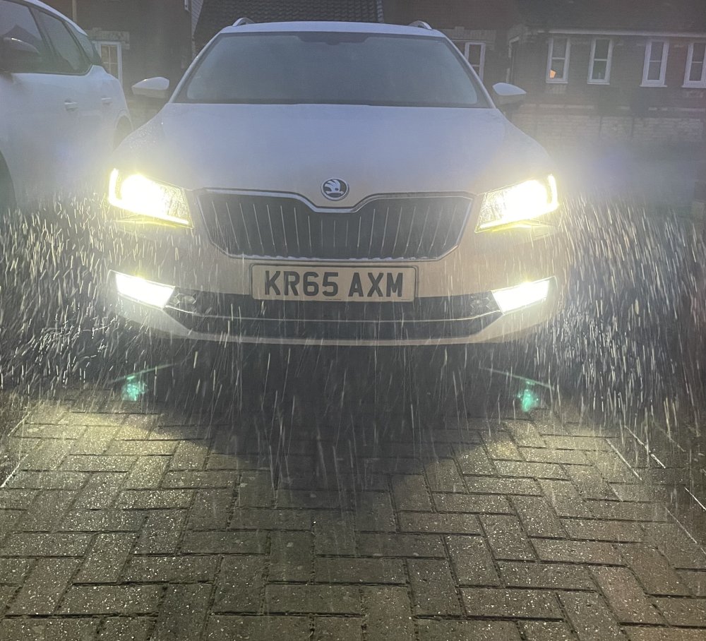

LED fog lights arrived today but I'm not sure when I will get an opportunity to install them.
LED indicator bulbs have arrived but the reversing bulbs were the wrong ones, so waiting on delivery of those.
Fitted the LED fog lights today. Nice easy install and a much better colour.

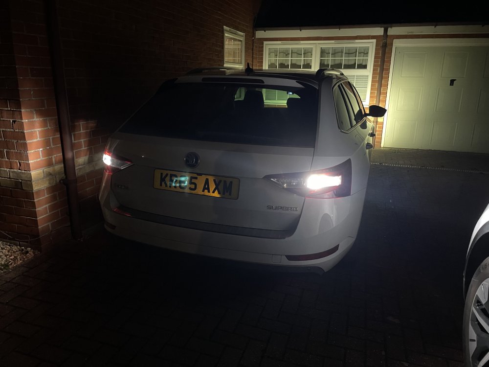

Auxito LED reversing and indicator bulbs now installed. Much brighter and clearer. Another simple but effective upgrade. Difficult to photograph but hopefully the difference is visible. It certainly is in person. IMG_0587.jpeg

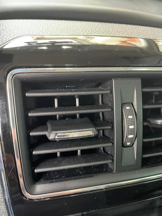

Repaired the rear vent sliders today using parts from AliExpress.
https://a.aliexpress.com/_Ez54g1O
Slightly more brushed than bright chrome surround but they don’t look too out of place and work well. You have to fully dismantle the unit to be able to slot everything in. All done in about 10 minutes.

Also fitted the new pedals. Link further up this thread.

Fitted the wheel nut caps today and looks much smarter.

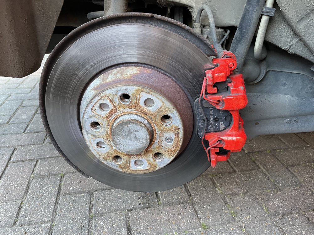

Broken spring and top mount, and misting shock so those all changed on OSF.
I also appear to have misplaced the locking wheel bolt adaptor. The garage managed to extract the one needed for the work by welding on a bolt to the head of the locking bolt.
But for the others I was able to match a picture online with the pattern in the locking bolt and order a new adaptor from Amazon. I undid the three remaining lockers and cleaned up and returned the adaptor for a full refund! Now replaced with standard bolts.
New nut caps ordered to have a matched set in grey.
Black and white logo badges, black SUPERB badge, Black Skoda valve caps orderd too. I shall also order some "Chrome Delete" film to start the blackout project as per @Kosin inspirational photo.
Full service Friday, and hopefully if they have time a brake fluid change and DSG service to bring it all up to speed.
Rear brakes will have to wait until next month!

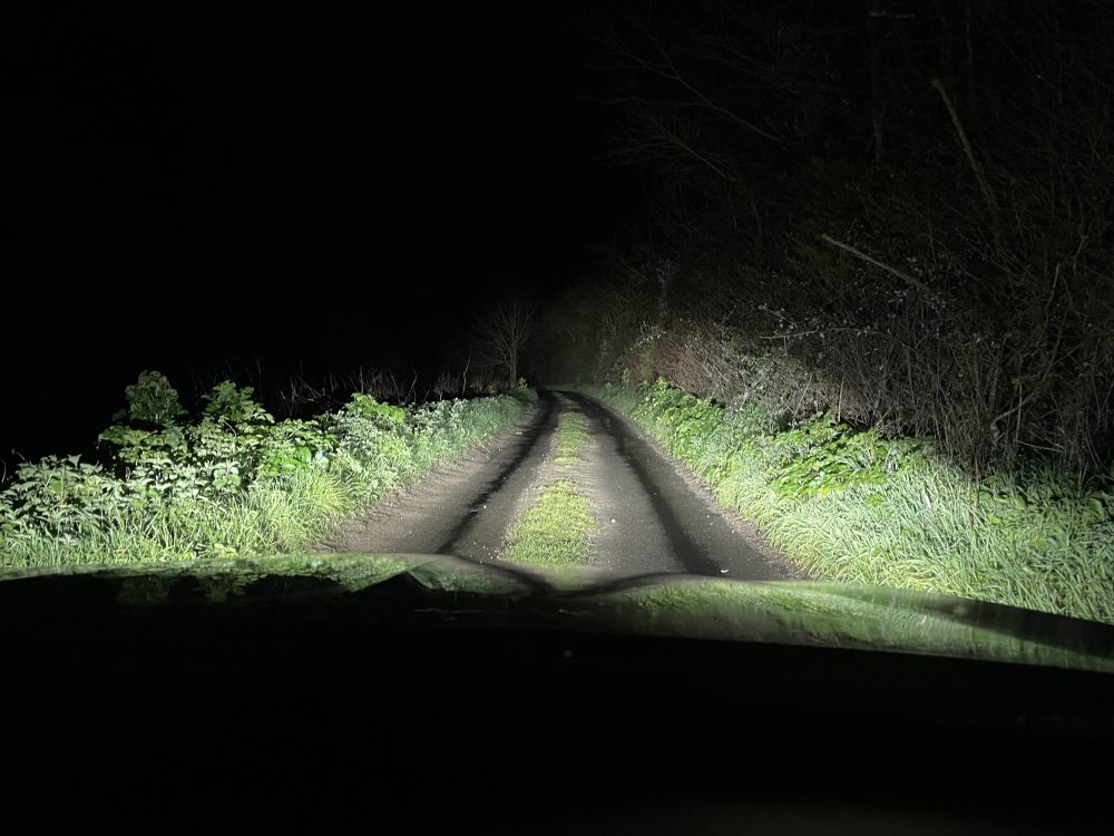

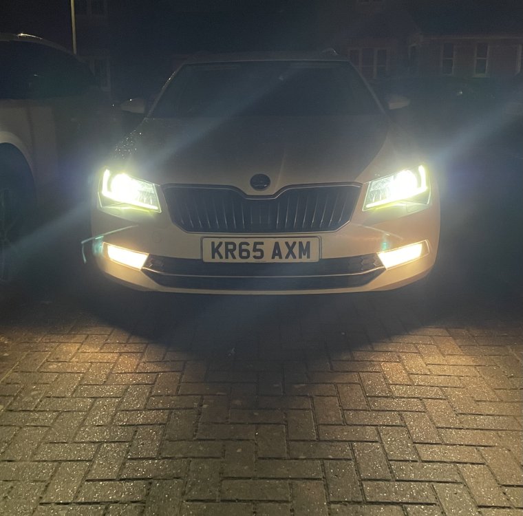

Fitted LED headlight bulbs as recommended by @AL2772.
https://ebay.us/m/GEjuI6
Definitely not an easy fit and don’t even bother trying to do them without taking the arch liner out. But once it is out it’s not too bad a job. Had one fault come up when first installed but cleared the code and now all good. Much brighter and clearer than the previous bulbs.

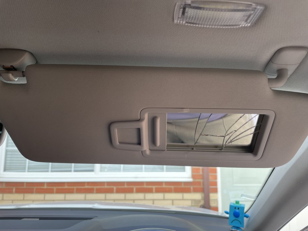

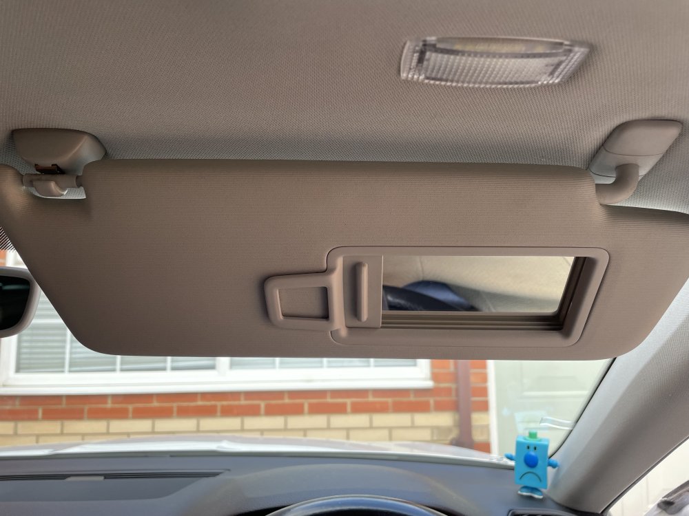

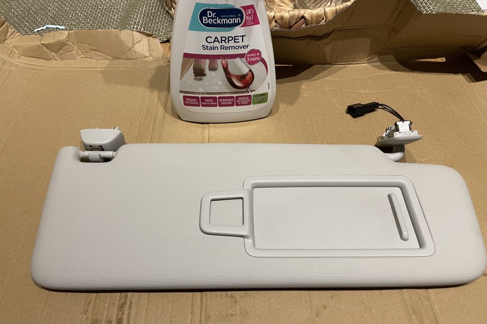

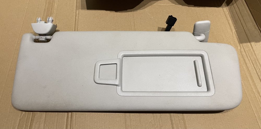

Replaced the broken sun visor with a second hand one from eBay. Most are listed at around £40 but I stumbled across one listed at £25. A quick going over with Dr Beckmann carpet cleaner and it was as good as new.
Removing the old one was awkward but refit was simple.

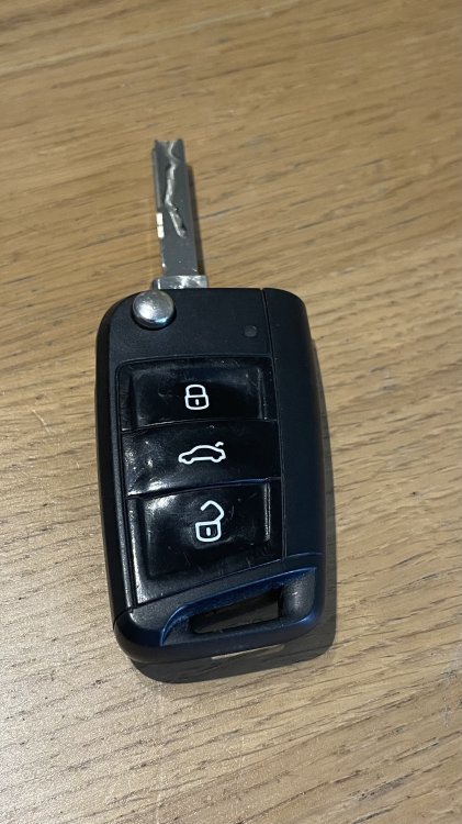

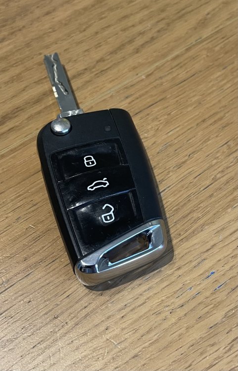

Chrome key bottom
https://a.aliexpress.com/_EGD5wPe

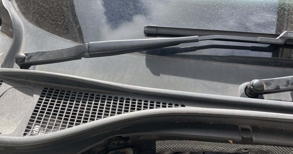

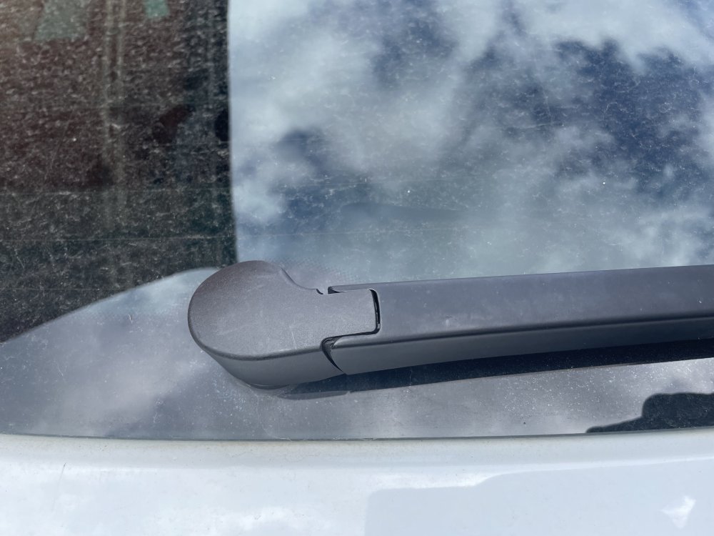

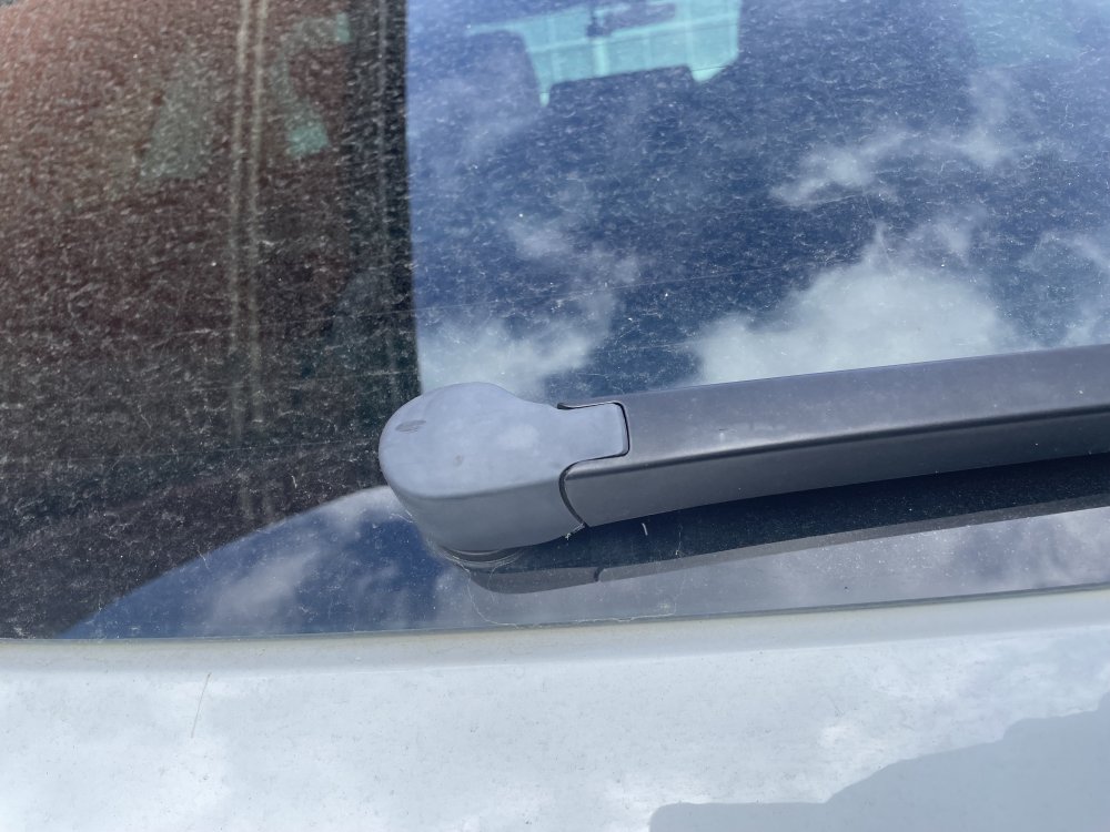

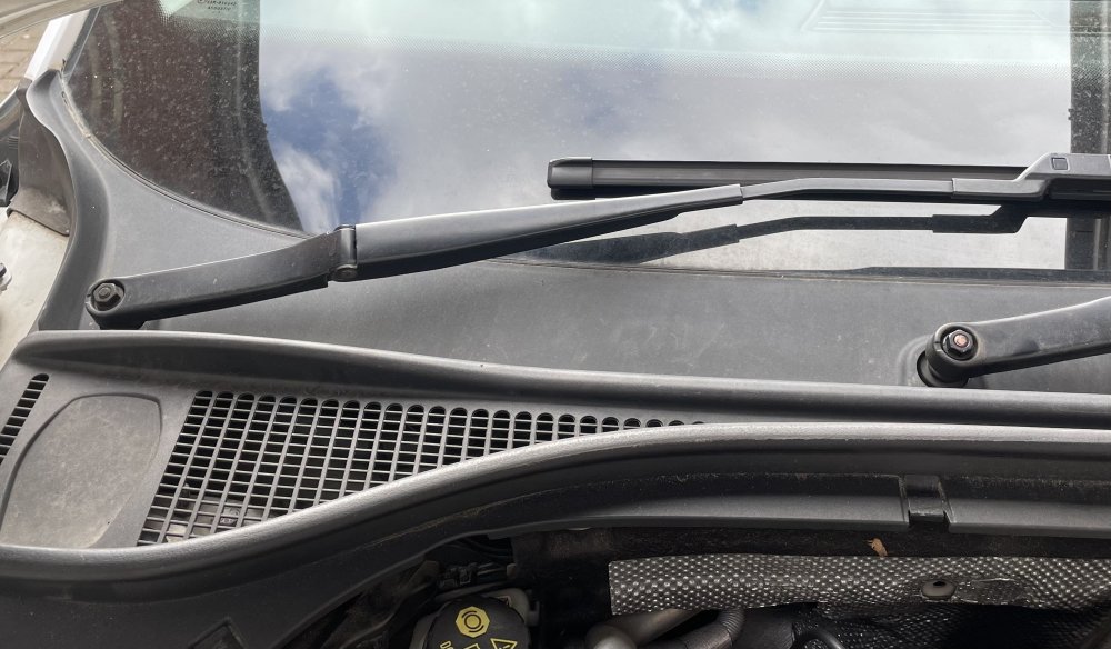

New plastic cap on rear wiper to replace the sun damaged old one.
Not quite as nice a fit so I may try to revive the old one.
Replaced missing caps on front wiper bolts.
Why Not all New Key Cover?
I saw the chrome part come up on suggestions on Ali express. Not searched for a whole key cover. Might have to look now…

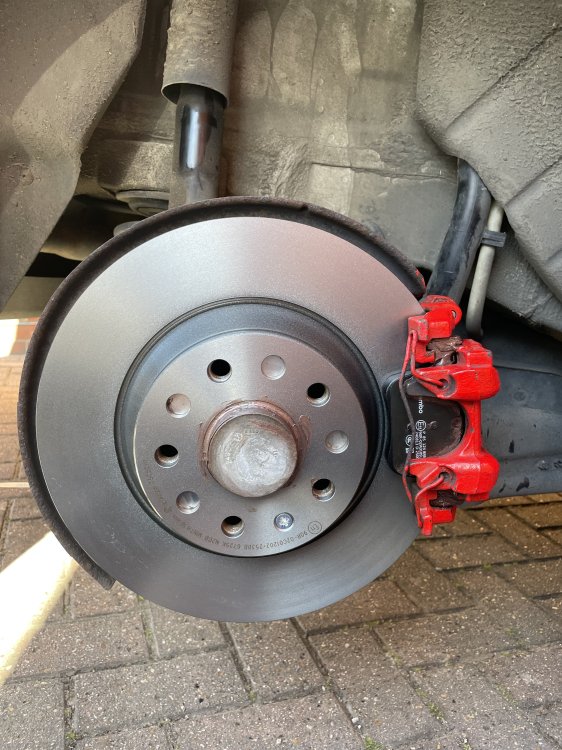

Rear pads and discs changed. This seems to have cured the rumble under braking when on ACC.

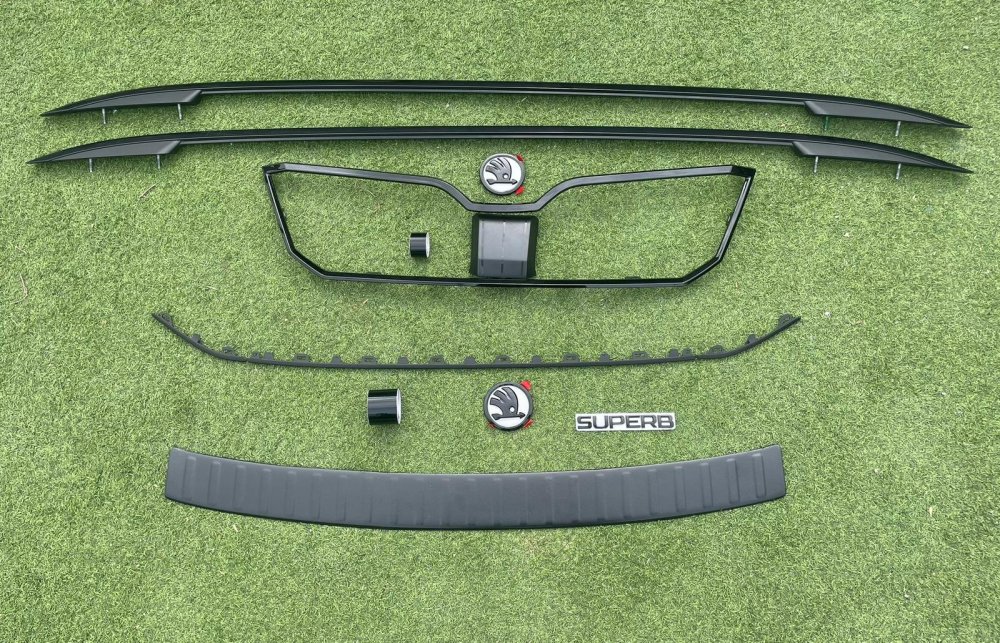

I now have nearly all the parts for the chrome delete project. Just need to find the time to fit them all!
Grill Surround
https://www.ebay.co.uk/itm/177879476697
Lower Grill parts
https://www.ebay.co.uk/itm/177879048390
https://www.ebay.co.uk/itm/157695824834
Radar Cover
https://www.ebay.co.uk/itm/305273235761
Black/White badges
https://www.aliexpress.com/item/1005009424974993.html
Black Superb Badge
https://www.aliexpress.com/item/1005003980570506.html
Black Bumper protector
https://www.ebay.co.uk/itm/377061941246
Roof rails were from an autosalvage on eBay
https://www.ebay.co.uk/itm/267450005368
Chrome Delete tape for Window surrounds and grill bars
https://www.aliexpress.com/item/1005005051534918.html
Black Wheel centre caps (Awaiting delivery)
https://www.aliexpress.com/item/1005009034228022.html
