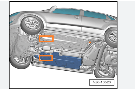

Probably rainwater out of the longitudinal chassis member under there. It has drain holes which may have been blocked, then not. Or it may have come from higher up, there's an area under the brake fluid reservoir that drains into there, I think.
