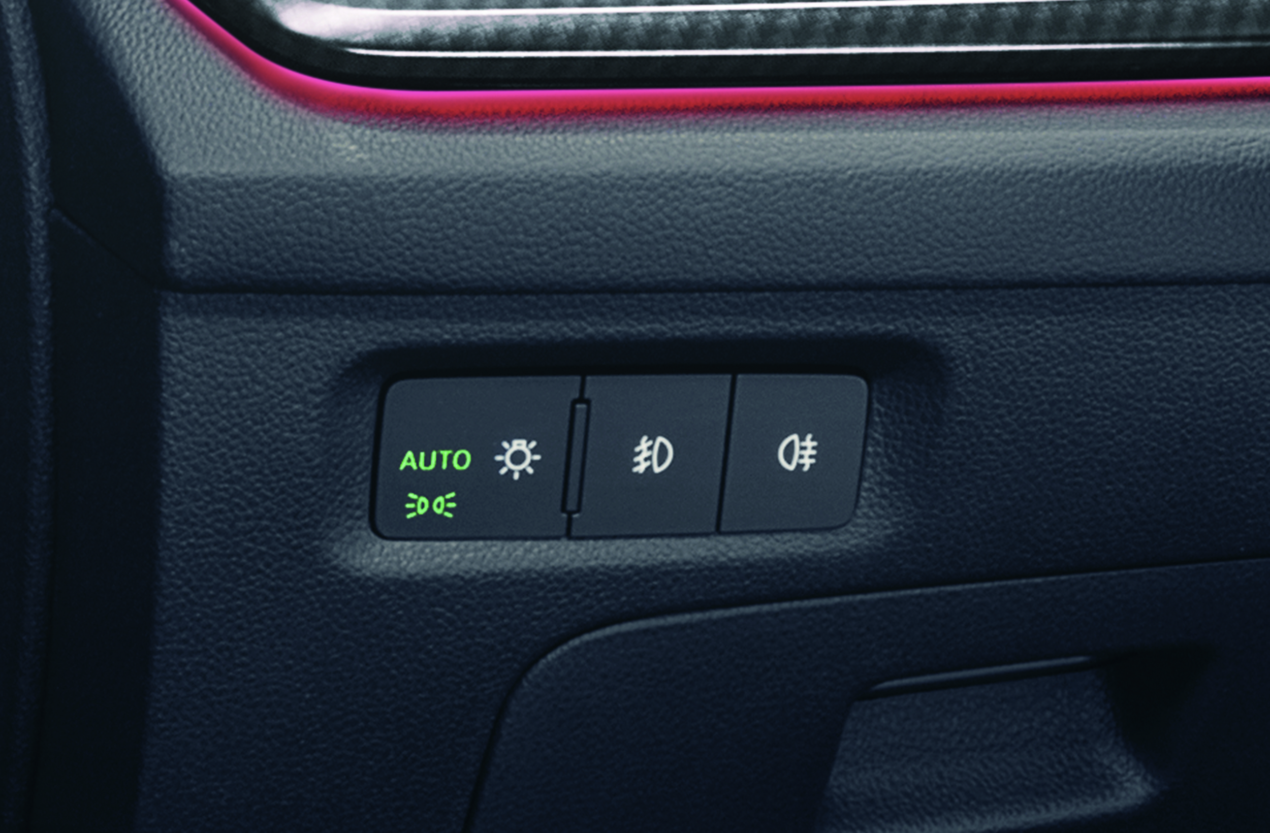

There is a set of three buttons low on the dash near the drivers door; the right hand one is illuminated with Auto. When the headlights are on there is also a bulb symbol illuminated above the word Auto.

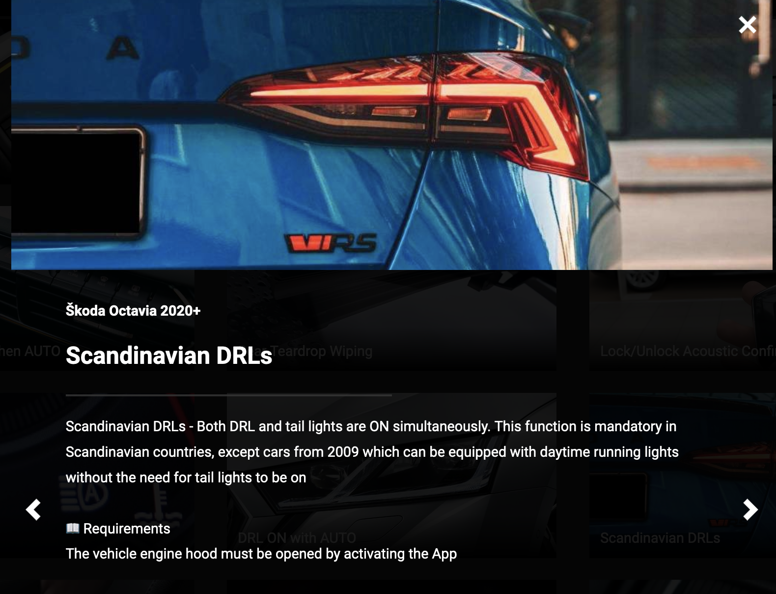

Most countries don't have mandatory rear-daylights; Scandinavian ones do - hence the name of the App in OBD-eleven that turns on the back lights also during daylight.
The risk of driving in darker areas (with Octavia) with no back-lights is practically zero, unless the owner does some coding with VCDS of OBD11. The car will automatically switch lights to "Auto" above a certain speed (10-20 km/h, not sure) which means it will turn ON front and rear lights when in gets a bit darker or when you enter a tunnel. I actually noticed it turns ON the lights quite early for my taste, when there's still plenty od daylight outside.

Finally, as @SteveTheElder mentioned, since there's no indication on the dashboard, you need to check the button under the steering wheel (left in my case, right side in yours) - you'll see an extra light coming ON next to "Auto" once the headlights start... (see the User Manual for details on each symbol)

IIRC in bright daylight with lights OFF in "Auto" mode only the "Auto" will be green-lit on the switch.
Yes, you do indeed recall correctly 🙂
