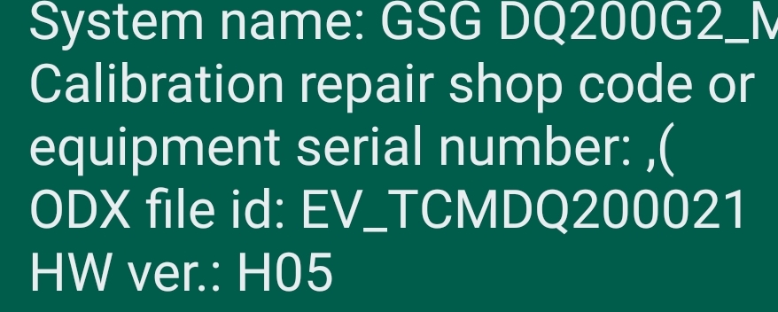

Thanks toot for the detailed reply ? No it's a fwd only
I will ask for the master technician , thanks for saving me 240£
This is what I got from odbc scanner , it's a dq200 gearbox
Screenshot attached
