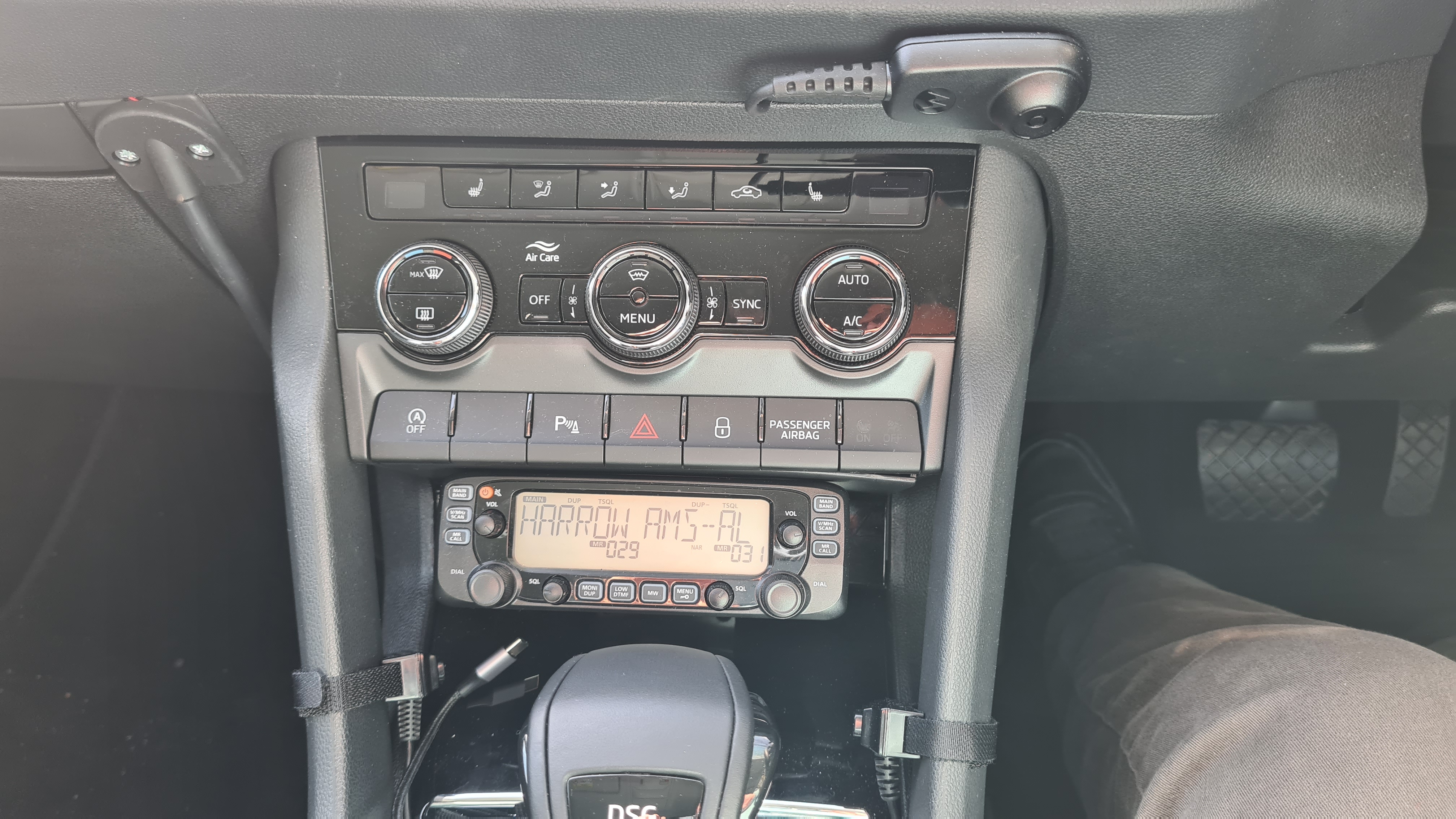

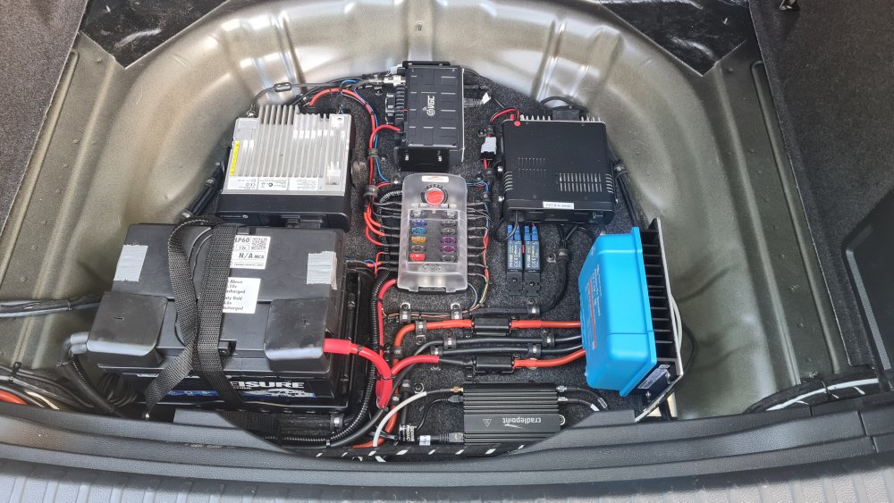

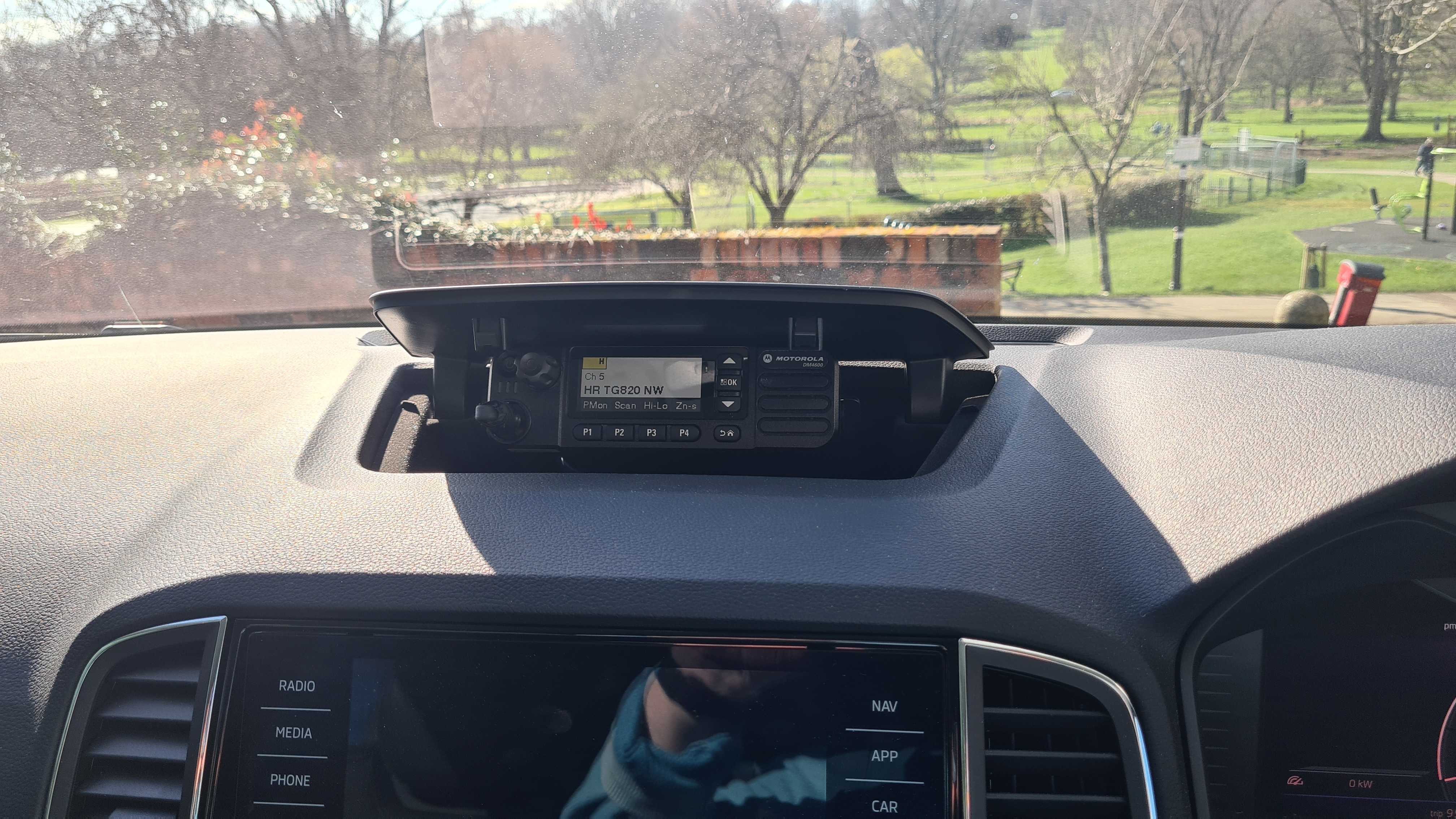

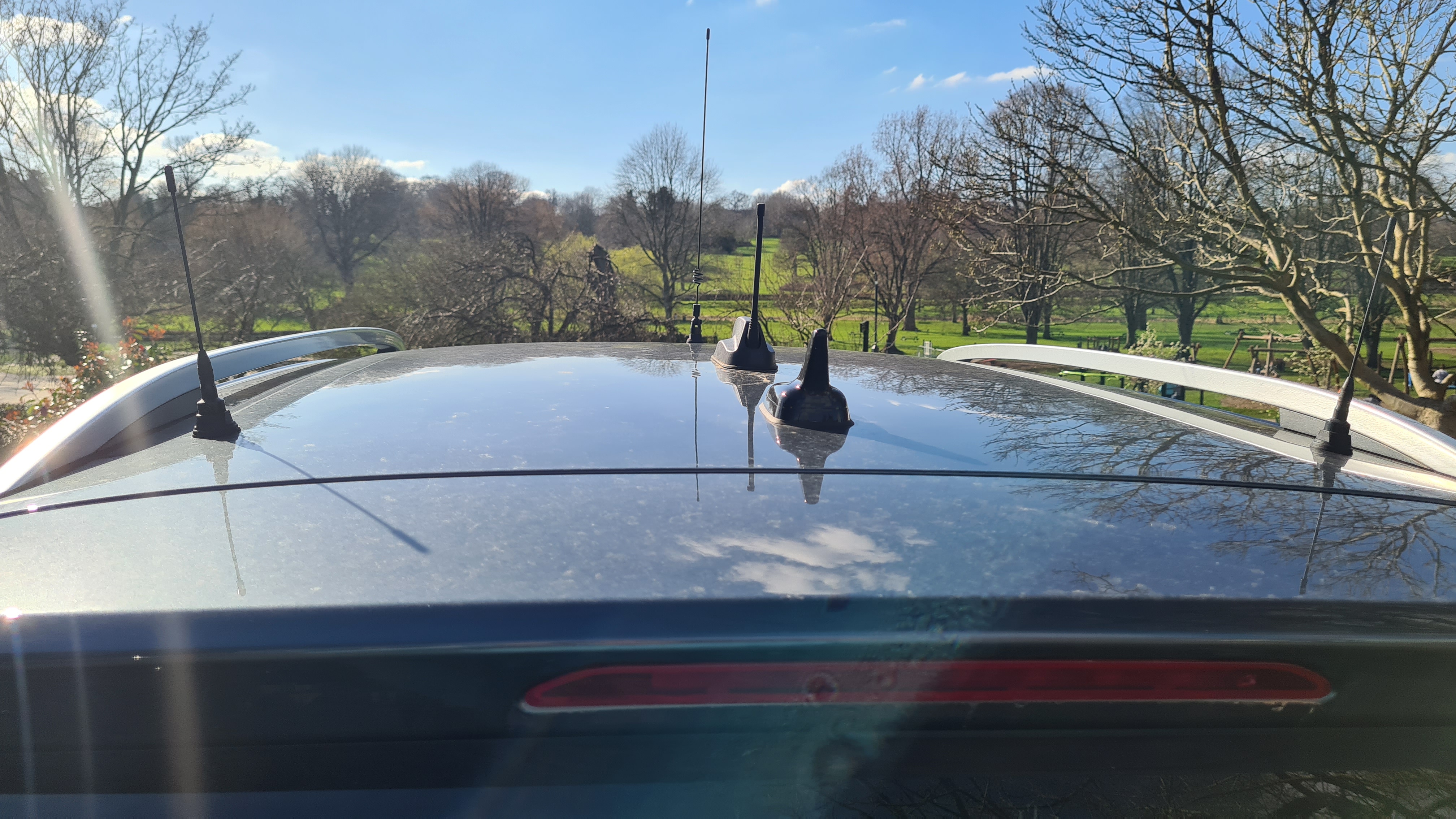

I also have a radio installation in my Karoq SEL, and can confirm that there is a good grommett behind the battery to go through the bulkhead.
I run quite a bit of comms kit in my car, and have an auixilliary battery in the boot with smart charging. This obviouly saves loading the vehicle battery, but as the car (being EURO 6) has a BMS (battery management system), if you pull an unexpected load (e.g. high power tx) from the battery, then you may get a waring on the dash.
Here are some images of my installation 😄
Cheers, John (G8SYD)20220318_142734.thumb.jpg.fedd31543d54192a4318fe313dfff12f.jpg
