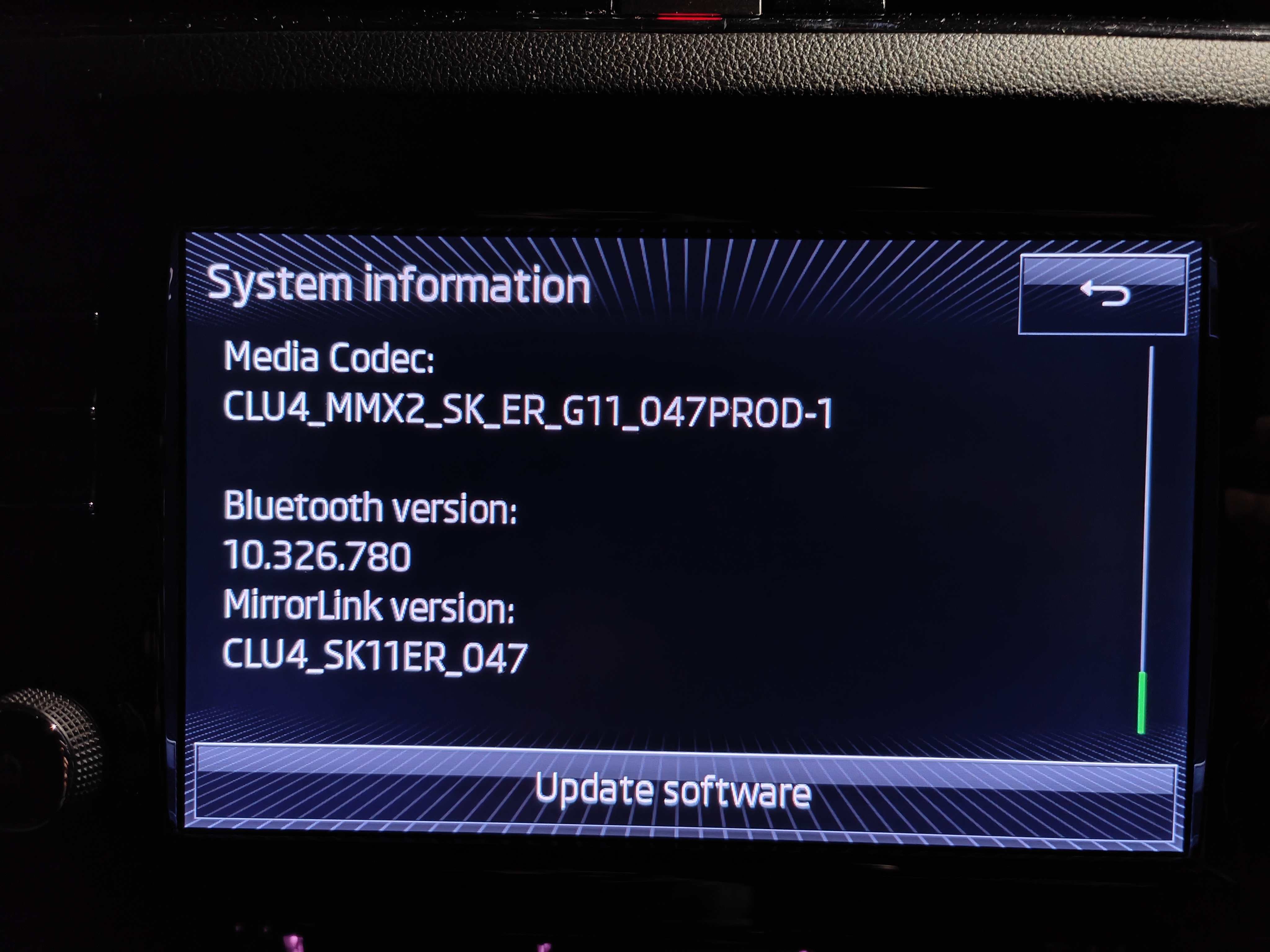

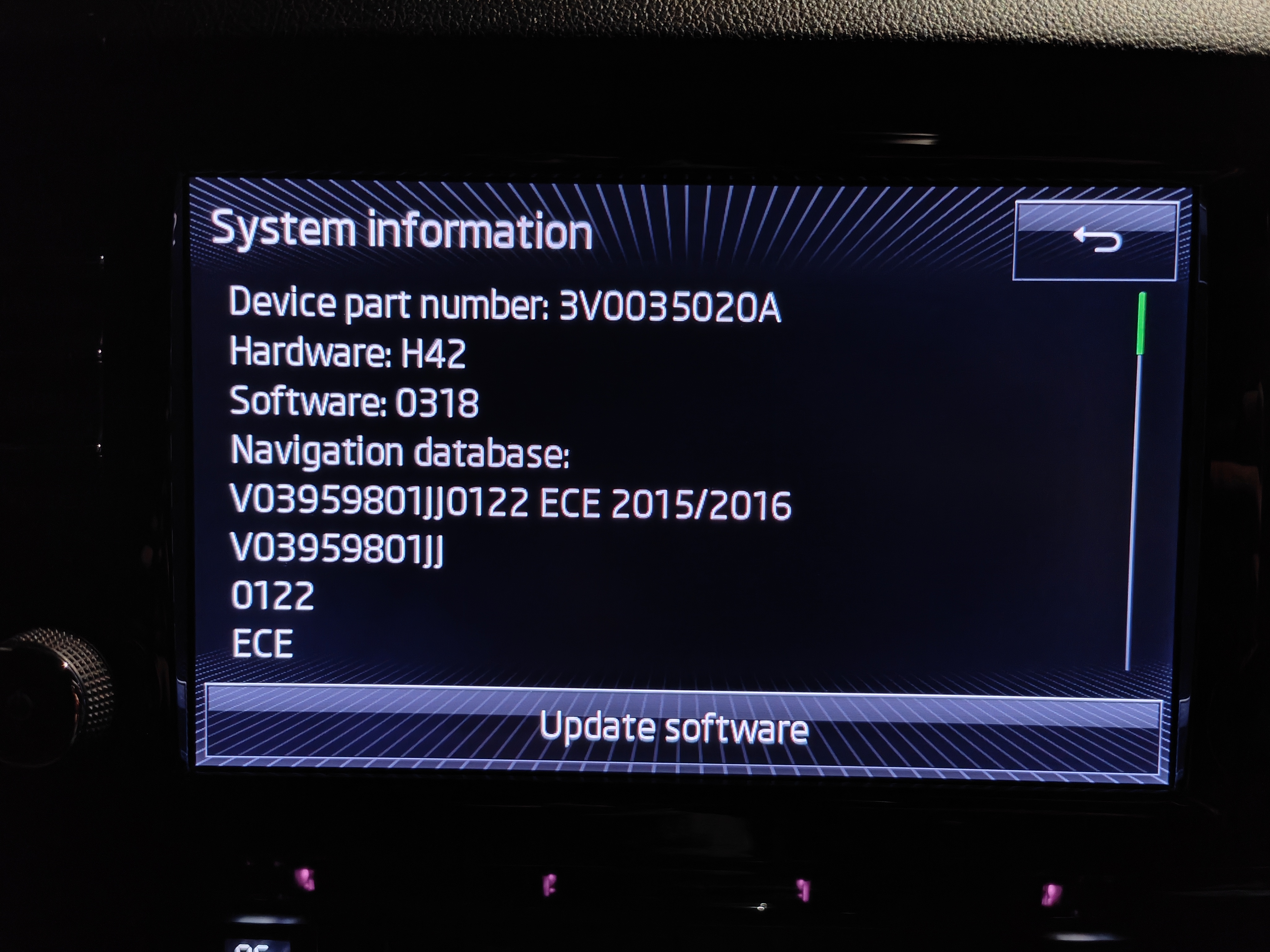

16 hours ago, varooom said:
It's for your car radio firmware, as you asked about updating it.
Info below! Thanks Varooom.
My guess was close then.
release = "MHI2_ER_SKG11_K3343"
MUVersion = "1433"
SupportedTrains = "MHI2_ER_SKG11_P2104*,MHI2_ER_SKG11_S2104*,MHI2_ER_SKG11_K2129*,MHI2_ER_SKG11_S2129*,MHI2_ER_SKG11_P3260*,MHI2_ER_SKG11_P3304*,MHI2_ER_SKG11_P3325*,MHI2_ER_SKG11_K3330*,MHI2_ER_SKG11_K3333*,MHI2_ER_SKG11_K3343*"
I will send you the above release, you will jump up quite a bit in version number (normal)

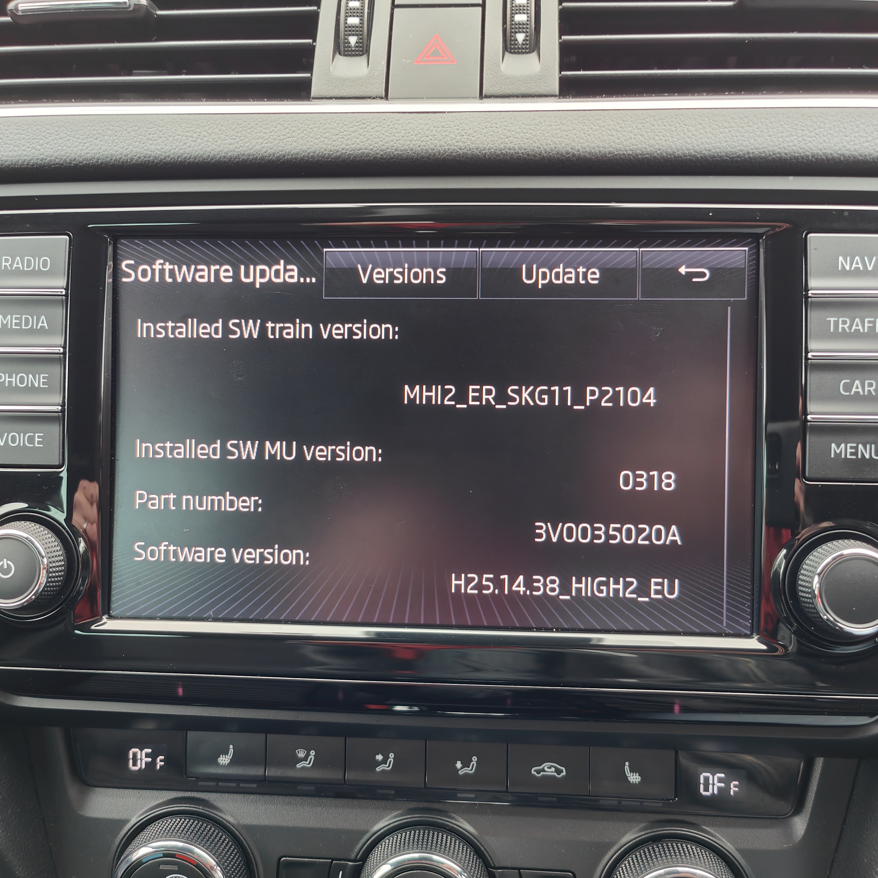

Hi Vavoom,
I have the same train version.
Can you please send me the release as well
thanks.
