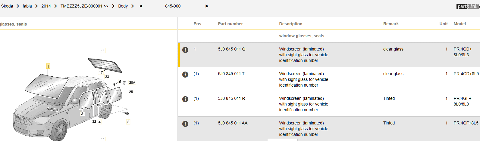

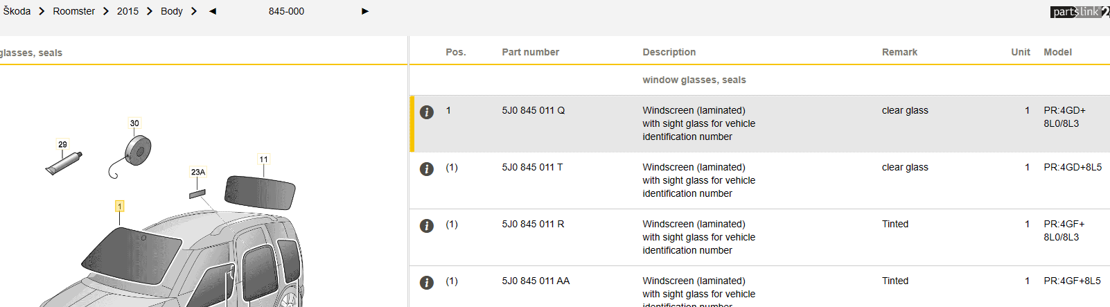

All the screen options appear to be identical between the two models Roomy and Fabia mk2 (years picked as being close to your car):
You’re a star Breezy_Pete. Most excellent info. I shall be contacting a heated windscreen manufacturer shortly & I’ll post a reply to let you know how I get on
