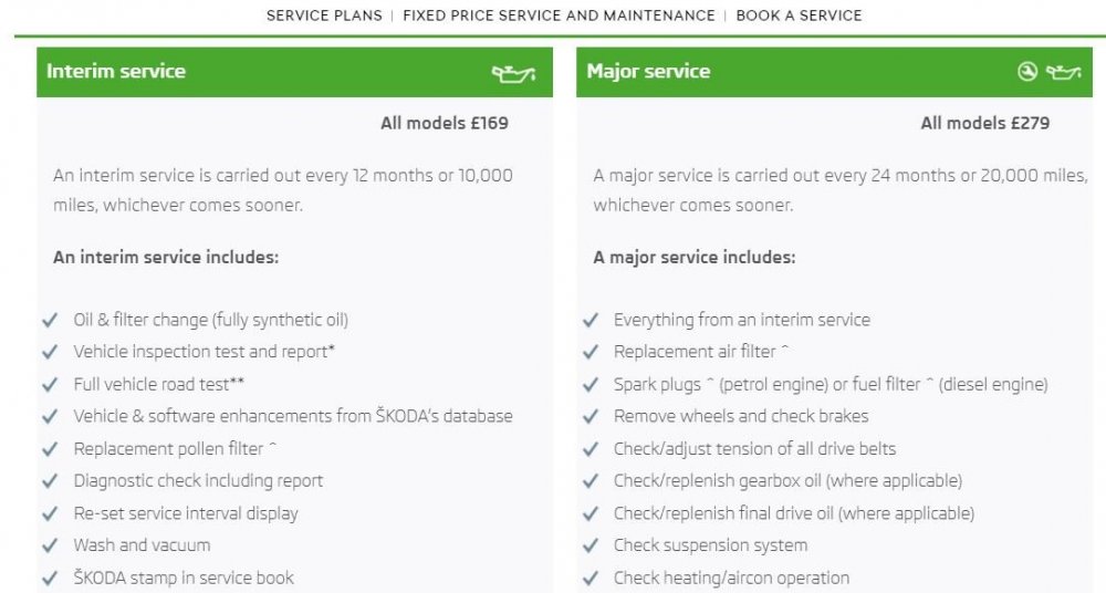

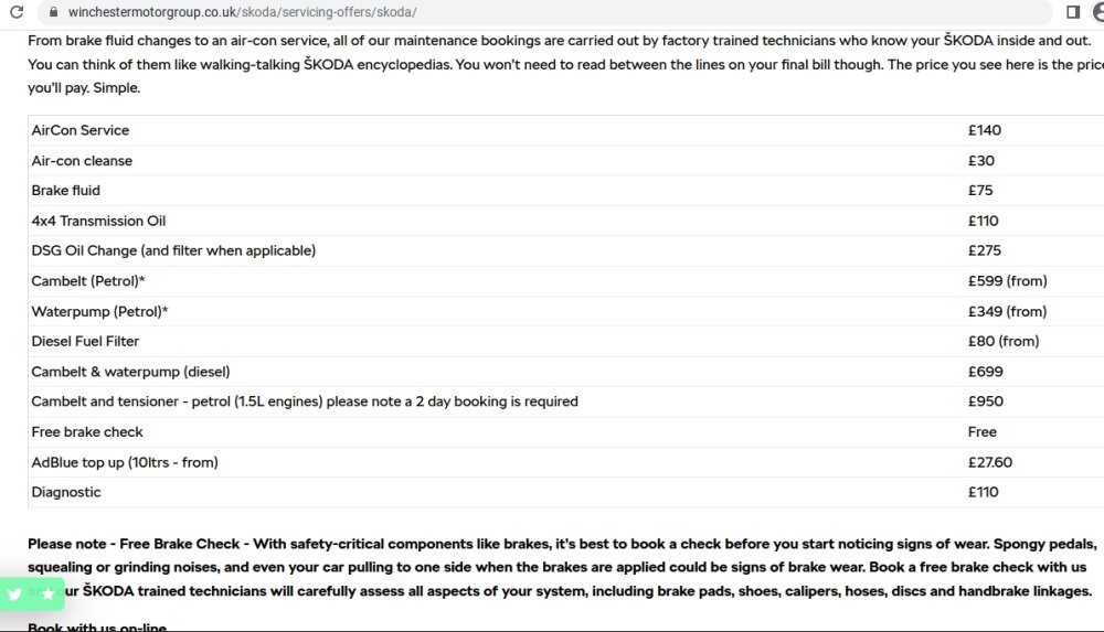

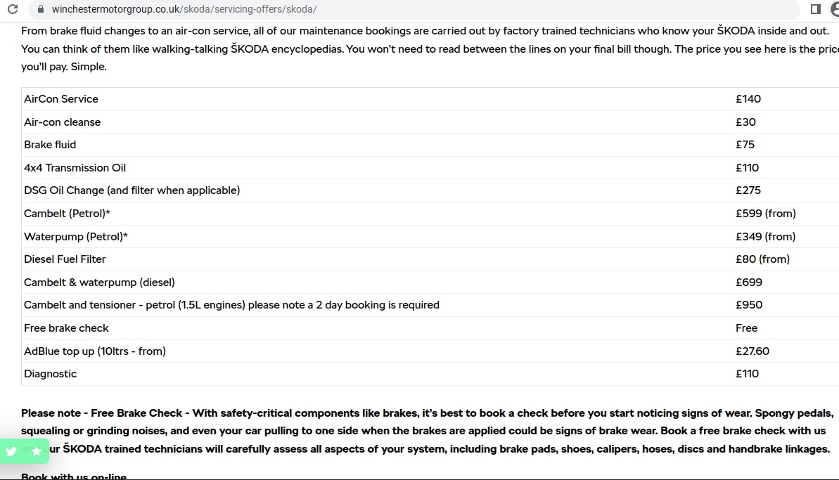

Skoda UK / Main Dealers will say Cambelt & Water Pump at 5 years.  Read the threads on the 'Tea Bag' in the coolant bottle and people removing that if they have a car with that.
The Haldex service is at 3 years / 30,000 miles and needs done properly, not just an oil change.  So due the 2nd service of it on a 2017 car.
Brake fluid changed @ 3 years then each 2.   So done at least once is really how it should show as.
Fuel Filter @ 5 years.   etc etc.
Expect these sort of costs now.
Cheaper maybe at an Independent.

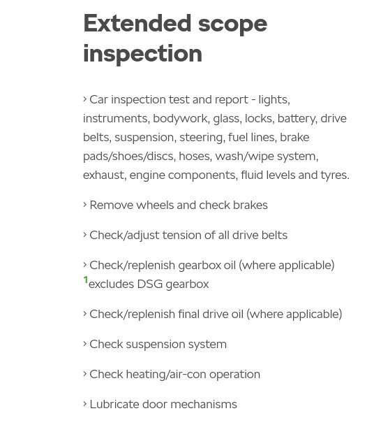

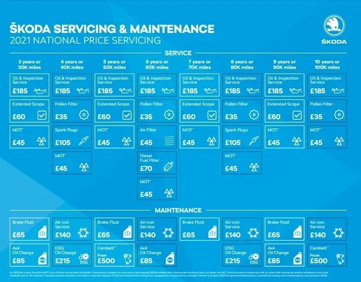

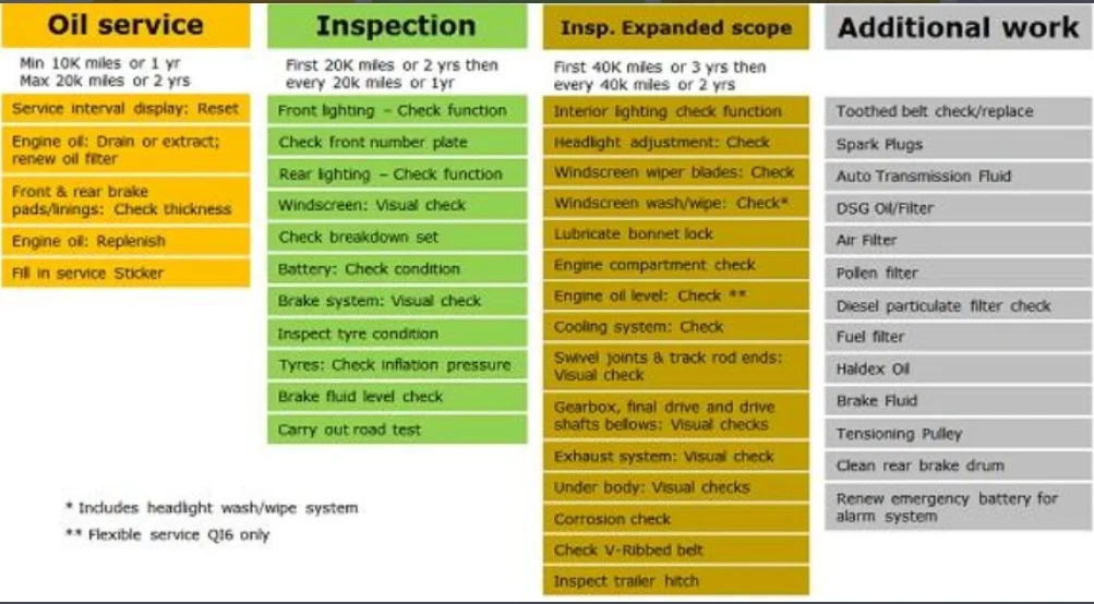

Actually Air Filter are a stupid 6 years and some are not simply checked at services.   Fuel Filter @ 6 years.
Haldex was @ 40,000 miles until VW brought it to 30,000 years, then 30,000 or 3 years and Skoda changed a year or 2 later and still do not have the Filter as an item for changing,
cleaning etc.
Skoda have recently changed some cars like the Fabias to first brake fluid change at 2 years which is what it was about 13 years ago before going to first @ 3 years then each 2.
Other world regions / dusty ones are not @ 5 years or by almost no miles like 50,000 , 60,000 etc.     VW still can not convert km to miles in many cases, and differ from Audi.

6 years... For the pollen filter also! Wow, and is that first oil service at 3years? That's incredible.
We had issues when longlife servicing first came out on VWs, so I've always been a great believer in the annual 10k oil and filter service with my cars.
I suppose it makes sense to change the haldex filter each time the oil is replaced; just hope the oil is up to the increased distance.

Not first Oil Change @ 3 years.

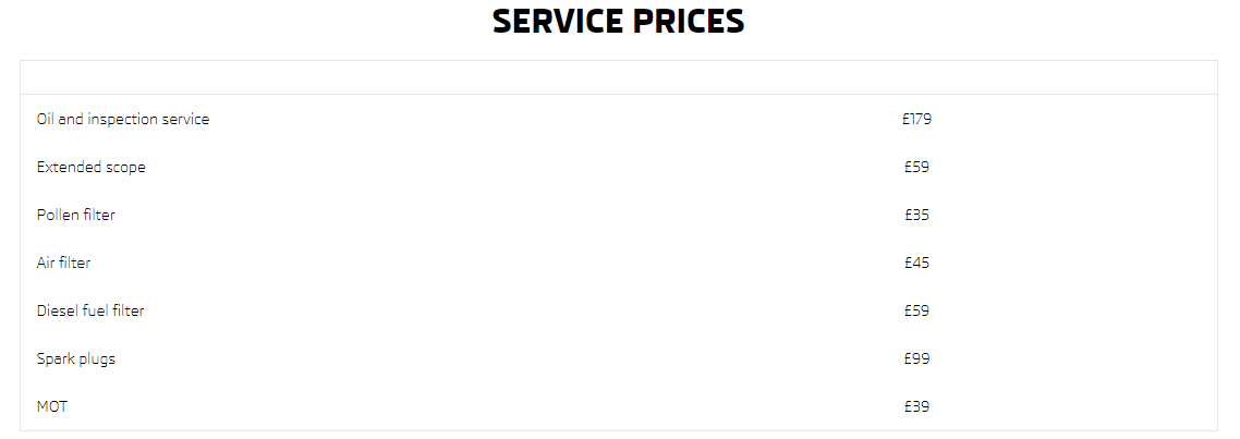

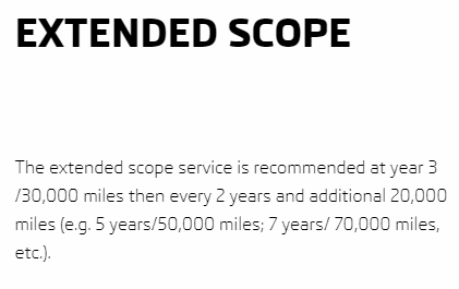

That was the Fixed Service & Maintenance in 2021 on 3-10 year old cars on Fixed Services.
Until 2019 end it was Still Minor / interim or Major Services on Fixed / Annual Services, or Major services each 2 years.
2020 they cam up with the Oil & Inspection Services and then @ 3 years Extended Scope, then extended scope each 2 years.
You pay for each extra you get gone instead of the Major Service scheme where they charged you a fixed price including VAT even when you never got an Air, Pollen, Fuel Filter, Spark plugs etc.

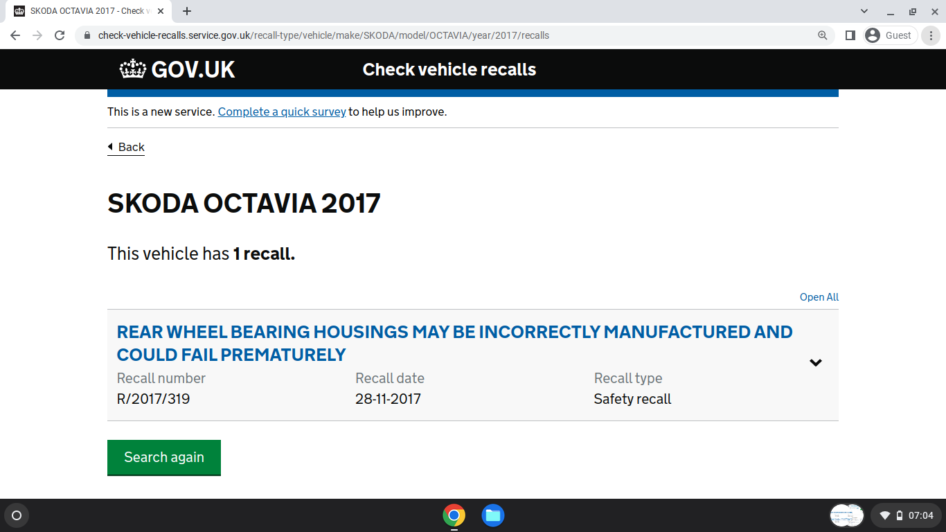

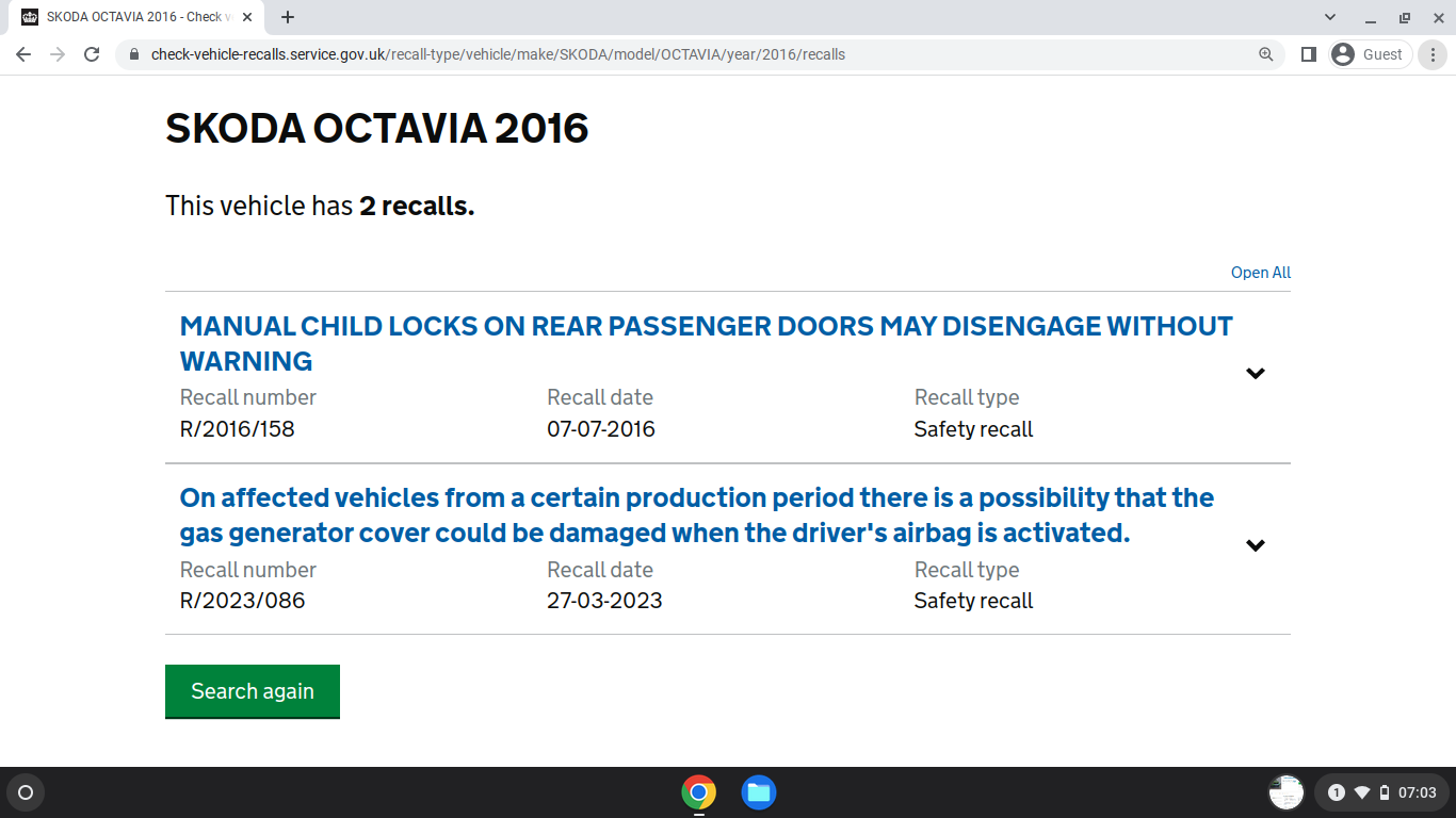

Quick one on Skoda recalls:
A vehicle I'm interested has a note on it's history for one being carried out. Is there a way I can find out which one it was do you know?
Thanks
Skoda Main Dealership staff or Skoda UK's Customer Services Contractor can or should be able to tell you what RECALL there was on your car.
I suspect it was a Service Campaign or Recall Action, or a TPI covered something.
Pretty sure your car was not part of the Defeat Device Voluntary Recall but there were some cars that then got some sort of Software / Engine Management Skoda Secret Service sort out an emissions issue, 'don't ask we do not know type thing'. Loose lips can kill, on a need to know & VW decide owners need not know!

Many thanks, I shall enquire with Skoda UK recarding that specific recall.
I know one of the vehicless I'm interested in has had a wheel bearing replaced.
