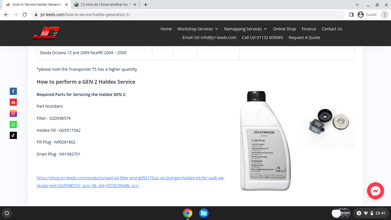

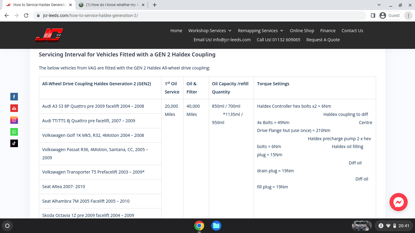

IIRC it’s every 4 years or 40K Miles. Don’t forget the hidden filter if yours has the gen 4 Haldex. Loads of good info here:-
Pretty sure the above is right but its Gen2.  Still has a filter though
No not @ 40,000 miles.
Do the 20,000 & 40,000 with filter or more sensibly @ 20,000 miles on older cars, so 2nd Generation Haldex.
Then Skoda was doing @ 4 years / 40,000 miles still on newer generation Haldex when VW were at 30,000 miles, then 30,000 or 3 years.
Skoda took a year or more before they got up to date, and still til this time will change oil and not do a clean out or filter.
