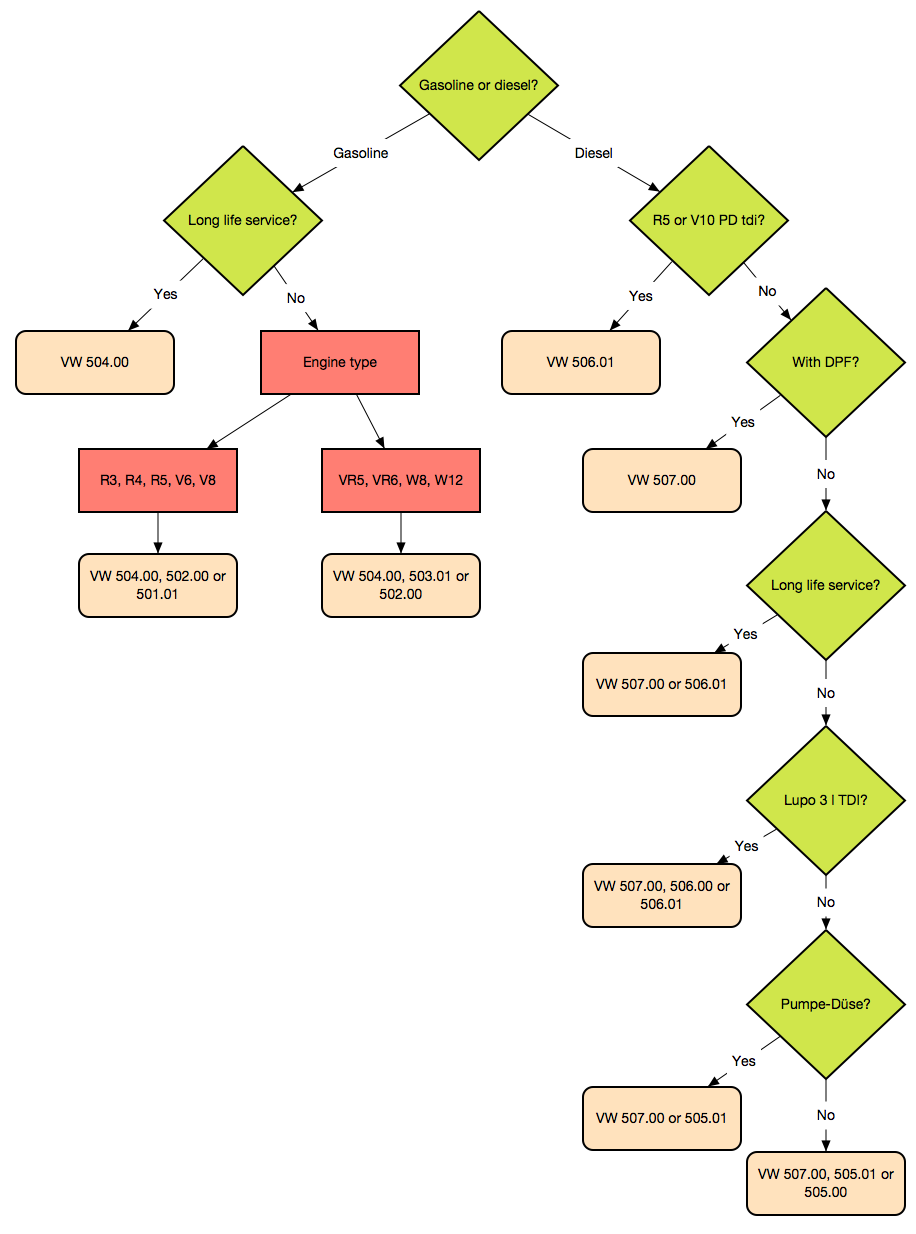

Bottom chart is from the past, so pre VW508 00  509 00
image.webp.b48e6771853b15b770e956a10ec5660b.webp.2721e5e275bfd9c6b35e39bef234c58e.webp
1872327318_972195316_Screenshot2019-07-21at16_37_00(3).webp.50641ab517e18486d2a3840fbc61abdb.webp.a958cfdbadb3bb783edc2bad01b2ea3e.webp

@toot your second picture means nothing, because it does not specify engine year. There are 1.5 TSI engines from 2019, and 1.5 TSI engines from 2022.
