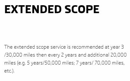

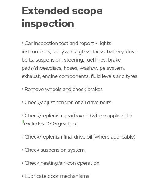

So what does the Full Service History show other than Oil & Inspection Services & Extended Scope in 2021 and then 2023,
is it even that.

1179912860_922218293_Screenshot2022-09-2115_58_57.jpg.3711dc86397a804fc83f268add4ae736(1).jpg.606196879c2532f67305f1ec411800c6.jpg
1025295341_Screenshot2021-09-29at07_53_17.jpg.f3e4a6dc63cb89105f9b1ac440bb1614.jpg.d2aa9588510e56bd2fc59b98189193a0.jpg
