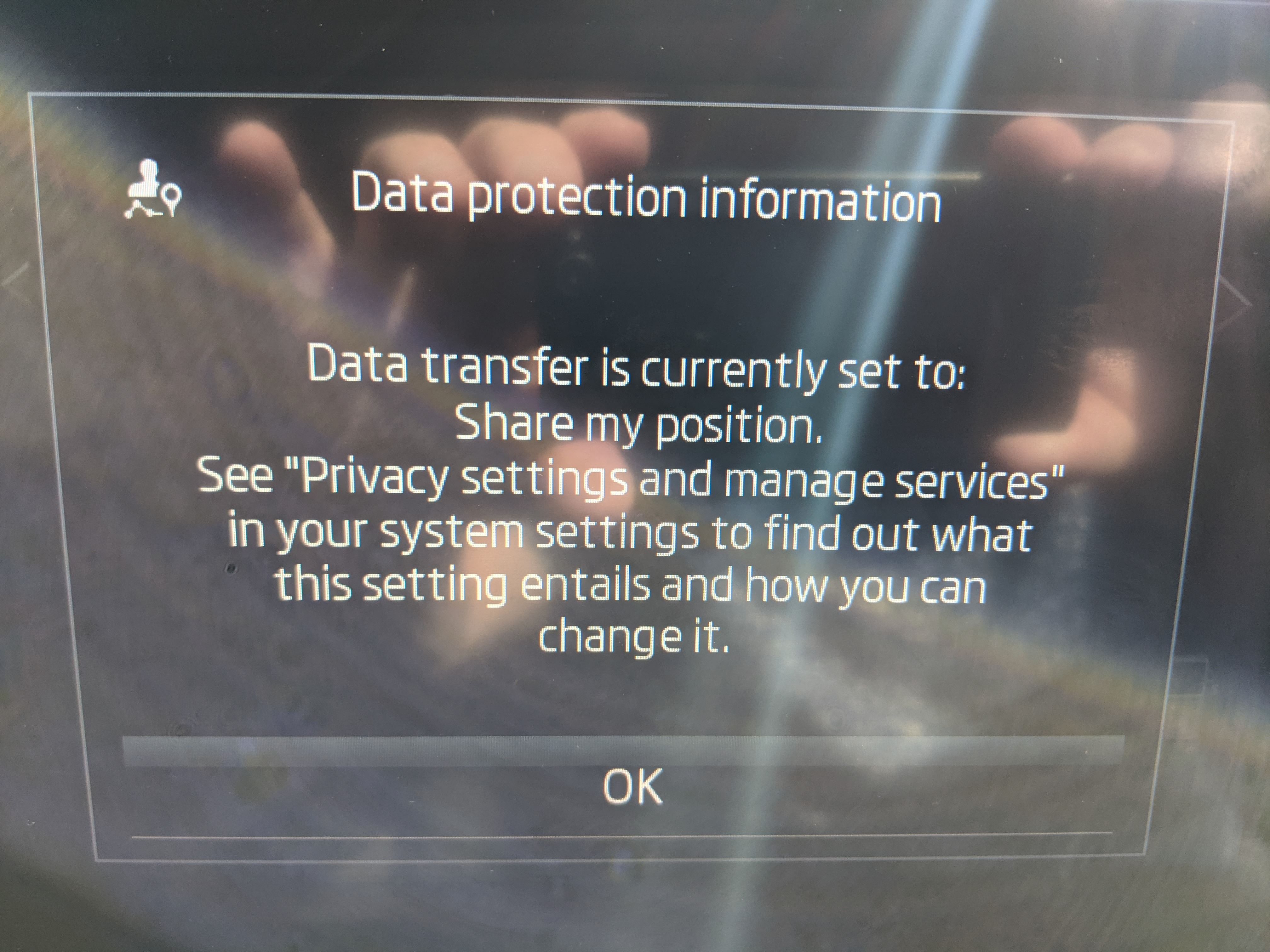

Every time I switch on the Infotainment screen I get this "Data Protection Information" displayed  - see attached photo. I have to tap the "OK" on the screen to get rid of it. Not a huge issue, but slightly annoying.
It's telling me to go into "Privacy and Manage settings" in the "System settings" to change it . However, I don't have any of those options in the  "System settings" .
Anybody know how to get rid of this message permanantly?
I've got my mobile phone linked via Smartlink OK, but I don't think it's anything to do with that.  Is it something to do with Skoda Connect Services - I haven't signed up to that and don't want it anyway. Could the previous owner of my Fabia signed up to it and it's some sort of hang over from that ?

It's just a standard message, show every time, regardless of settings or Skoda Connect status
The reason being that the car does report back to Skoda, even without Skoda Connect, and if the vehicle was in use by another driver, be it in a hire car situation or if your vehicle was ever in for repair. It would technically be unlawful for skoda to collect data information without informed consent.

Try not physically turning off the infotainment unit using its ON/OFF button.
This means that the infotainment unit will be on continuously until the car's doors are locked, when the infotainment unit will automatically 'sleep'. Then, when the car's ignition is next turned on, the infotainment will automatically 'wake', but no Data Protection Information message should appear.
That sort of works, but only if you've got say the radio on the screen when you switch off the ignition and lock the doors. When you switch the ignition back on again, then OK the radio comes back on and not the "Data Protection" message.
But I don't often have the radio on in my Fabia, and prefer just the clock and date display.  As soon as you turn the radio off, then back comes the "Data Protection" message.
I've now got used to tapping the "OK" on the message as soon as it appears and it doesn't really bother me now - along with all the other buttons I press to cancel things like "stop/start" and "lane assist".  The later invented by some nerd !!
Yes, it's a 'fudge' - but it works after a fashion.
It was suggested elsewhere on this forum and I tried it on my car. However (as you rightly say) it may be simpler to accept that there's no simple fix and just bite the bullet and press the OK button.

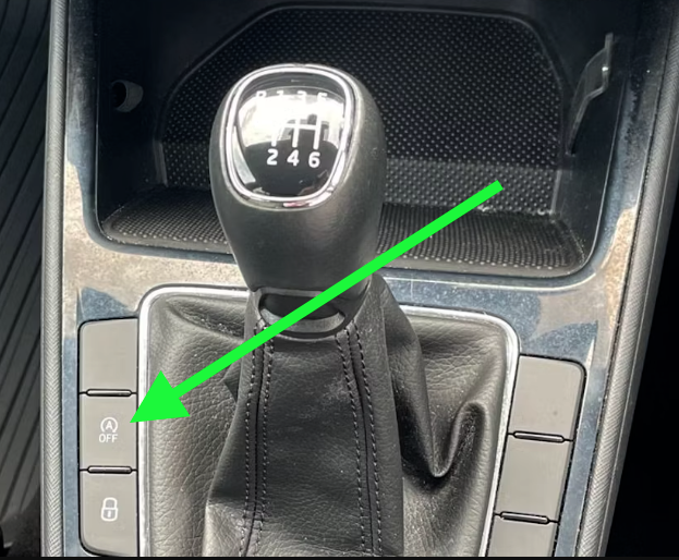

Start/stop next to handbrake?
Mines not there. It’s where a key would go. Right hand side of steering wheel 🤷🏼‍♀️
Sorry. Thought they would all be the same.
Next to the gearshift above the door lock button.
This image is taken from an advert is for a 2023 Fabia Colour Edition with manual transmission and I've green-arrowed the button that turns the car's START/STOP system OFF.

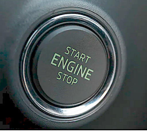

This is the standard position of the START/STOP button of a Fabia Mk4 with manual or automated transmission.
The purpose of the 'keyless start' button
on the right of the steering-column beneath the steering-wheel is to switch the car's ignition ON or OFF and start the car's engine.
