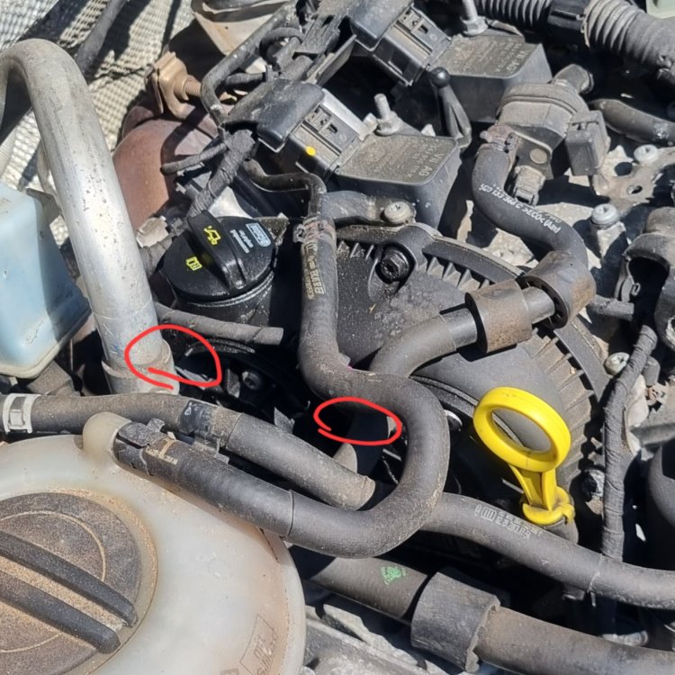

I've had a similar issue on and off for a while with mine, same year, but 160k on the clock.
It's possible you've got oil on the sensors for the cam angle on the intake and/or exhaust. One of them is right next to the oil cap.
Take the plugs off, and see if there's oil inside making a bad connection.
I've very inexpertly circled their location here! 20230603_150021.thumb.jpg.99288b693b7d439e8f06b07205801428.jpg
If you have access to vcds or obd11 etc, you can check what the sensors a reading
