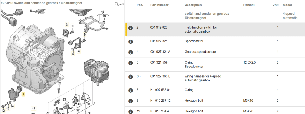

Circuit diagrams say it is wired with a yellow and a white wire from the automatic gearbox control unit J217. It is an automatic transmission car, right?
  • Sponsor
@Malume  I think you have confirmed automatic transmission by your more recent messages, so in this case I think the G68 sensor must be either item 3 or 4 on this page; whichever one has a yellow and a white wire going to it.
