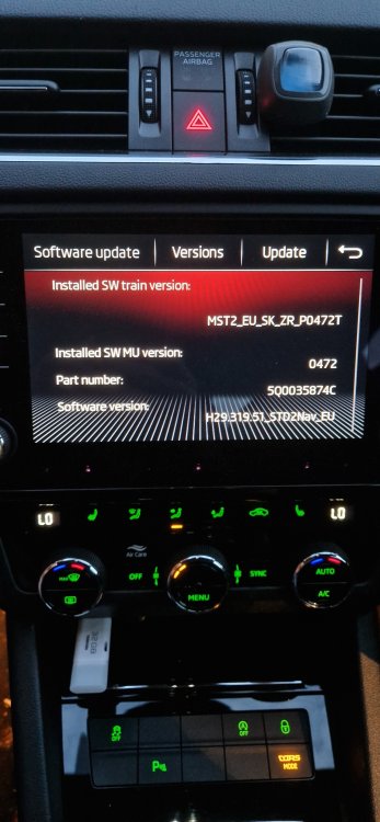

Might be an idea to get some images of what you have (system details)
You can also check the firmware of the system by holding your Menu/Setup button for 10 seconds, look for something called "Software Train"
It's an amundsen nav in a 2018 octavia vrs

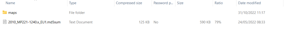

Still not getting mib files when extracting I'm just getting the discovermedia file then a map file within that then 2 more in that one
That folder called
D:\DiscoverMedia2_EU1_2110_V18 should not exist
I suspect you have the next folder as
D:\DiscoverMedia2_EU1_2110_V18\Maps
You need to move the folder MAPS to the root of the D: drive
So that it becomes 2 visible folders
and
D:\Maps
When you have it looking like that, you then can delete the folder
It should be empty if you moved the Maps folder

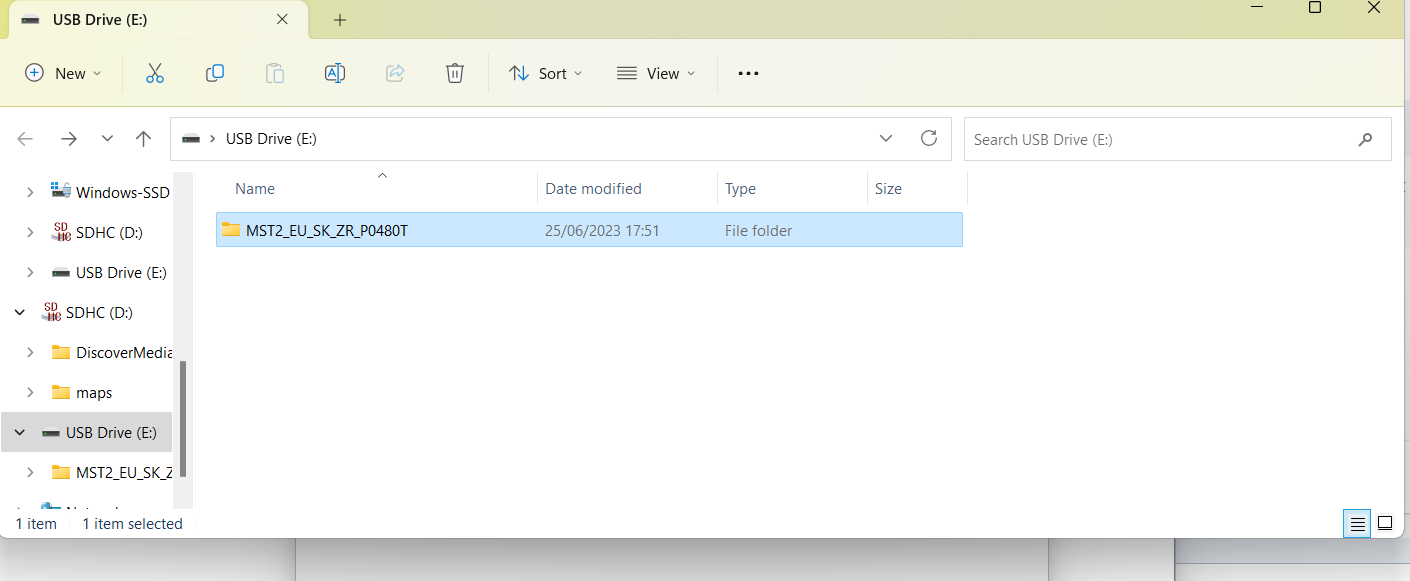

Yes it's a skoda sd card. Does that file look correct for the firmware update?
Good it's a Skoda card.
Firmware, same issue.
That folder MST2_EU_SK_ZR_P0480T shouldn't exist, so enter it, and select all the files and folders, and move down to the "root" of the SD Card
