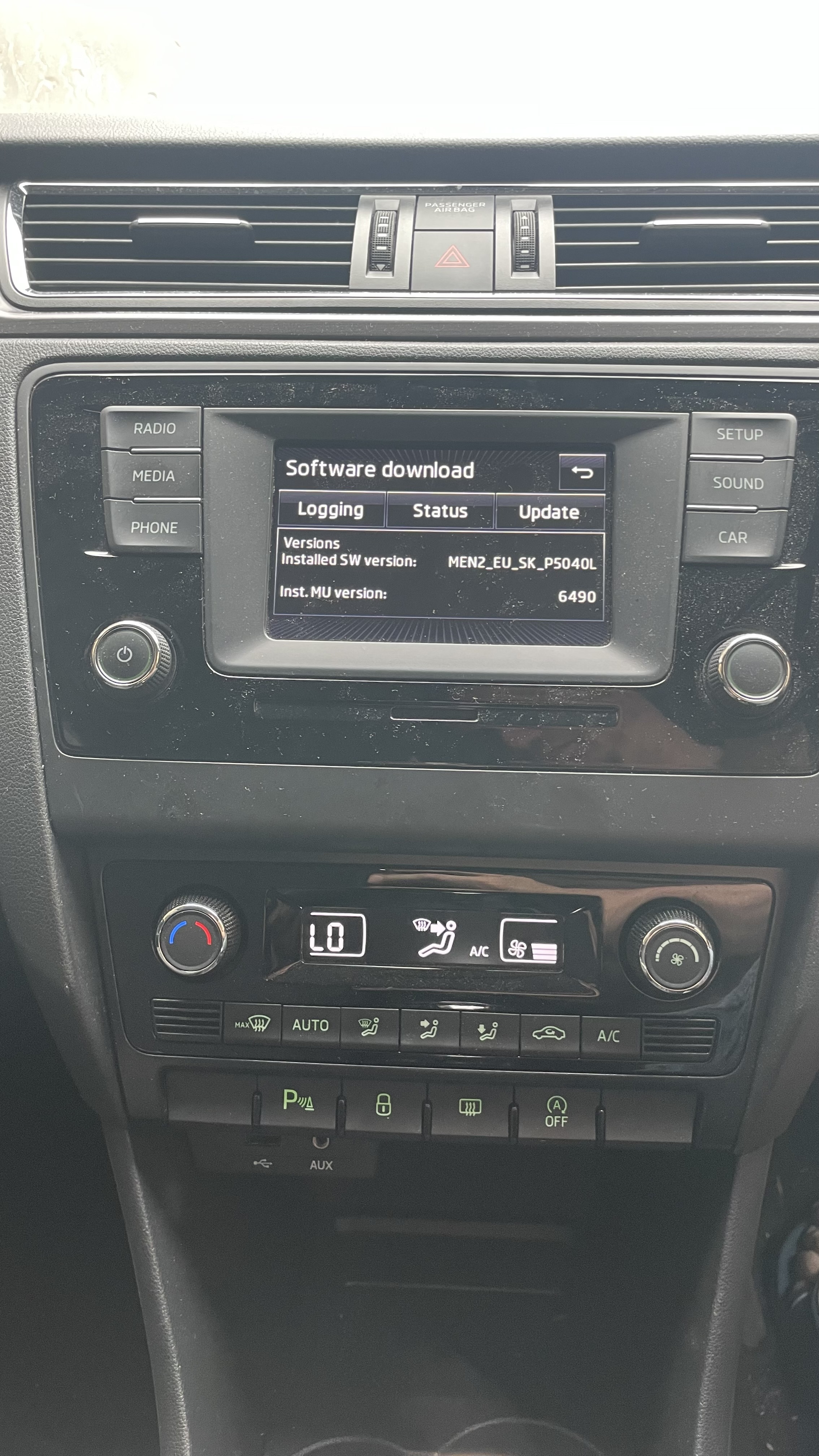

I've got a Skoda Rapid Se L Tdi manufactured in 2016. It has a Swing infotainment system (I think ..pls. see attached photo). The car is great, except the missing built in navigation system.

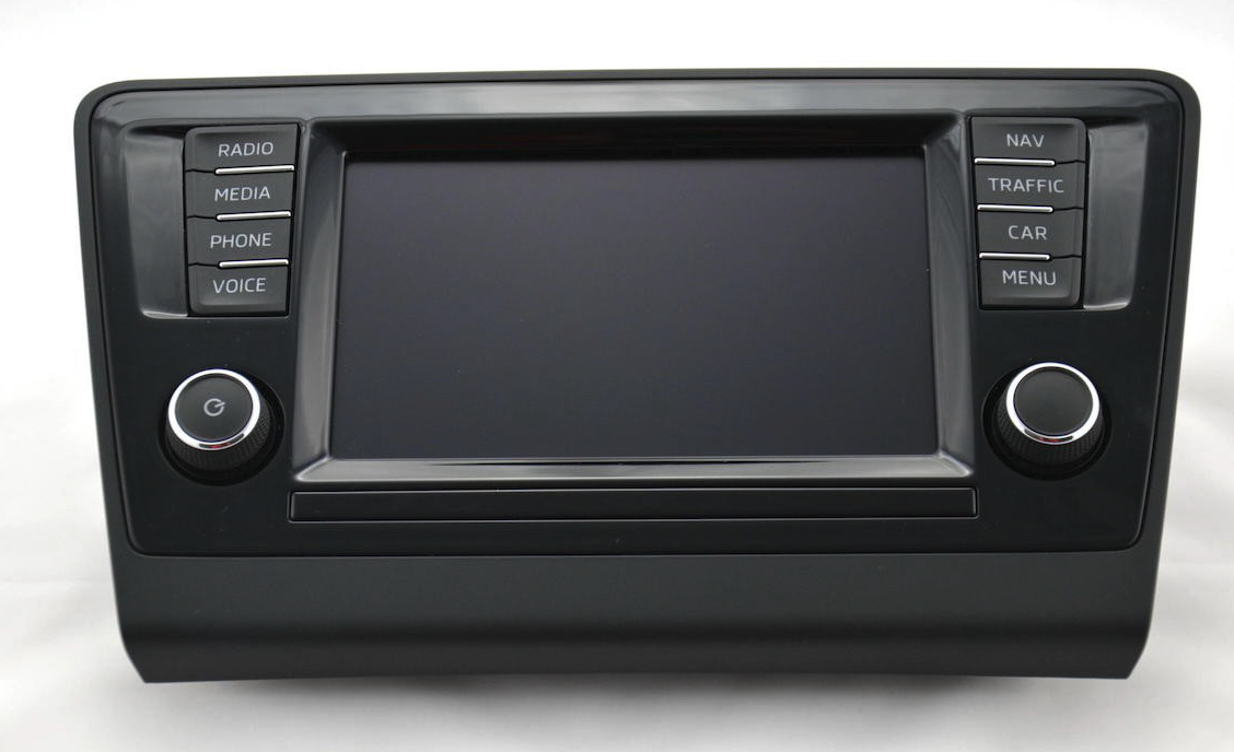

I forgot to add - I am quite confused by this weird item (should I call it FakeColumbusTM?) showing up all over the internet.
It is kind of similar visually to the RCD300 - a really old design language with cheap chrome embelishment.
And also CD player? I don't want/ need a CD player 🤷‍♂️.
THis seems to be a better designed Columbus matching my interior style (and fonts)
