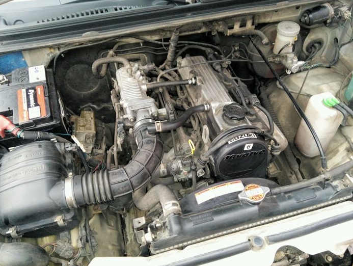

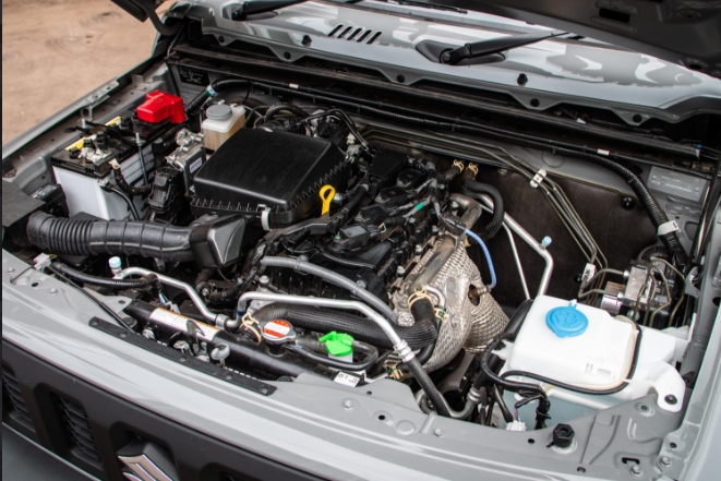

You get a radiator cap on Suzuki Jimny's 1999-2018 & with the newest generation 2018-2023.
On the radiator itself or on an expansion vessel?
@J.R.Clue is in the name. Radiator cap, just like there is one on my SX 4 and my Shogun.
Nothing to do with the reservoir / expansion tank and its lid.

OK, old school tried & tested atmospheric pressure overflow tank, the rad cap will have a small reverse flow valve built in, usually a small brass disc under the main pressure relief valve, they also have to have a rubber seal against the filler neck, any degradation in that and it wont draw back expelled coolant when the engine cools.
Pressurised expansion tank systems on most othr vehicles are intended to be "no loss" if working correctly, there must be a reason why proper 4x4's retain the 80's/90's system, perhaps related to wading?
