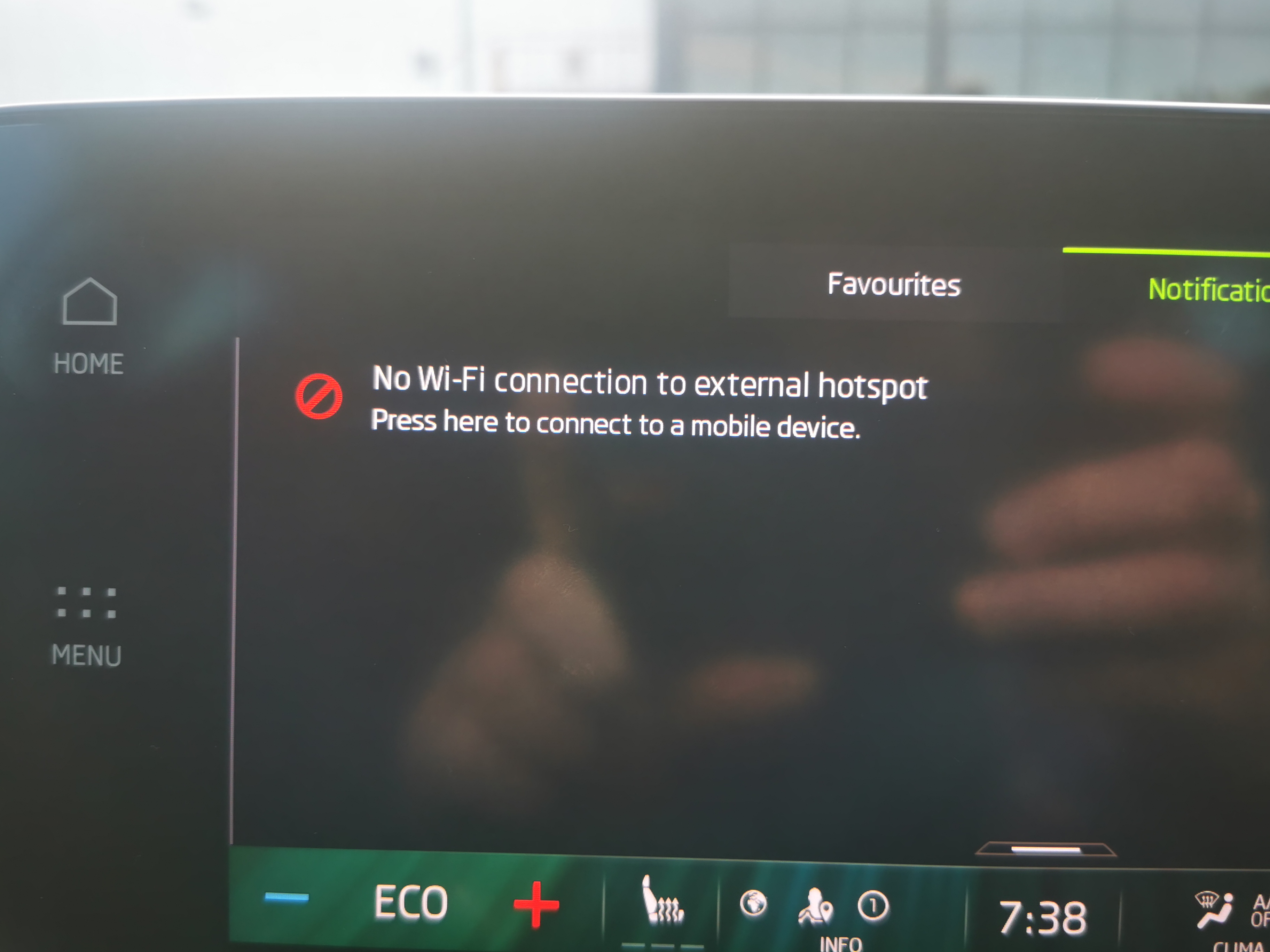

What does this screen mean

I think this means you have turned on Wi-Fi and the car is trying to connect to your phone to use the internet. Either that or you have turned off the E-sim which is the SIM card the card uses for the internet to do things like updates.
Connect a mobile device to the Infotainment hotspot
  • Turn on the Infotainment’s WLAN hotspot in the menu item media?lang=en_GB&key=imgc83b4ea2fec338450adf42c73e790ace_1_--_--_vw_Symbol_SVG_online_1x.svg media?lang=en_GB&key=img04ae441bfec36a6f0adf42c75b418f20_1_--_--_vw_Symbol_SVG_online_1x.svg media?lang=en_GB&key=imgbe0594762c5af0faac1445254e41e4b7_1_--_--_vw_Symbol_SVG_online_1x.svg media?lang=en_GB&key=img04ae441bfec36a6f0adf42c75b418f20_1_--_--_vw_Symbol_SVG_online_1x.svg Wi-Fi media?lang=en_GB&key=img04ae441bfec36a6f0adf42c75b418f20_1_--_--_vw_Symbol_SVG_online_1x.svgInfotainment system as hotspot media?lang=en_GB&key=img04ae441bfec36a6f0adf42c75b418f20_1_--_--_vw_Symbol_SVG_online_1x.svg Use as hotspot.
  • Turn on the Wi-Fi on the mobile device.
  • In the list of available Wi-Fi devices, look for Infotainment Wi-Fi.
    The name of the Infotainment is taken from the menu item media?lang=en_GB&key=imgc83b4ea2fec338450adf42c73e790ace_1_--_--_vw_Symbol_SVG_online_1x.svg media?lang=en_GB&key=img04ae441bfec36a6f0adf42c75b418f20_1_--_--_vw_Symbol_SVG_online_1x.svg media?lang=en_GB&key=imgbe0594762c5af0faac1445254e41e4b7_1_--_--_vw_Symbol_SVG_online_1x.svg media?lang=en_GB&key=img04ae441bfec36a6f0adf42c75b418f20_1_--_--_vw_Symbol_SVG_online_1x.svg Wi-Fi media?lang=en_GB&key=img04ae441bfec36a6f0adf42c75b418f20_1_--_--_vw_Symbol_SVG_online_1x.svgInfotainment system as hotspot media?lang=en_GB&key=img04ae441bfec36a6f0adf42c75b418f20_1_--_--_vw_Symbol_SVG_online_1x.svg Network name:.
  • Select the Infotainment hotspot and enter the required password.
    The password for connecting to the Infotainment hotspot is taken from the menu item media?lang=en_GB&key=imgc83b4ea2fec338450adf42c73e790ace_1_--_--_vw_Symbol_SVG_online_1x.svg media?lang=en_GB&key=img04ae441bfec36a6f0adf42c75b418f20_1_--_--_vw_Symbol_SVG_online_1x.svg media?lang=en_GB&key=imgbe0594762c5af0faac1445254e41e4b7_1_--_--_vw_Symbol_SVG_online_1x.svg media?lang=en_GB&key=img04ae441bfec36a6f0adf42c75b418f20_1_--_--_vw_Symbol_SVG_online_1x.svg Wi-Fi media?lang=en_GB&key=img04ae441bfec36a6f0adf42c75b418f20_1_--_--_vw_Symbol_SVG_online_1x.svg Infotainment system as hotspot media?lang=en_GB&key=img04ae441bfec36a6f0adf42c75b418f20_1_--_--_vw_Symbol_SVG_online_1x.svg Password:.
  • Confirm the connection.
Connect Infotainment to the mobile device hotspot
  • Turn on the Infotainment’s Wi-Fi unit in the menu item  media?lang=en_GB&key=imgc83b4ea2fec338450adf42c73e790ace_1_--_--_vw_Symbol_SVG_online_1x.svg media?lang=en_GB&key=img04ae441bfec36a6f0adf42c75b418f20_1_--_--_vw_Symbol_SVG_online_1x.svg media?lang=en_GB&key=imgbe0594762c5af0faac1445254e41e4b7_1_--_--_vw_Symbol_SVG_online_1x.svg media?lang=en_GB&key=img04ae441bfec36a6f0adf42c75b418f20_1_--_--_vw_Symbol_SVG_online_1x.svg Wi-Fi media?lang=en_GB&key=img04ae441bfec36a6f0adf42c75b418f20_1_--_--_vw_Symbol_SVG_online_1x.svg WLAN:media?lang=en_GB&key=img04ae441bfec36a6f0adf42c75b418f20_1_--_--_vw_Symbol_SVG_online_1x.svg Search for WLAN switch on
  • Select the desired hotspot in the list of available hotspots.
  • Enter the password for connecting to mobile devices.
media?lang=en_GB&key=ansi-s6_1x.svg
Infotainment stores passwords for previously connected hotspots.
