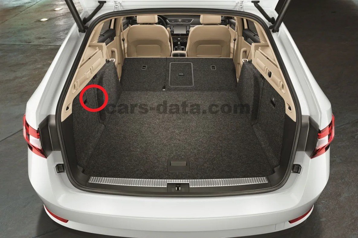

My problem was solved by swapping the control module for the tailgate. It's located on top of the left rear fender, but you'll have to remove quite a few panels to get to it. The part number was 5Q0959107J in my case, but you can check it with an OBD scanner ( I used OBD11).

Can you tell me please where is located the controle module to be able to read the code/PN?
Or if you have remembering also yours?

It located on the back side of the rear left fender and it's a pain to get to :) If you follow the instruction in the Superb repair manual, you need to take off about 4 or 5 trim pieces in the boot, the rear seat in order to get to the airbag on the side of backrest, I think the airbag too.
As to your previous question: For me it was swapping the module, for others - changing the struts (or repairing broken wires in the struts' wire bundles).
Edit: This was the part number of the replacement module, that I ordered: 5Q0959107J. I believe the original one was the same, but AFAIK you can buy a 5Q0959107 with another letter in the end and it should work. I was told they were different revisions of the same module. I could be wrong about that.

Thanks a lot for reply.
I have changed one strut which was having the wires broken, but still the problem is there.
So i do not have any other workaround for taking out the unit , just do the steps mentioned by you to be able to replace it?:-s
