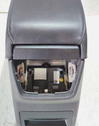

Looks like it has the same part number as the Mark 3 - albeit with an extra E.
If Part 28 pops off easily you should see the offending ratchet bits
image.png.3bc970b0b1e7327e0a2bb8cbafc3456e.pngBut it should be them sorting this, not you.

Nice! That's what I thought. He said well it's £350 for a new one and if it's not broken then Skoda won't replace it. Also so much for a "full strip down" of the interior!
