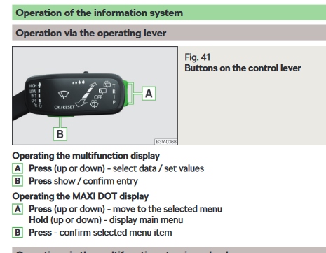

Mine doesn't have either the A or B buttons shown in that image.
I'm not familiar with Rapid spec but there are two likely scenarios:
- it's a base spec model without a multifunction display fitted so there are no buttons to control it
- the stalks or steering wheel have been incorrectly replaced by a previous owner for buttonless versions

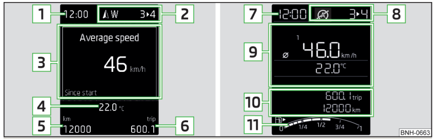

I assume your display matches that on the right:
You might be able to replace the stalks with the button variety but it'll likely need coding and possibly a new steering wheel controller.

The Rapids with the display on the right in the screenshot do have the buttons on the stalks to switch display modes. Was cruise control retrofitted in your Rapid?
Anyways, you can try disabling all display except for speed in the infotainment, perhaps it will switch over to it.
