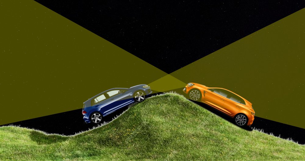

Scenario: You are driving in your car at night up an incline with your low-beams on, you are reaching the top of said incline (still driving uphill) and over the top of the horizon you see an oncoming vehicle. As your low-beams are still running parallel of the incline, your lights will illuminate (blind) this oncoming vehicle and vice versa as you are below their low beam cut off height.
I'm not annoyed that if happens because its just physics but I i'm just wondering why so little other motorists understand what is going on and then will flash you thinking you have your high-beams on.
This all came about when I was on a road yesterday with many inclines and I kept getting flashed by other motorist who most likely thought I had my high beams on.
I hope this makes sense and if it doesn't I've made a questionably tacky illustration bellow. As you can see both cars have their low beam on (top of the illumination is parallel to the incline the car is on.) and in this case both cars would be blinding each other.
Edited by WillRB

The diagram is incorrect because dipped beam lighting does not shine downwards to the extreme angle shown, well old school headlights never did, also the oncoming driver will be viewing the illumination from an angle and not head on which is much less dazzling.
Edited by J.R.
I totally agree with you and definitely the LED and Xenon's do no help at all.
Sorry about the diagram I know its not too accurate but I just didn't know how to explain it 😂
