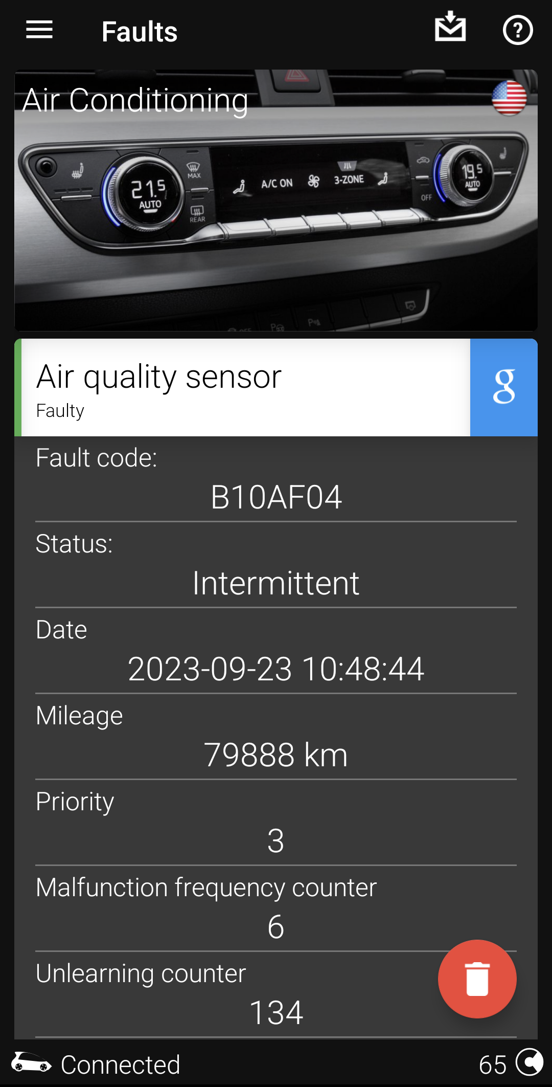

I've just scanned my MY2018 Mk3.
I've got a fault code on "08 Auto HVAC" Control Unit: B10AF [009] - Internal System Fault Confirmed.
Wiki Ross-tech states this is a common failure on VAG group vehicles which can be solved by replacing this sensor.
Does anyone know where this sensor is located?

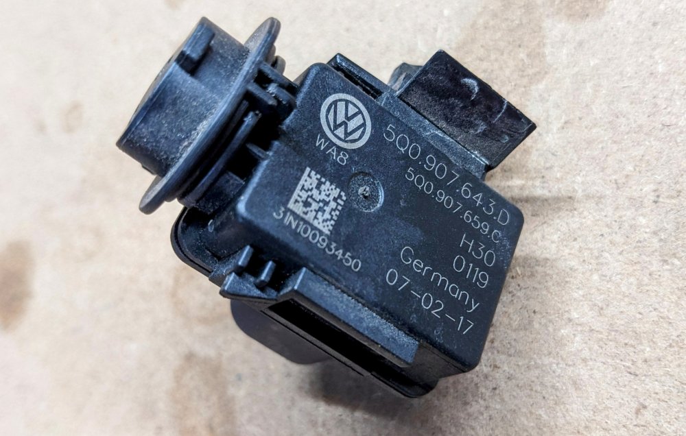

Common failure. It's located under the scuttle panel on the passenger side (I'd assume your driver's side).
There is a TPI for it, see if ur Skoda service center will replace it for u.
TPI - 2049398/3

I've been getting the same error too.
The part number I've got in Gandalf currently is 5Q0907643C.
I've ordered a replacement part 5Q0907643F.
Hopefully this fixes the problem.

Fortunately I've found this AQS for €65 to €80 on 2 other French spare parts websites.
I'll nevertheless have a look to mine before ordering, to be sure I buy the right one. I've just noticed indeed that Hella proposes 2 AQS (2 different Hella P/N) complying with the 5Q0 907643C OEM reference.
