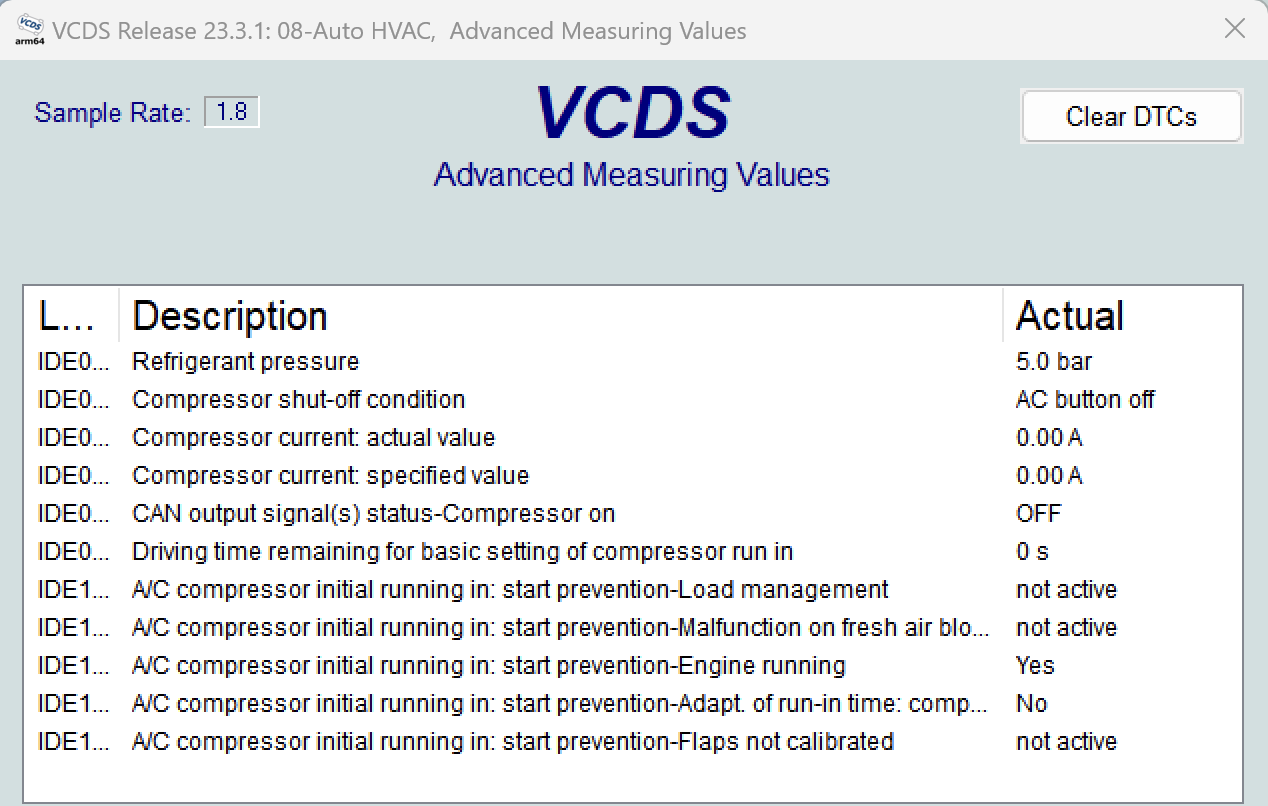

Hi everyone!
I've been playing around with VCDS and accidently messed up coding of Auto HVAC (08) module. Of course I did't have backup but I belive I've managed to rebuild it correctly based on what I found on the Internet. Unfortunately now I get an error that AC compressor didn't perform first run in and clearly it's not working. I tried performing procedures I found online (not exactly for Scala) but they didn't work. Setting up flaps works correctly but when I try to run compressor I get an error that pre requests are not fulfilled.
When inside module 08 in VCDS I also found some interesting measured values with names suggesting they can prevent me from performing compressor initial run but I don't know what exactly they mean. Does anyone know the procedure for Scala/Kamiq or have performed it before?
Thank you very much in advance.
  • 5 months later...
I've managed to fix this. Maybe this would help someone.
No matter what I tried I couldn't execute first adaptation but I could run compressor manually from tests module. I've started compressor test and reseted whole Auto HVAC module. After restart everything worked fine.
