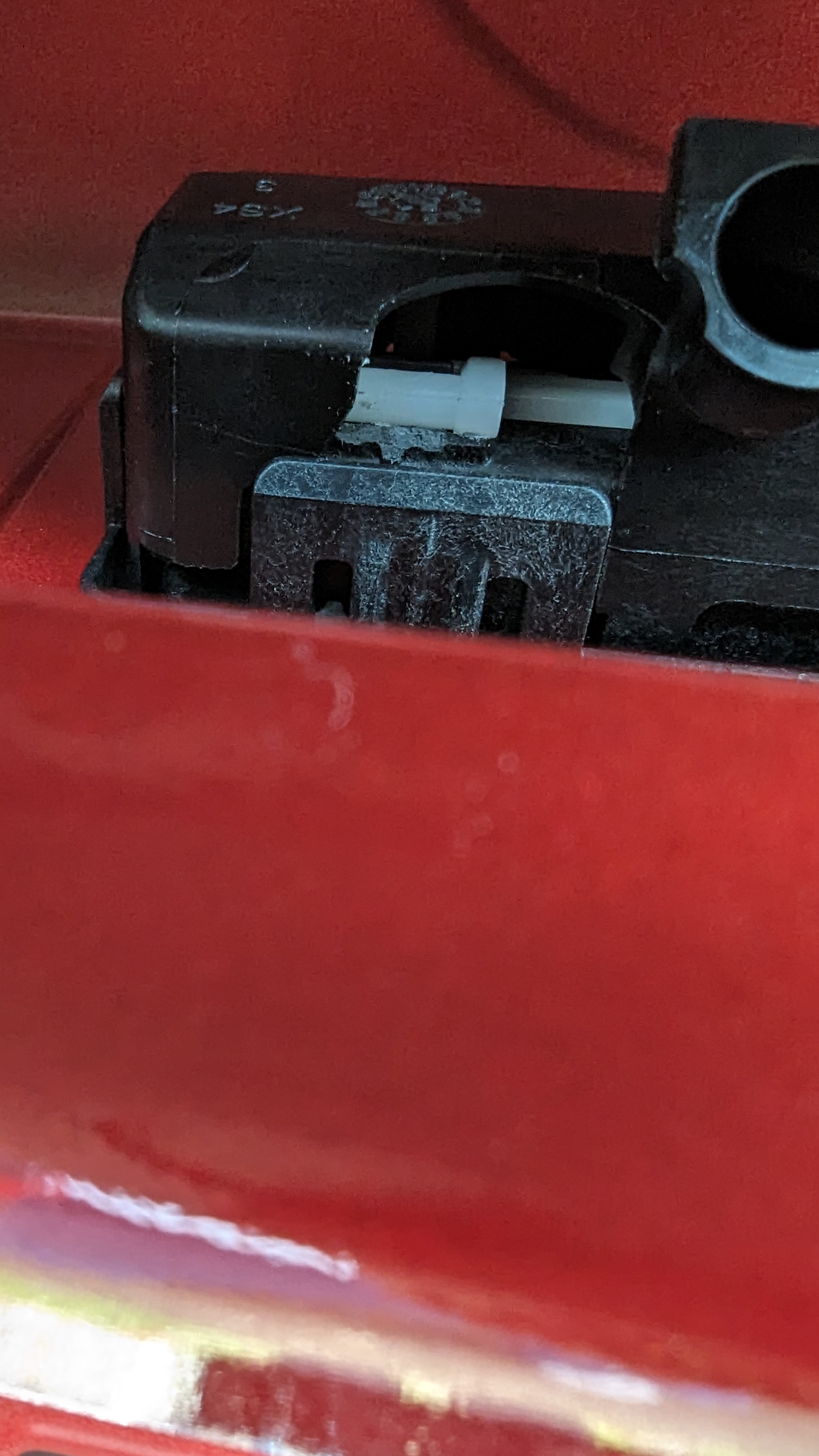

It looks to be the opening switch above the reg plate, just been messing with the connection and have managed to get it to unlock, but only by trying to unplug it. I'm assuming that's a different part to what you are selling
It appears to be a broken tab. If I push the white plastic forward, it works for a short period of time, 5 or 6 goes

Drop me a PM, i sell the complete units. Based on the picture you supplied the internals are twisting rather than pivoting.
The complete unit i sell will fix that :)
I may have bodged it with a screw cap. See how it performs otherwise I'll shout you
