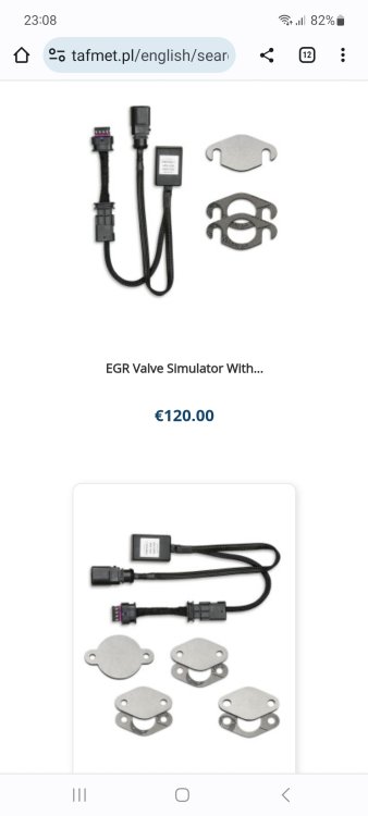

Is the attached screenshot the emulator you have fitted to your engine? Any idea what the difference between the two kits are? I'm guessing one is if the valve is defective and is stuck in a position and the other is if the valve is still operating correctly?
Sorry for pestering.
You need to get the correct item for your engine as the blanking plates may differ.
I did not use any of them but have kept them in case.
To the best of my memory if your EGR is functional and in the closed position it will remain there so you dont need to use the single blanking plate (higher up and easier to access) to stop gases flowing.
If the heat exchanger has failed and leaking exhaust then you need to use the pair of blanking plates to isolate the EGR, if there is a water leak the hoses need to be capped, I dont think that comes with the kit but read the listing as it should explain all.
