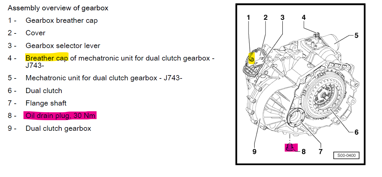

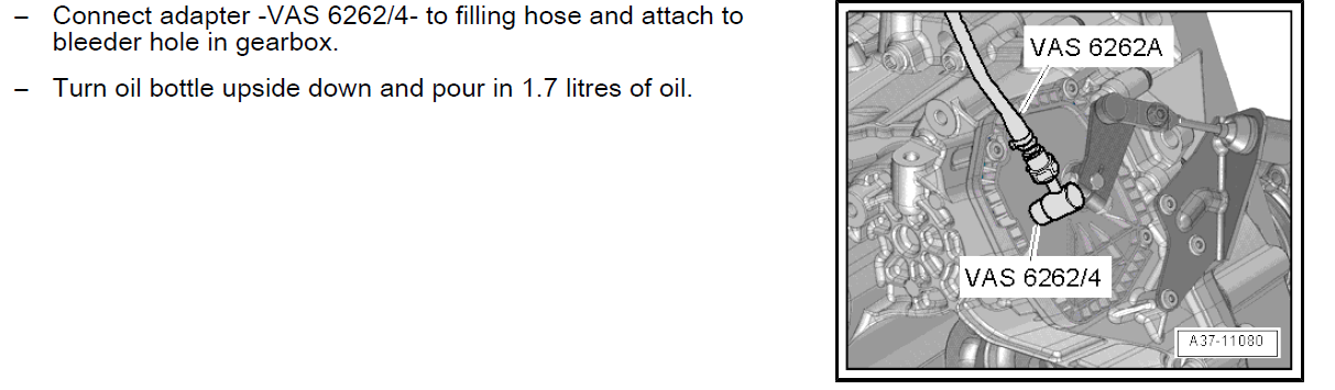

The mechatronic oil can be and should be changed.  Easily done every 60K km.  The recall does not apply to the OAM.  The breather cap (1) is easily accessible behind the battery (i highlighted the wrong one in the legend).

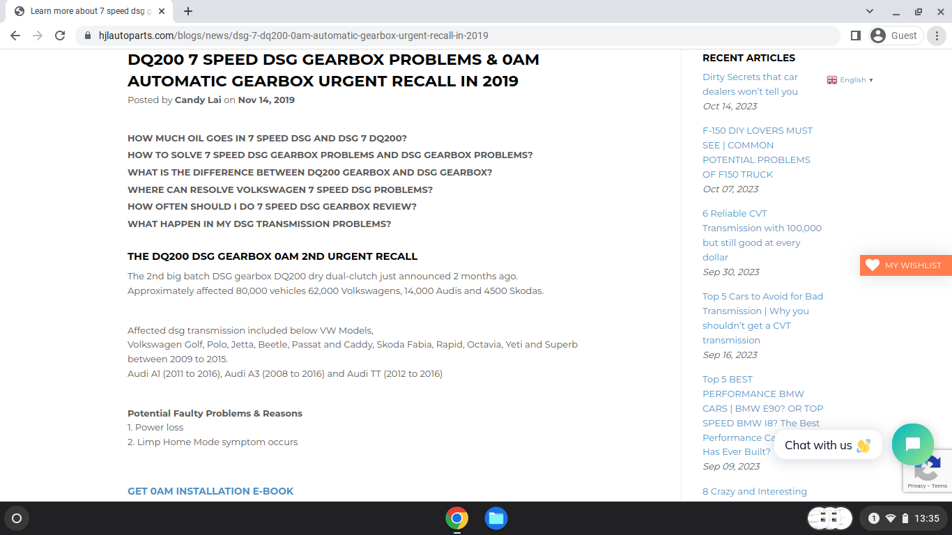

Leave the Oil in the MCU alone, and when you want change the oil in the Box.
This is service campaign '34H5' which in Europe was started in 2017 on DQ200,s from 2013 and 2015 and was just a Software Update.
Recalls 3 times now in Australia on these.
Edited by Rooted
Disagree, the oil comes out dark and dirty - 15 minutes of 1.7L oil, good insurance.  Mine has 185K km, not a single issue.  Your opinion is that it's lifetime fluid.  Like all 'lifetime' fluids, thats not good advice.  The recall is valid but not for everywhere and totally depends on where you live https://www.autocar.co.uk/car-news/new-cars/vw-uk-why-we-dont-need-dsg-recall  Despite your website link, there have been no recalls for this in my country, nor have I had a single issue.

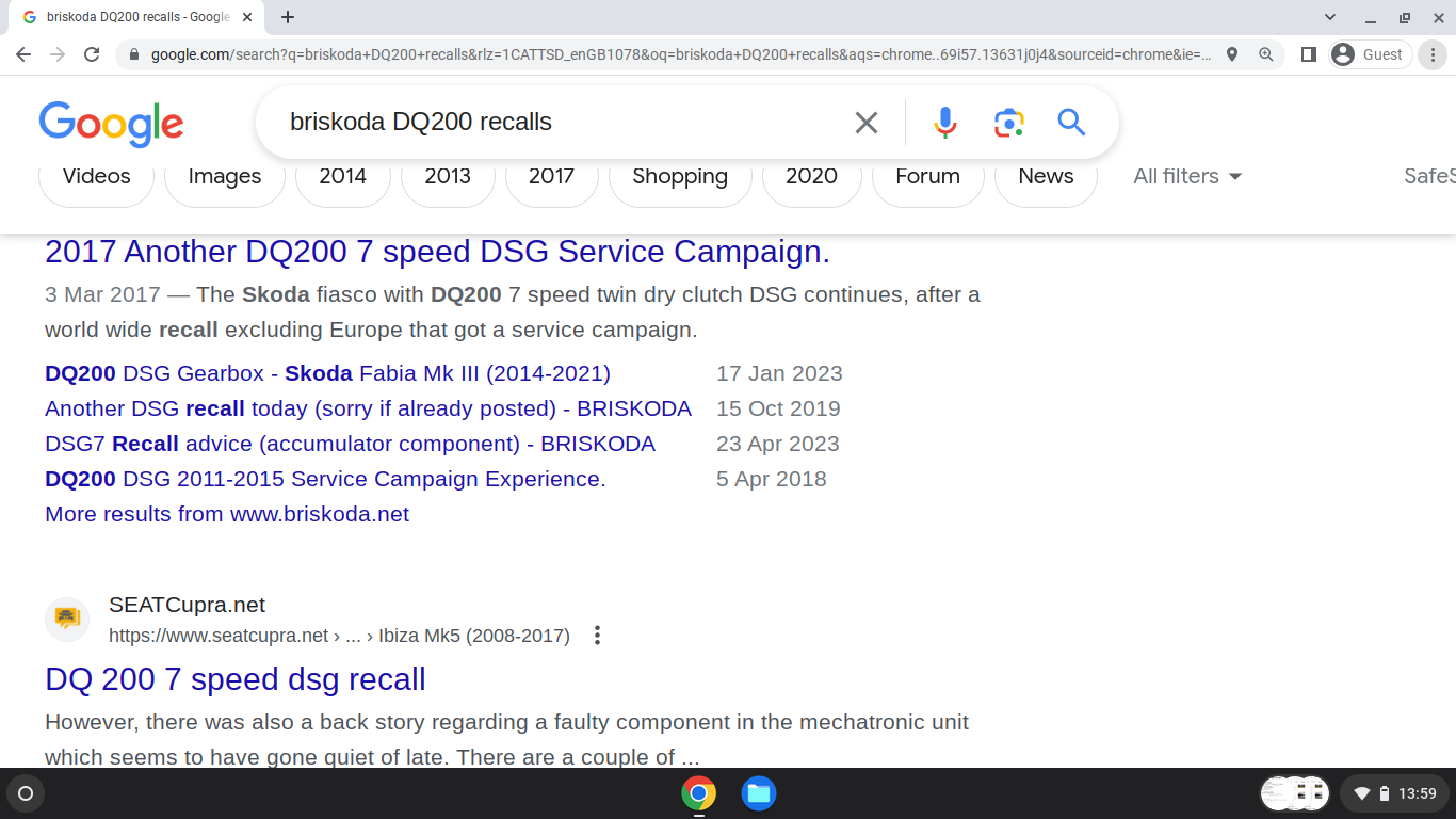

'34F7'  as i posted to start with.    2009-2012.    Then '34H5' on 2013 after the factory oil changed, to 2015 preventative.
Google search just to show not even half the threads for the past decade of which i participated, because of the knowledge on what happened within VW Group.

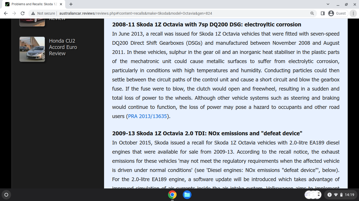

Doesnt affect Octavia... try again https://www.vehiclerecalls.gov.au/recalls/rec-003548  Again, there are multiple OAM gearboxes.  Not all the same.

I posted there are now 3 recalls in total Australia on the models.
All in New Zealand got new MCU,s in 2012.        You seem to pick some random km for the DSG and for your 1.4 TSI Oil changes yet not say which country you are in.
Edited by Rooted
What are you on about?   You still haven't provided ANY requirement for the issue you're claiming.  All of the citations you've provided EXCLUDED Europe and that's where the OP is.  My advice is based on 30 years working on VAG vehicles,  a professional aircraft mechanic and direct experience with the vehicle in question.  Please provide the recalls for Australia.  Exact numbers please.  Otherwise it is just nonsense.  Also, the oil I replace the mechatronic oil with, the root cause of you coniptions, is mineral based, as per the part number updated.  So your worries are really strange.   Provide some citations beyond forum posts please.

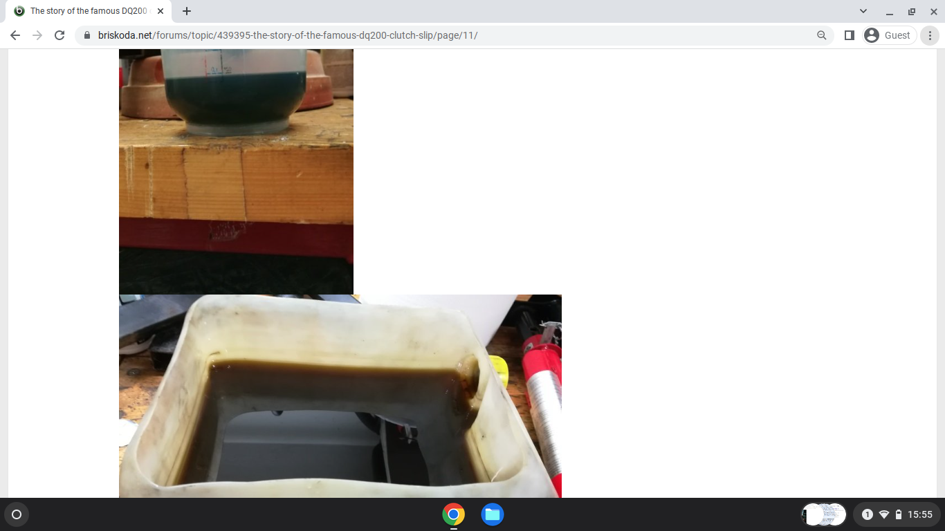

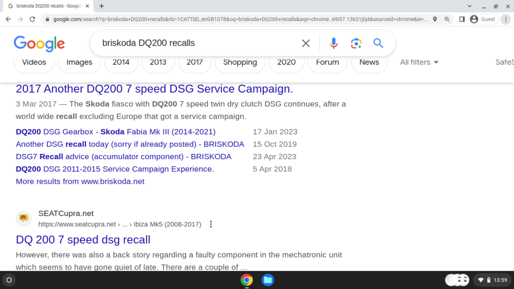

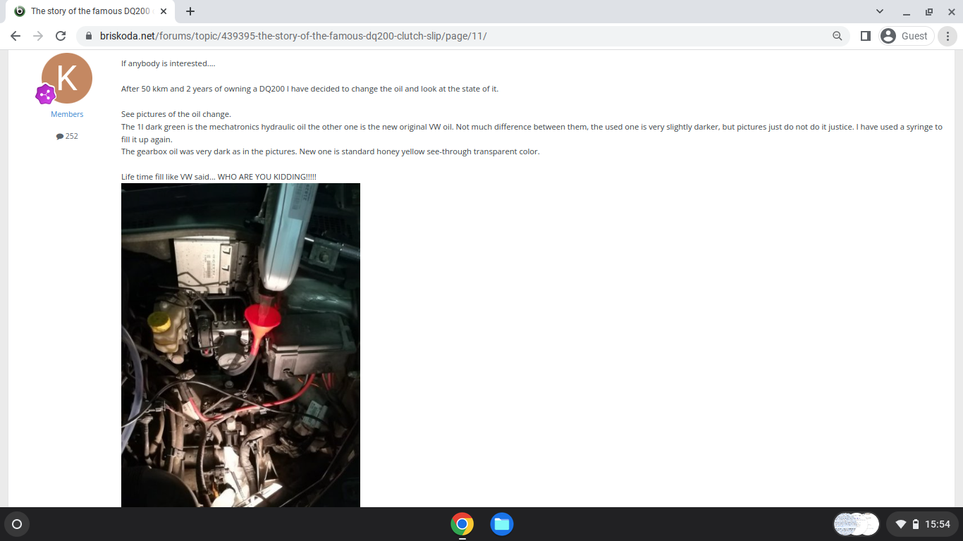

http://briskoda.net/forums/topic/439395-the-story-of-the-famous-dq200-clutch-slip/page/11
Edited by Rooted
