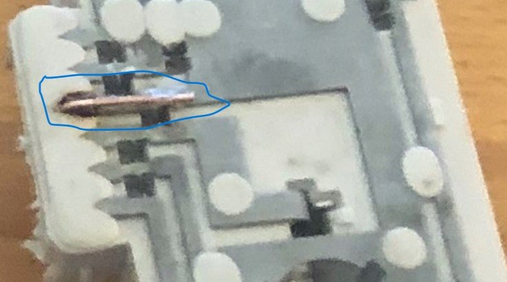

  1. I had the exact same issue. Notice the brown corrosion on the earth pin? Thats you issue. I fixed it like this:
