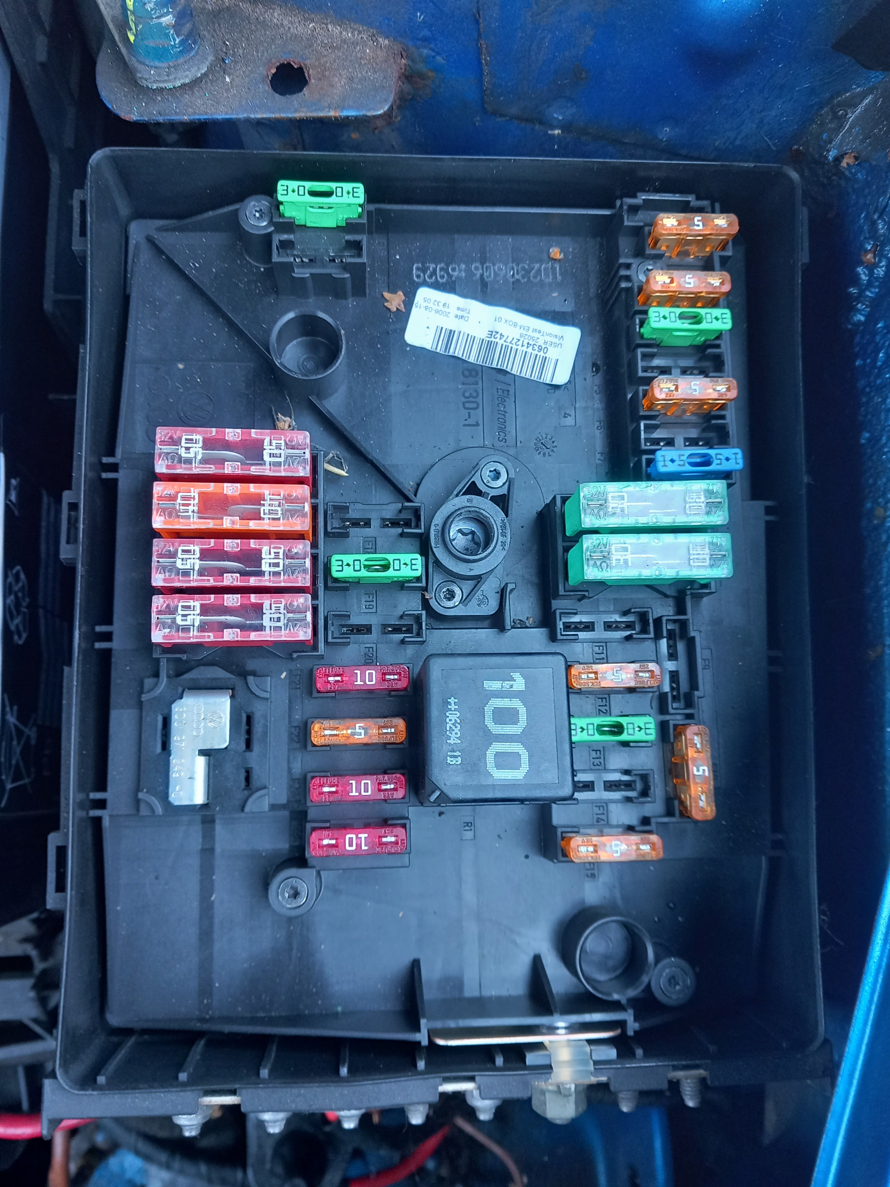

Got back home and removed the battery. Charged it overnight and put back in. Turned the key, still no crank. Checked engine bay fuses, all ok (but can't find one related to the starter anyway). I can hear a click from the engine bay but think this is a relay and not the solenoid.

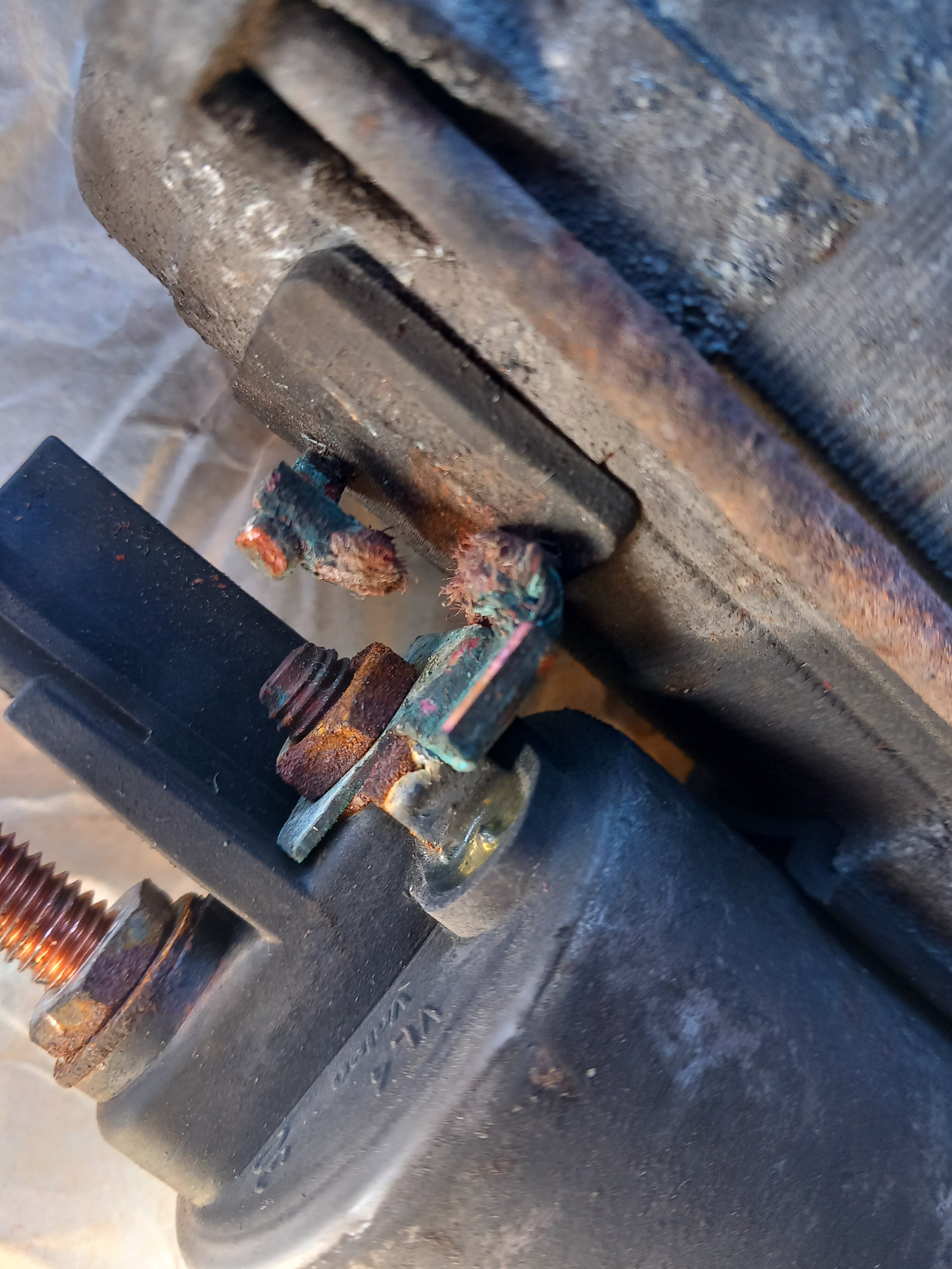

You need to connect the heavy positive cable to the terminal on the right in the photo and then connect 12V to the solenoid winding terminal, this will throw the pinion out and connect the two large terminals to power the motor.
I can see from your photo exactly what your problem is though, corrosion on the left hand terminal, you need to remove the nut and the tab on then end of the braided wire, clean up all the mating faces to bright metal and reassemble it, it should work fine then.
Test it as above.

When you say the solenoid winding terminal, do you just mean the terminal on the left in the picture? If so, I have already fed 12V to this terminal (whilst starter fitted, so Positive on the terminal in the right and body to ground) and it only spins the motor on the new unit.

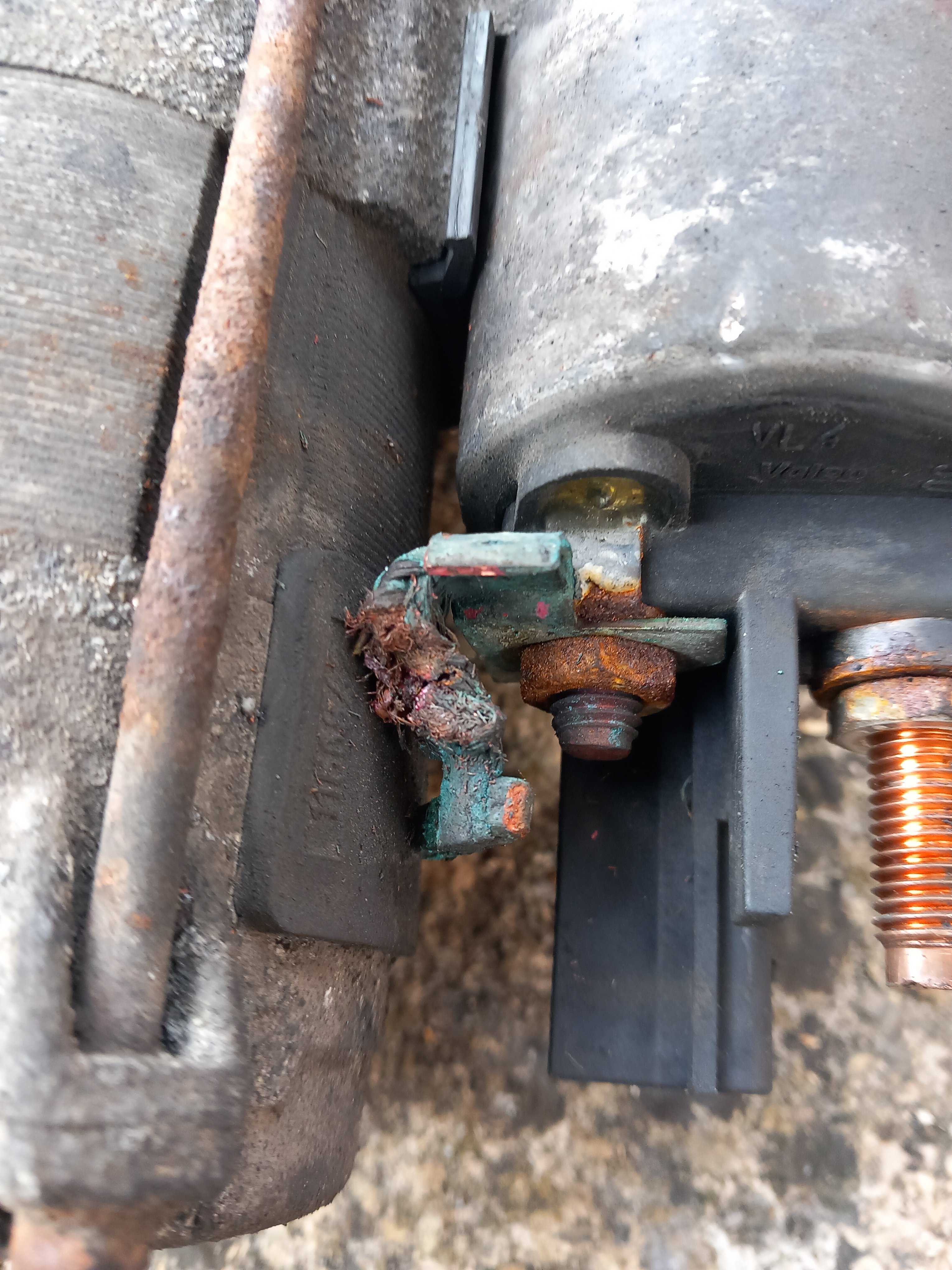

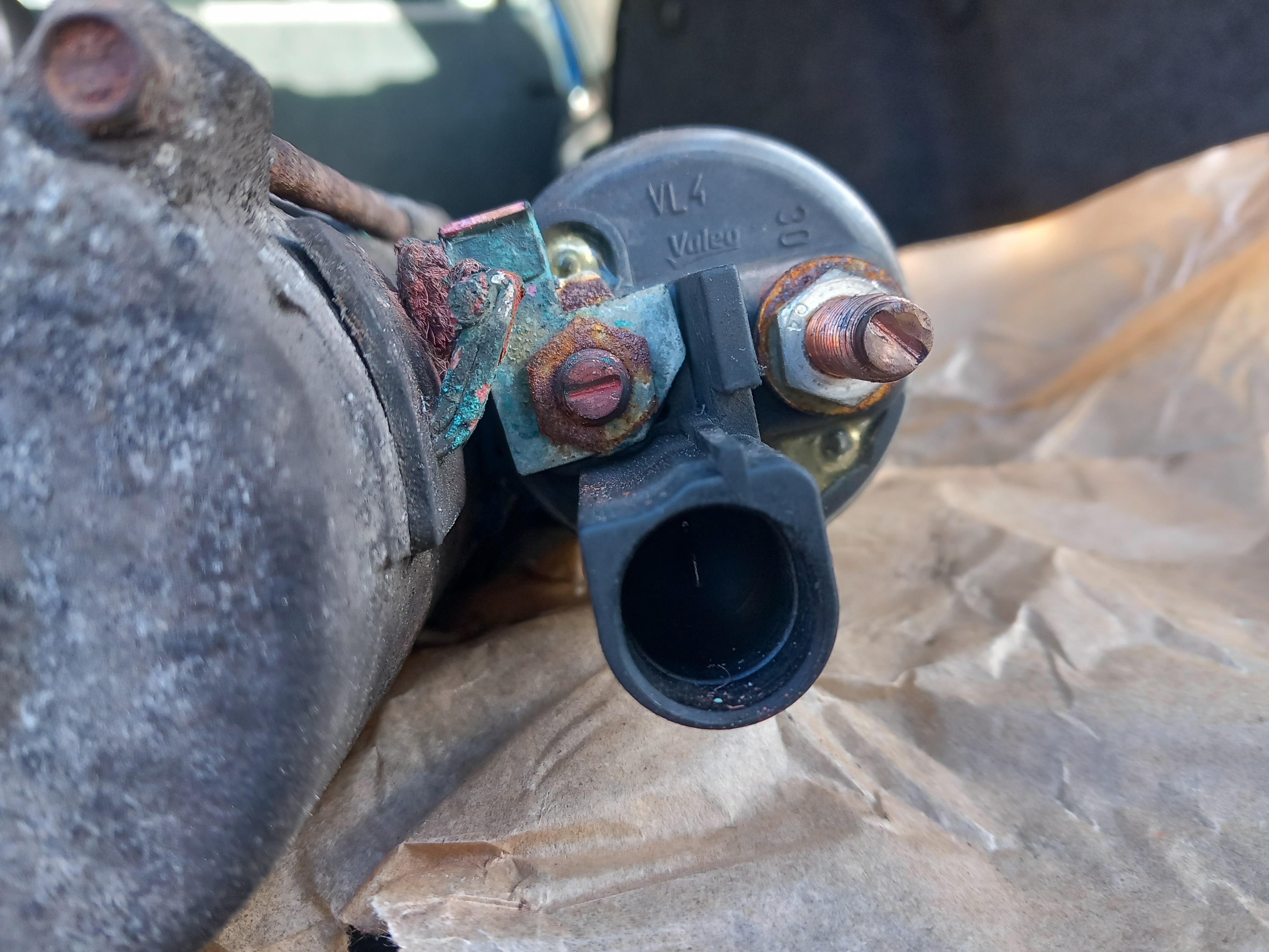

1st pic, braided cable perished to dust.
2nd pic to show 2 terminals + connector plug

Always go with your instinct! I had the new starter in and tried to crank but still no start. When I had both starters off the vehicle I bench tested them. I didn't put 12V to the connector plug. Just bridged to the other large terminal and it only span the motor. I thought this might have been a new faulty unit not realising that the solenoid is only going to work if you connect a feed to the connector plug. Seems obvious I know to some.
Anyway, with both the starters off I at least inspected both to ensure they were the same and curiosity made me think the pin inside the new starter was further inside the plug housing than the old unit but proceeded to fit it anyway. FItted and still no crank.
I wasn't sure the plug was making contact with the new starter pin so this morning I made a short cable to go between pin and plug. Had multimeter on to check voltage when turning key and boom, fired up perfectly.
The new starter plug pin was infact further inside the plug housing and not making contact with the old wiring loom connector plug. So a slight modification to the loom plug and everything is fine once again!
