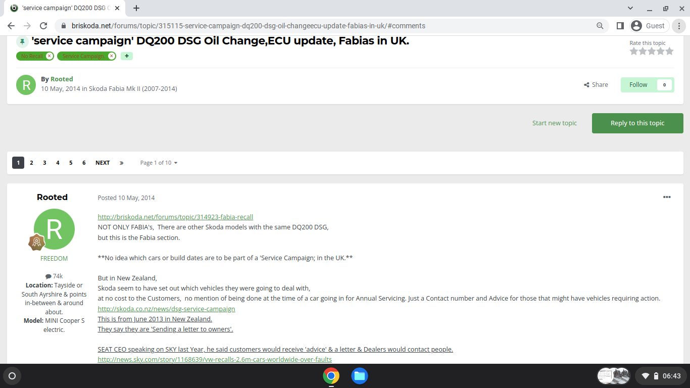

(Not relevant, but It might have had the Recall Action since 2014 that was an Oil Chang from Synthetic Oil to mineral & a software update.
that was '34F7' on 2009-2012 DQ200's bit just to ones built before the summer shut down.)
Sticker in the Spare Tyre well if done.

You are right the World Wide / Global recall did not apply to Europe / EU,  but then VW Group had to start a Service Campaign in the UK in02014 on the 2009-2012 DQ200,s because they are little cheats and thought they could get away with things.
(Europe can have exactly the same climatic conditions as New Zealand had and the DQ200,s were built in Europe not just in China.
In China and other regions they had to put a 10 year / 100,000 mile warranty on them.)
The 2012 cars late 2012 were not part of 34F7 the first Workshop action, or 34H5 on the 2013 to 2015 DQ200,s, just a service campaign.
But that was and is an issue because many of those had premature failures.
In Australia there are 3 recalls covering the DQ200,s from 2009-2016.
The 3rd one because so many were missed in the first 2 Recalls that is an issue when Australia had the Lemon Laws,
