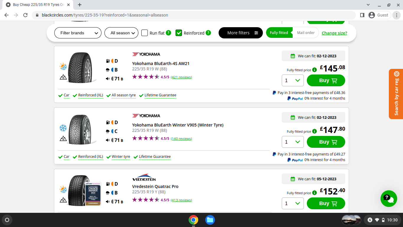

All season tyres to fit 19 inch Xtreme wheels on VRS?
Anybody know of a decent all season for these wheels? I had wheelspin in 4th gear last night and I wasn't even trying!
The size is 225/35 r19
Ideally after something premium like Cross Climate 2, Bridgestone Weather Control, Hankook Kinergy 4S2, Goodyear Vector 4Seasons Gen 3
Have searched on many sites and only finding cheap chinese tyres.

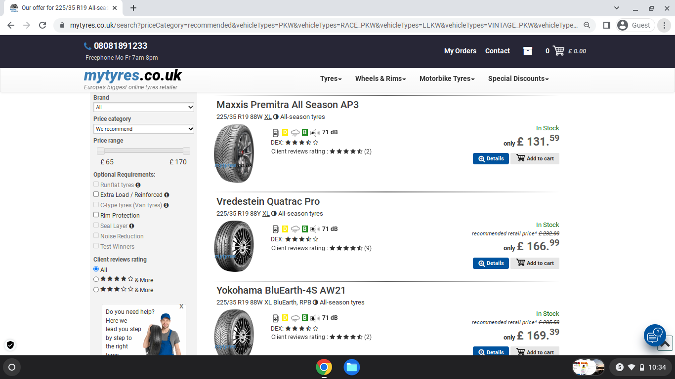

Thanks mate, I'm in Essex SS13 postcode.
I'd seen the BluEarth before but they review badly. Must admit I also ignored the Quatrac Pro as had bad experience with Vreds previously. According to Tyre Reviews they're actually not too bad so that could be an option...

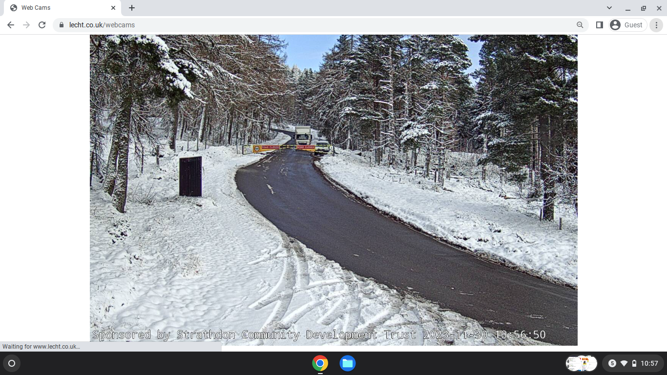

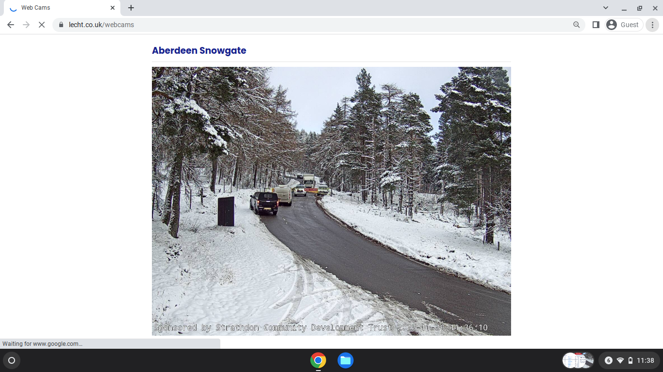

The Ski Centre roads are ploughed and gritted / salted obviously and open to traffic with many arriving with vehicles with nothing special in the way of tyres.
To the general public including delivery lorries, vans etc that get no winter tyres fitted.
Can be hairy right enough with those without a clue and that think because they get up they can get down and no need to slow down or go with the flow.

Absolute tosh. They try to keep the roads clear but often they are not and if snow is falling the roads will be white. People get caught out every year on the roads up to Glenshee or Lecht.
Personal photo end of December last year - not particularly clear roads and Cross Climate 2s worked fine.
