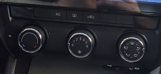

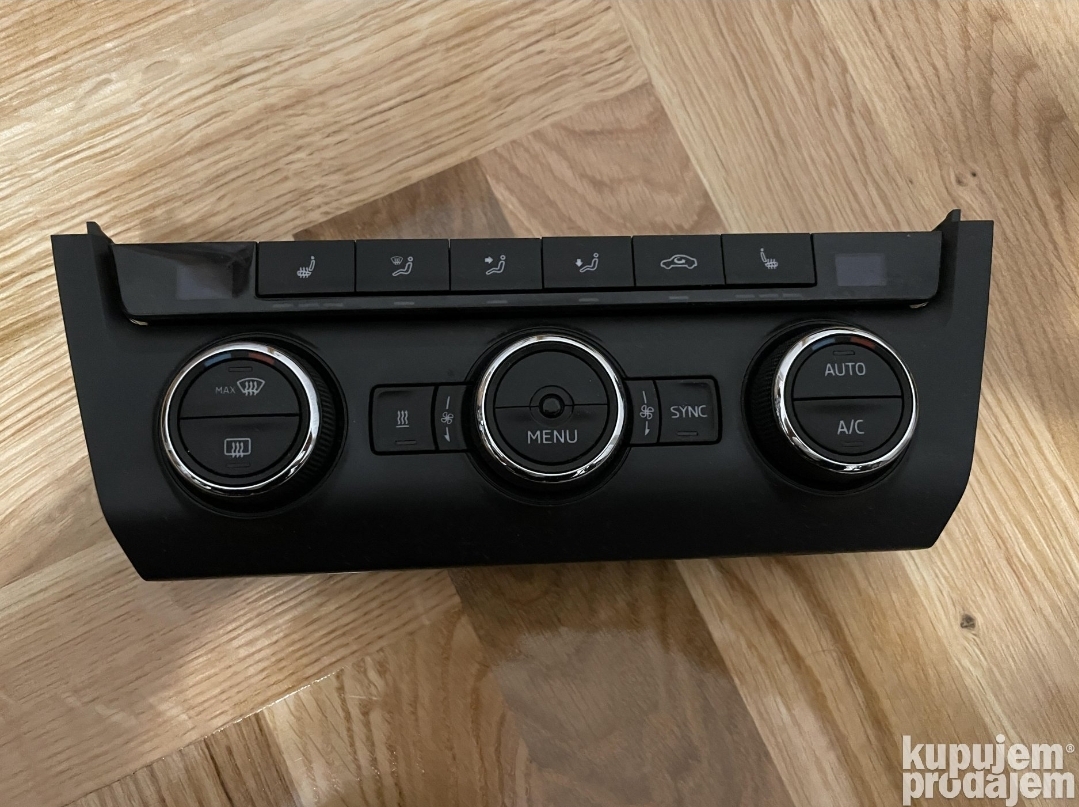

Hello. I have 2016 model, with maual ac unit.
Can i change unit to climatronic, just like plug and play?
From this
To this
Plung and play, or it cant fit withot wiring...
Thanks
No, for it to work correctly you need to completely replace the heater box and wiring.
Your car has single zone climate, the climatronic has dual zone, even with a adapter harness that people fit instead of doing the job properly, the second zone wouldn’t work and your car would be left with fault codes
On 07/12/2023 at 18:07, wirer said:
Such a pointless retrofit if you’re only going to half do it.
You have lots of fault codes left over and a passenger temperature control that does nothing.
the worst part is, he removed most of the dashboard to run some wires, well at that point you may as well change the heater box and loom for the full climatronic version as you’re over half way there
