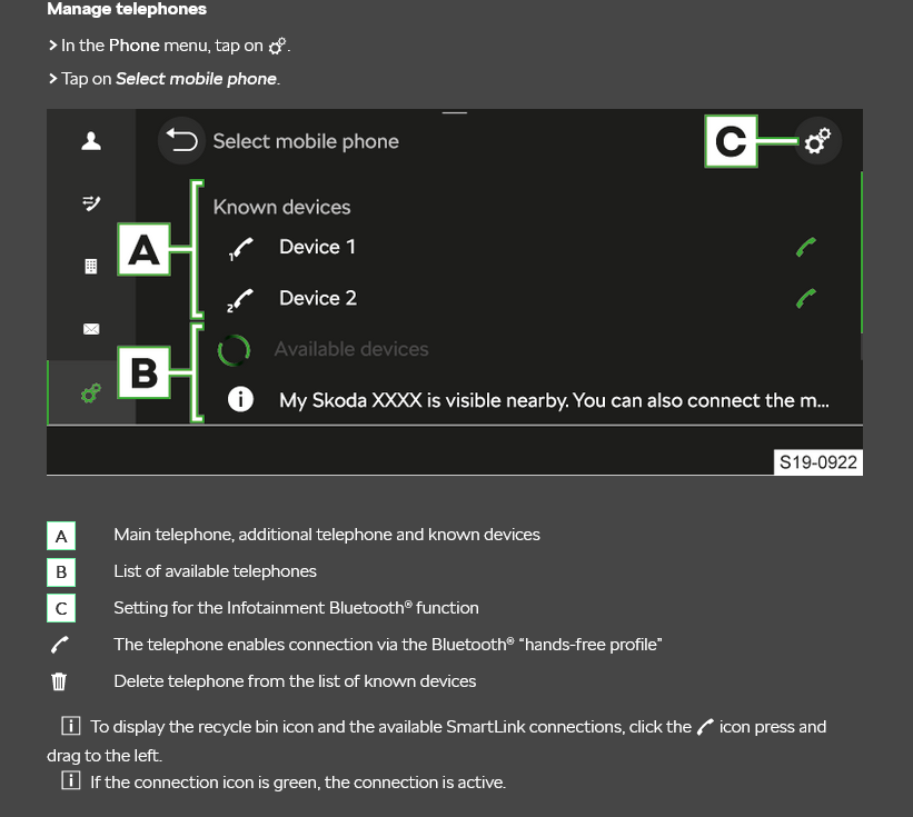

Is your phone device 1 in the list?

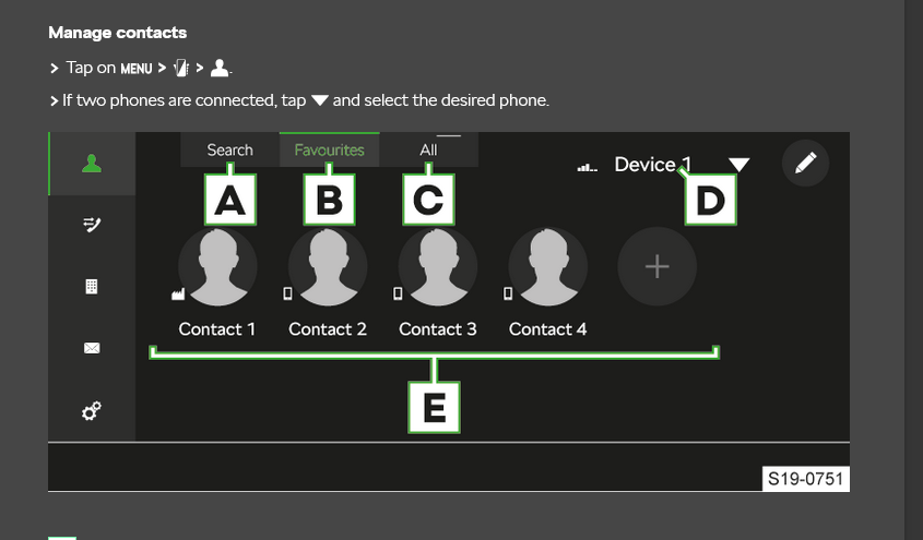

Yes, I can manually select my phone on the drop down if the car has selected hers.  However that only selects mine for calls.  Hers is still connected to android auto for maps. Spotify etc.  I can't stop that.  On my own, mine connects fine to android auto etc, it's just that hers overrides this when we are both in the car.

So yours is the first in the list?
Not sure (she's not here at the mo) but I think hers is first in the list when both are connected.

That is my thinking.
Device one could be the phone the car looks for first, carrying on if not present to device 2.

The car should have a list of telephones in it's memory, the one rememberedd as device one is always the main telephone.
1462727580_Screenshot2023-12-11at20-15-53Skoda.png.4658cd68052c053feb73d8ff57a31de4.png

I will see if I can change the settings so my phone is first in the list. Thanks for your help 🙂
