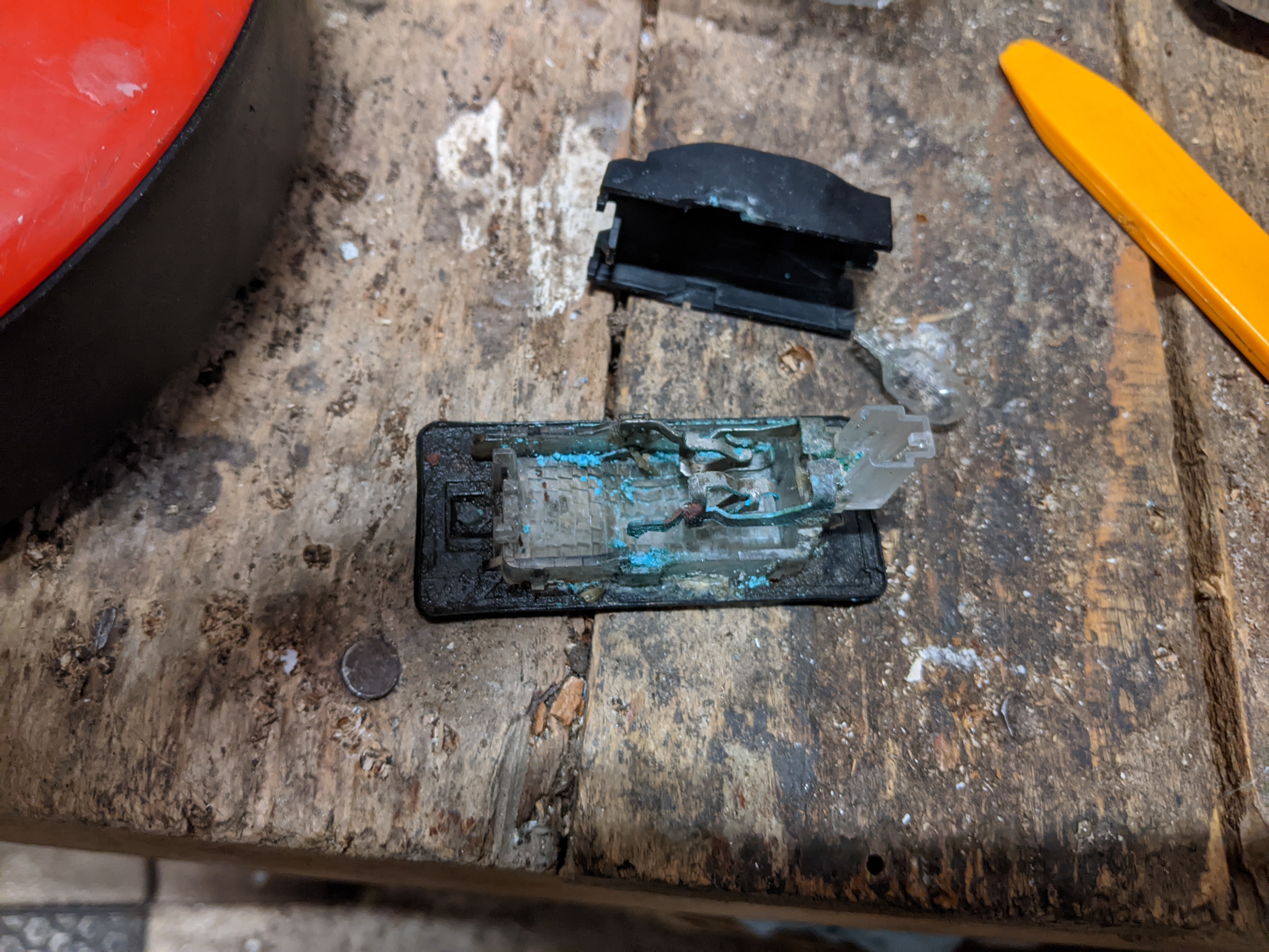

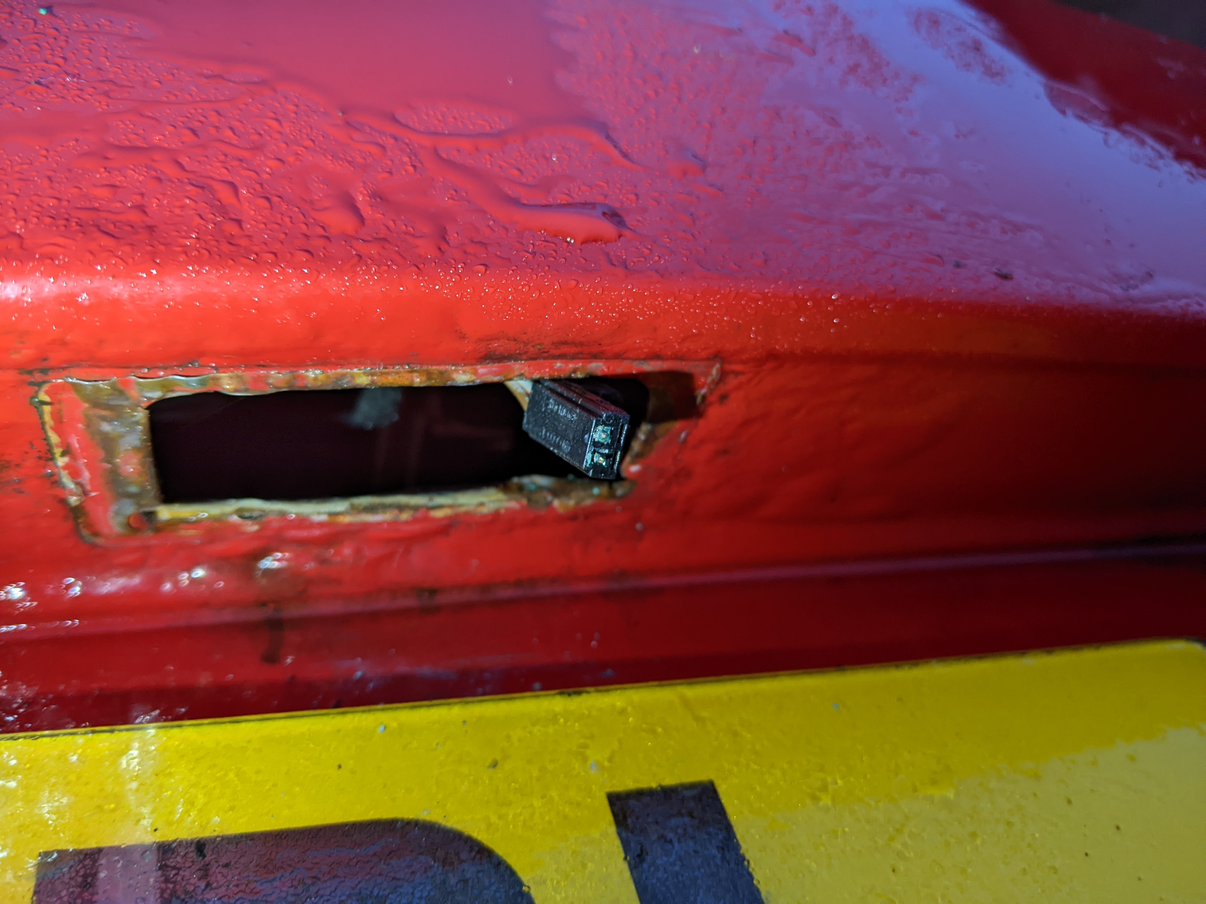

Hi,  On a 2015 Fabia 1.4TDI Hatch one of the number plate bulb holders (RHS) is badly corroded and the body work that the holder fits into is rusting with the paint blistering.  The other bulb holder and body work (LHS) are fine.  Also the bulb holder was so badly corroded that in removing the electrical connector the metal parts of the holder broke leaving part of the bulb holder contact pins in the connector.  See below.

The bulb holders is held in by a spring clip which had disappeared on the corroded side so I think the seal between the holder and the body was not very good so letting water in.  I now have to remove a contact pin from the connector.  I managed to get one broken pin out with a pliers but the other is flush with the surface and I couldn't pull it out with the pliers.  So any thoughts on how I might be able to remove it or could I just push it further in?  Also are replacement electrical connectors available?

On blowing your photo up it looks the connector might be held together by a very small torx screw but there are also slots under the connector pins that might (or might not) be some sort of release or removal of the pins or sockets - but I don't know and all would be too small for my eyes in real life.  Bear in mind removing the connector block will have a live pin/wire terminal when the lights are on and usual precautions with car electrics.
You might be able to clean and reuse part or all of the connector and get new pins, or get a new connector the same/similar-enough, or If you're not too worried about originality and there the rom to do so you might be able to change to another type of connector

Yes, I am planning to coat the male and female part of the connector with vaseline. Unless there's something better? Also it looked very likely water was leaking in between the bulb holder and the car body possibly caused by the missing spring clip. Considering using sealant between these surfaces to ensure it is water tight?
The photo below shows water damaged bulb holder.

I had to take off the tailgate trim to do the wiring.  Everything looked Ok; there was no staining or indication of water ingress.  As I mentioned the spring clip on the corroded bulb holder was missing and the paintwork around the bulb holder also showed corrosion so possibly the water had got in between the bulb holder and the tailgate.  The other bulb holder was fine.
