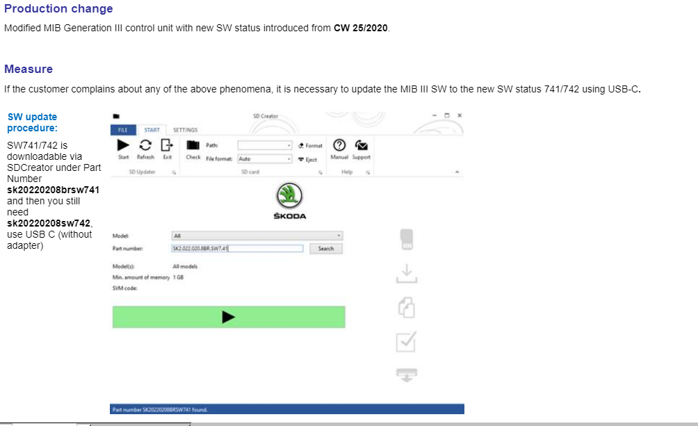

for SW469 , you need to update tu SW741  AND SW742 , because 741 is an incomplete SW
Edited by andreiro221
also, Skoda does not have a higher SW version for your MIB, other than 742
they changed the MIB HW and part number starting with mid 2020

because your HW does not know SW 17xx\ 18xx
Is there a possibility to downgrade to 0742?
you have to try to update first to sw741 AND then to SW742

please post the SW741 and 742 that you have
i want to see if they are correct.
